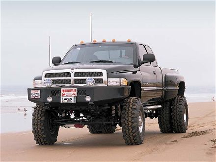

why will the newer dodge (+94) work?
jps4jeep said the newer d60 wont work. just wondering why not? is it just because they switched to coils?
won't work with a chevy t-case, diff is on the wrong side.
also the coil bucket is cast into the diff housing meaning you will have to run a HUGE perch to clear it with leafs or outboard the springs a good disance.
Plus they are semi float axles with puny joints and problem-matic wheel bearings.
Not the best pic, but it was the first that came up, yo ucan see the drivers side diff, also you might be able to see the coils semi on the diff.. Very similar to how the leaf pad is on all other D60
ok well then the axle i thought was a good sounds like alot of work
