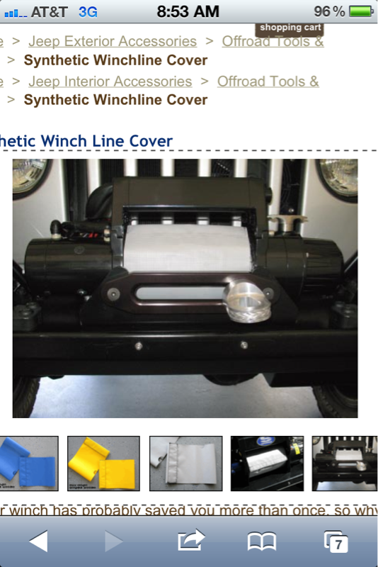

Just ordered a winch line cover. I'll let y'all know how it works.

I just asked cause ur fairlead is made for rope u might want to consider a fairlead with the wheels on it ur cable will chew in to that one and damage the cable
Oh that's not a pic of my jeep, it's a pic from the website where I ordered the cover. It hasn't come in yet
Sent from my iPhone using Jeepz
Wait a minute, you mentioned yours is metal cable, so the better choice is a WINCH COVER, which will cover the whole winch body including cable.
The cover in the picture is only a ROPE COVER for synthetic rope.
