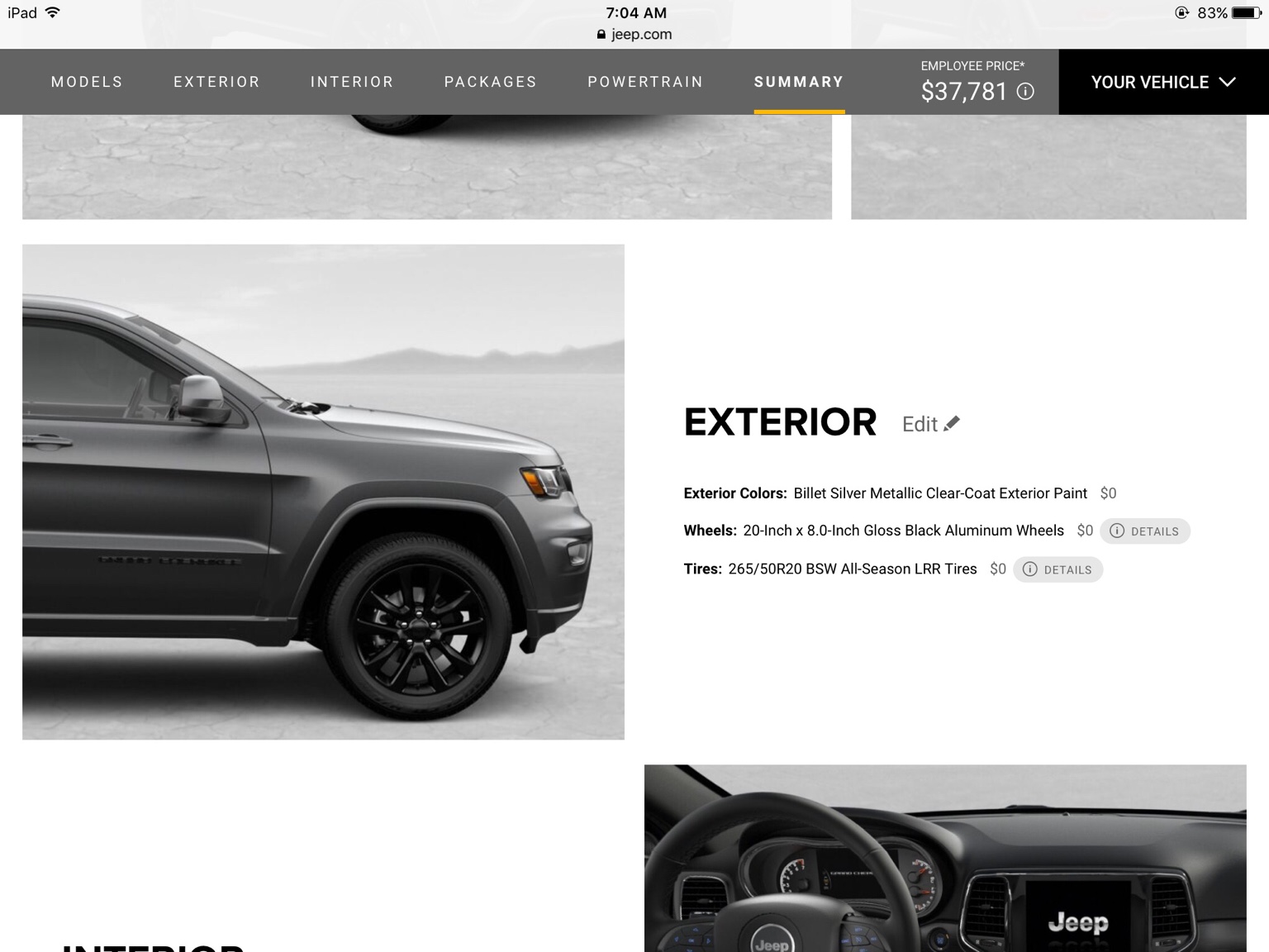

So doing a build on the mfg website it shows Brembo brakes. They are 4 valve brakes. Somewhat larger. Again a pic of what you have will verify
