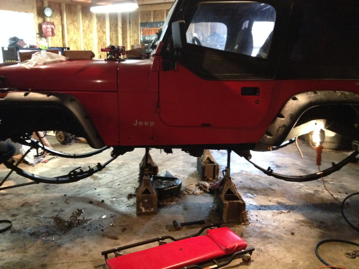

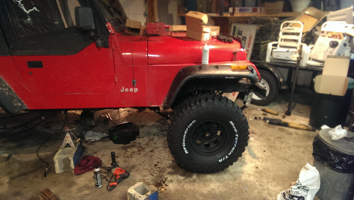

Tomorrow I'm finally replacing the lift on my yj that the previous owner botched. along with new axles ,wheels and tires ,and transfer case I'm so pumped!
On stands ready for the tear down

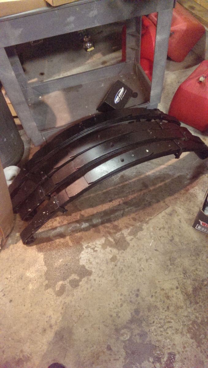

new leafs 4.5 inch Rubicon express
Returning to stock shackles those were installed by the po and have caused a lot of headaches glad there outta there
Man, those cinder blocks under there is not a good idea.

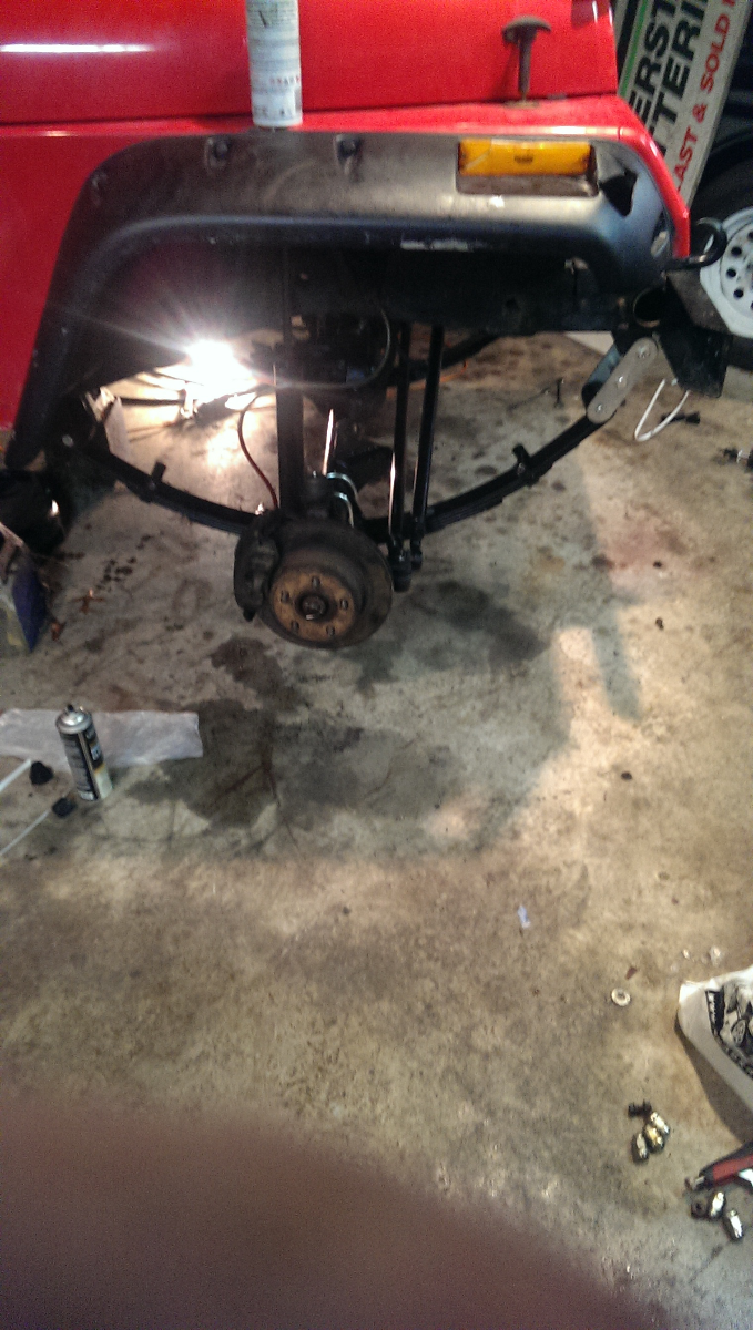

So far so good about halfway there old springs,shackles,and axles out working on getting the transfer case in after lunch then throw the axles in bolt everything up dolly it outside to put my tires on or it won't be getting out of the garage haha
cool! Ya got pics? Still dont like the cinder blocks, unless ya got a board on top of them, just putting in my 2 cents. Darn I'm jealous cause I aint got a jeep project.
Old axles springs and shocks out. New springs and shackles on

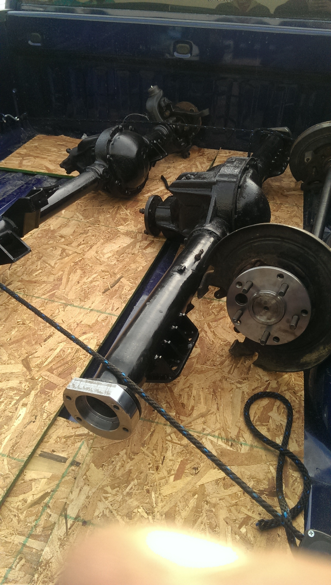

Left a hp Dana 30 out of a 96 Cherokee and on the right a ford 8.8 out of a 98 explorer. The Dana 30 is equipped with an e locker and the 8.8 a good old Detroit
Installed front axle along with a heavy duty steering assembly and steering box brace

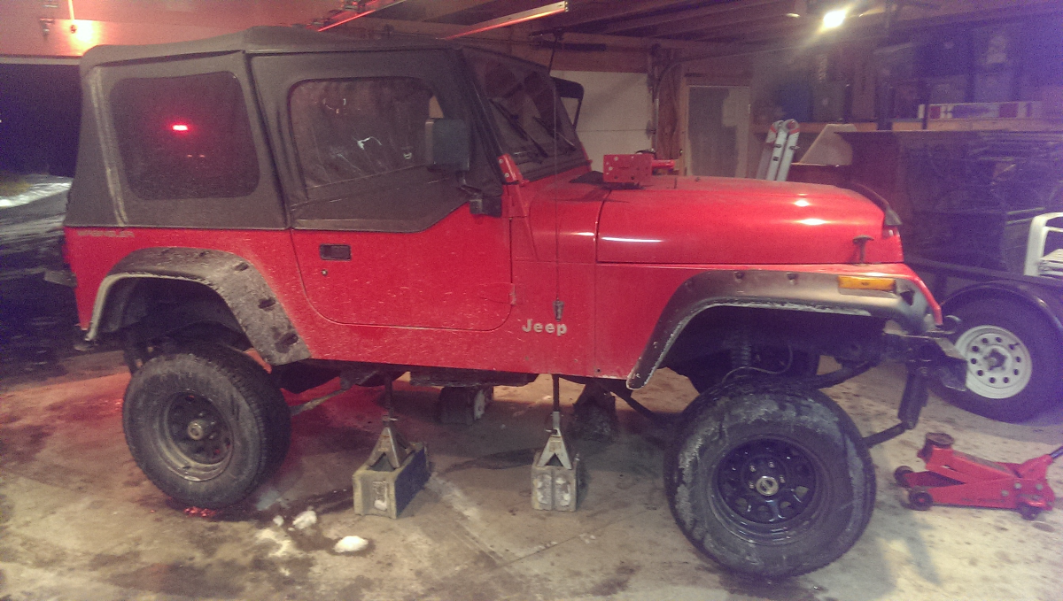

Front completely installed with tires on ready to roll 35x12.5 on 15 inch pro comp alloy rims
Still got a lot of work to do tomorrow but I'm happy with what we got done today considering we had to drive an hour one way to pick up the axles. Tomorrow's adgenda is to run the brake lines on the rear axle get the old t case out and install the new case with the sye and teralow installed then bolt things up and and bleed the brakes then the waiting game for the drive shaft!

As for them cinder blocks it was a little dicey sometimes so we got the front end done before we did anything else just for a little more stability so I'm not as worried as I was it's all down hill from this point I'm surprised how high it sits I wasn't expecting it haha Idk how the hell I'm gonna get in it

Same np231 just got another one (for free) so we figured put the sye and teralow in the new one so it's ready to go today it should be done this afternoon as long as everything goes smooth which so far it has being here in northeast pa pb blaster and a propane torch are my best friends haha
Hit a snag today ended up replacing all the rear brake lines from the master cylinder back.....also found out whoever had the transmission and t case off the last time didn't put all the bolts back in I was missing 3 from each some people make me wonder other than that the rear axle is under the jeep just gotta finish running the lines hookem up and bleed the system then I'll call this project complete
Idk what they were thinking just goes to show you never know what your gonna find till you rip things apart

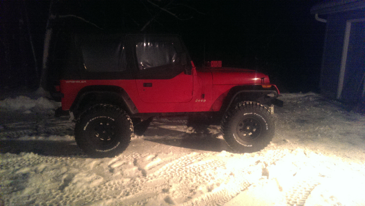

Tada!!!!! She will be ready to roll as soon as the drive shafts come in . Then I see some tj flares in the near future
It's probably not as big a deal on a YJ, but after lifting a TJ an alignment is really required. I like Firestone's lifetime alignment personally.
It looks good!
I'm still gonna get an alignment just to save the tires
