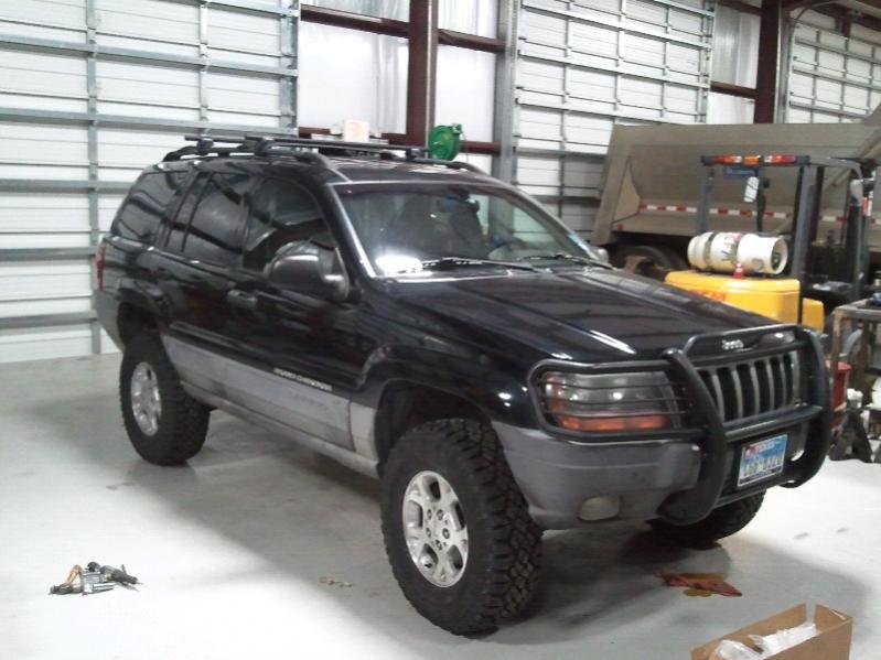

Have 2000 WJ and i am putting a 4" rough country short arm lift on it tomorrow. Rough country suggests using 265/75 but i would like to put on 285/75. Has anyone done this and if so did you have to chop it up or what?
Well I got the lift on over the weekend. Stuck with the 265's the 285's rubbed when i turned and any time i hit a good bump. Not that great for a daily driver.
