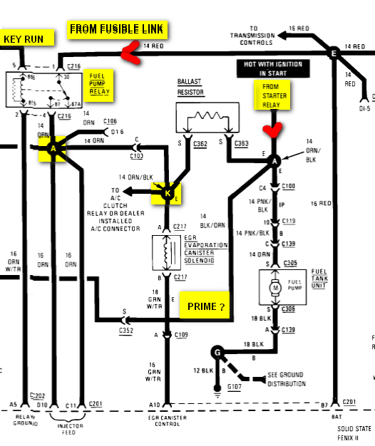

Before you tear into the pump there are a few things to check out first. Like the wiring harness and the starter relay.
You can take the yellow/black wire at the starter relay, usually marked "BAL" near the spade connector and touch it to power (big red wire at the starter relay) and it is a straight shot to the fuel pump through a few connectors.
Here is an old diagram I have.
