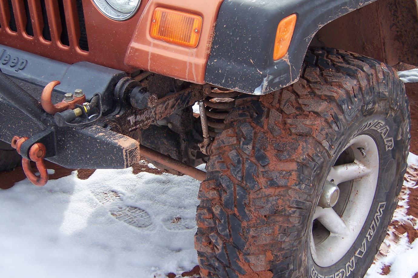

Personally I ditched my rear sway bar and went to a Tera-flex street and trail system.
The sway bars main propose is to keep body roll during Turing in the streets.
