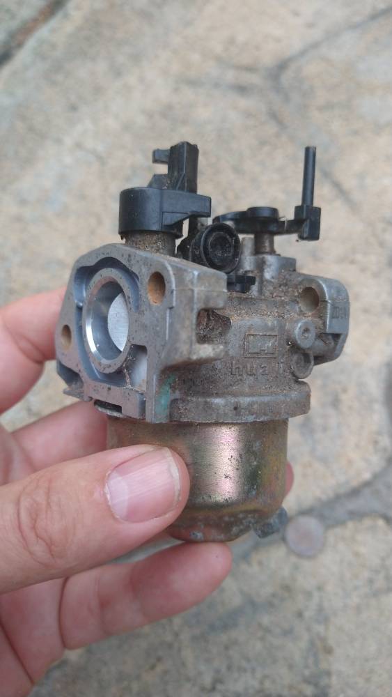

I enjoy fixing old throwaway lawn mowers, so often grab them off the side of the road to tinker on. I found a nice Troy-Bilt mower that looks good it would start and run for a second and then die. I took the carb off and saw this.

Yep force carb and choke cleaner through it. Does the float, float? Does the needle stop the flow? Rebuild kit $$14

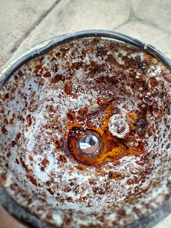

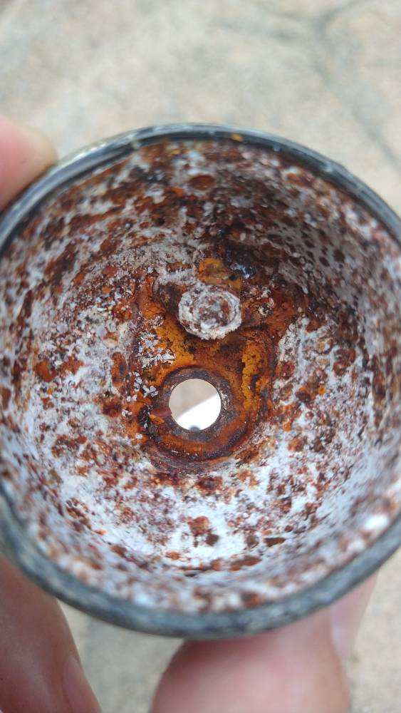

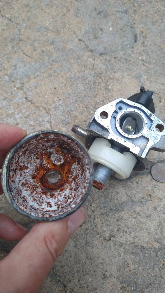

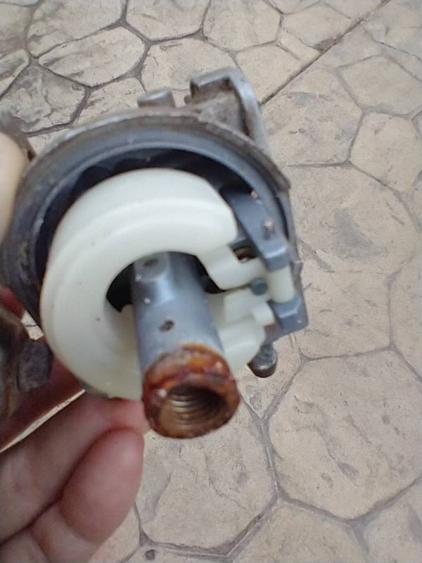

wow, they must have let some really corrosive fuel sit in that carb, it ate up the bowl and the bottom of the mount tube.
are you going to get a ball wire brush and put it in the drill to get all the junk out or just get another carb? the rest of the carb looks ok.

Is it junk or will you be able to clean it?

The old carb bowl would also leak fluid, the gasket around the bowl was shriveled up, as well as the one at the bottom. I ended up buying a new carb off ebay that came with an air cleaner and sparkplug as well. It didn't fit 100%, but well enough to work. Got it back up and running in about 20 minutes.
