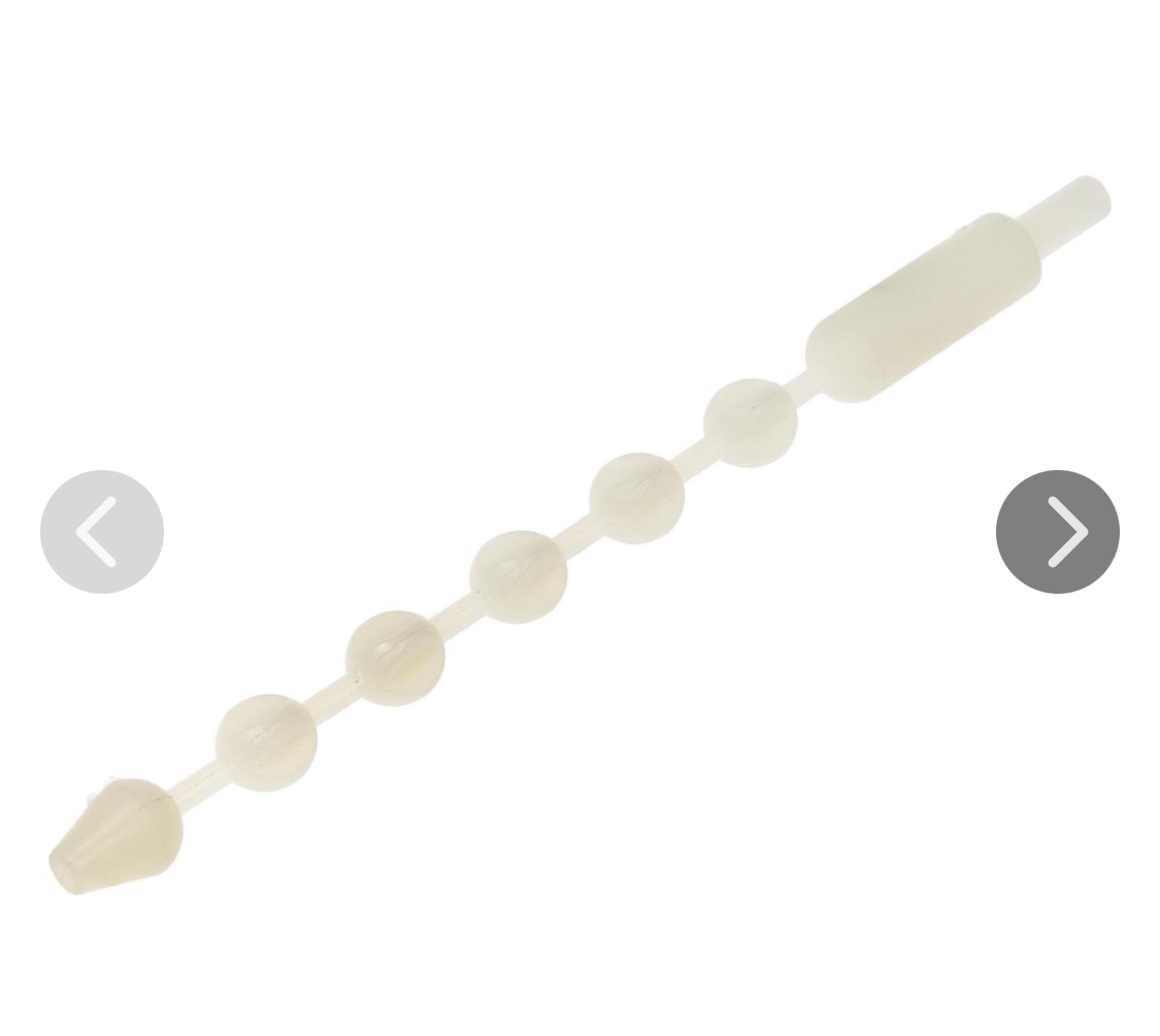

The plastic piece always breaks off after the 4th ball. Here's what the shifter looks like with the broken piece.

Here's the busted piece removed from the shifter tube, I'm replacing it with, 1/4" steel brake line.
