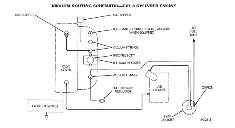

2). Does anybody have a good diagram of the vacuum lines for the 4.0?
