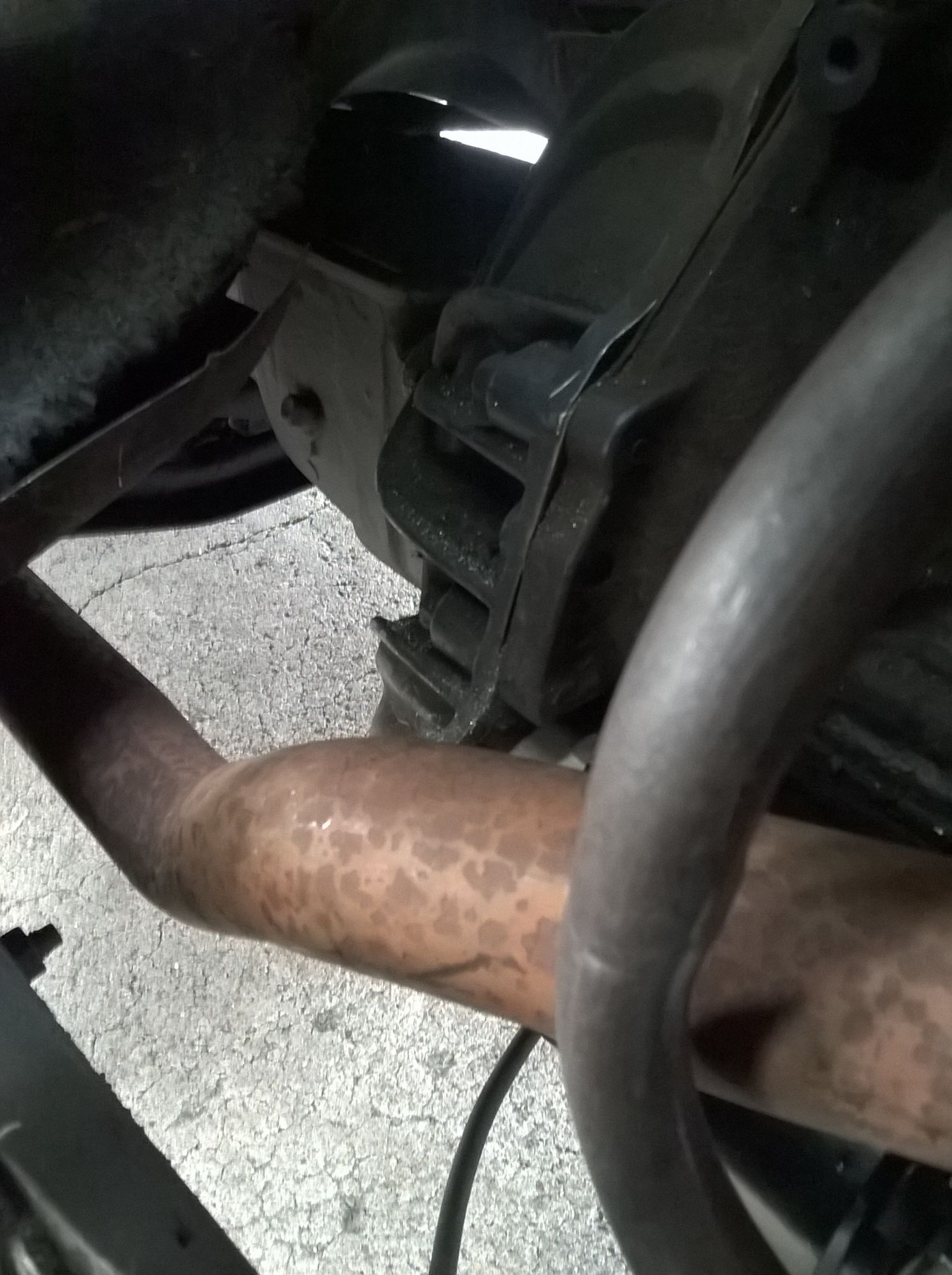

It is very tight quarters in this part of the engine compartment despite the I6 being skinnier than the V8, the exhaust pipe is right in the way with no means of removing it due to other clearance issues.

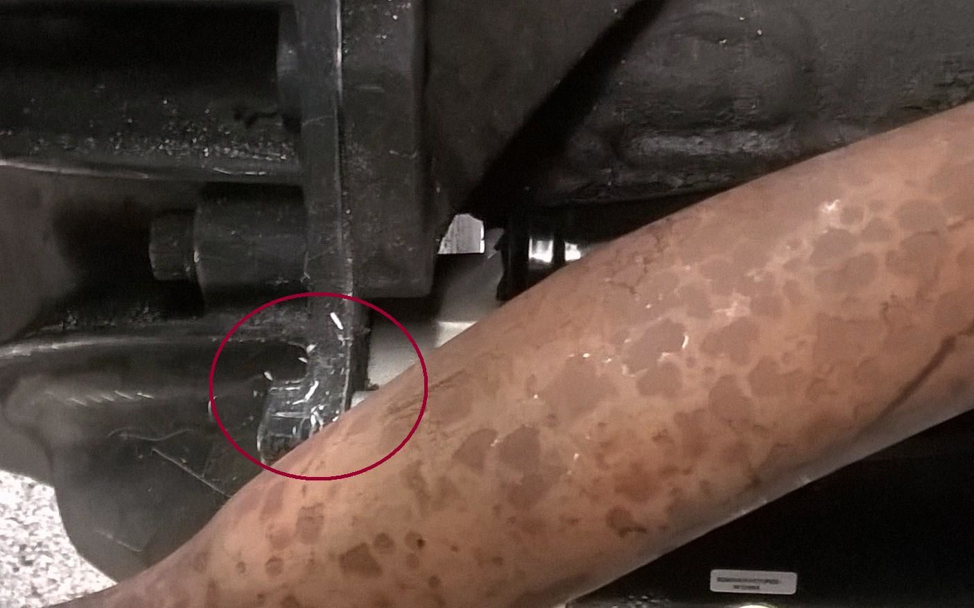

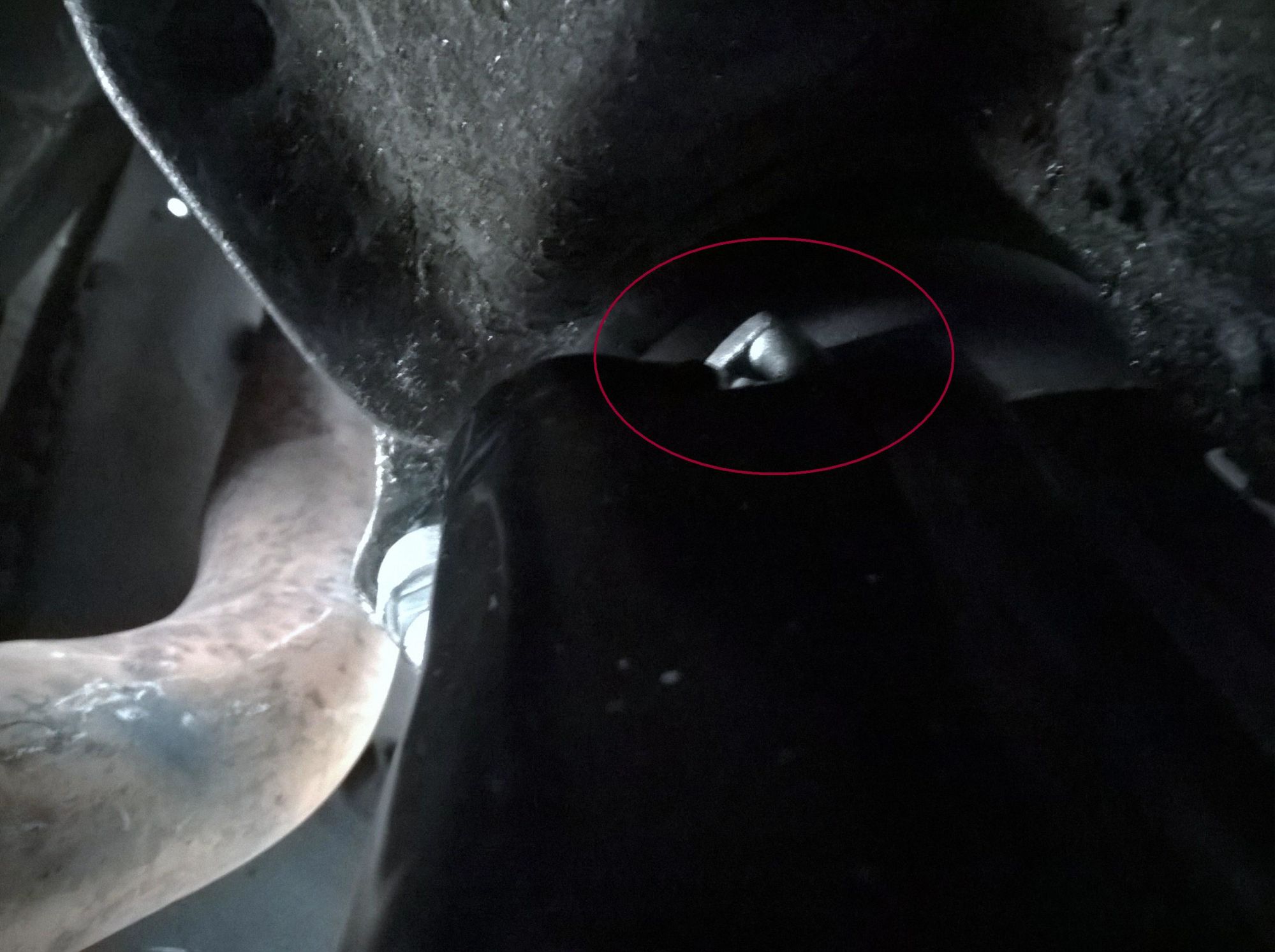

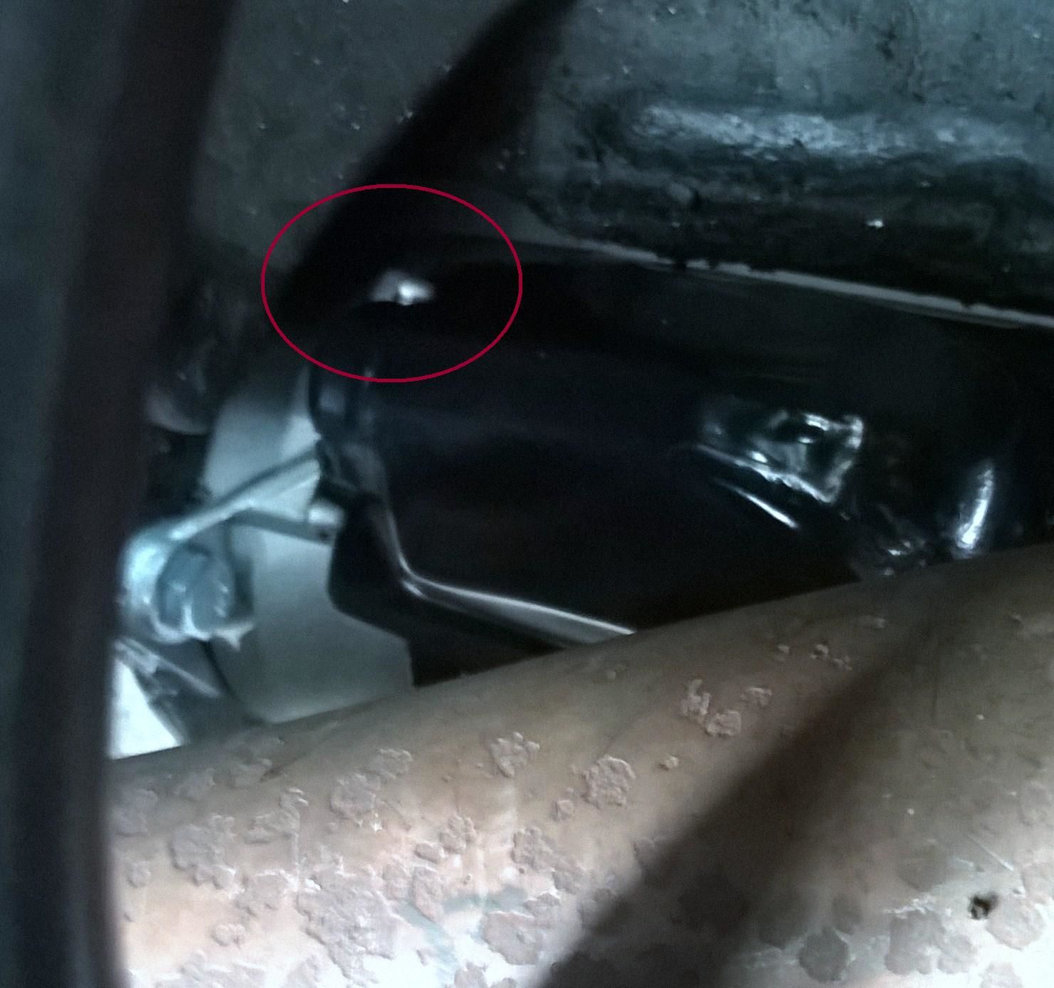

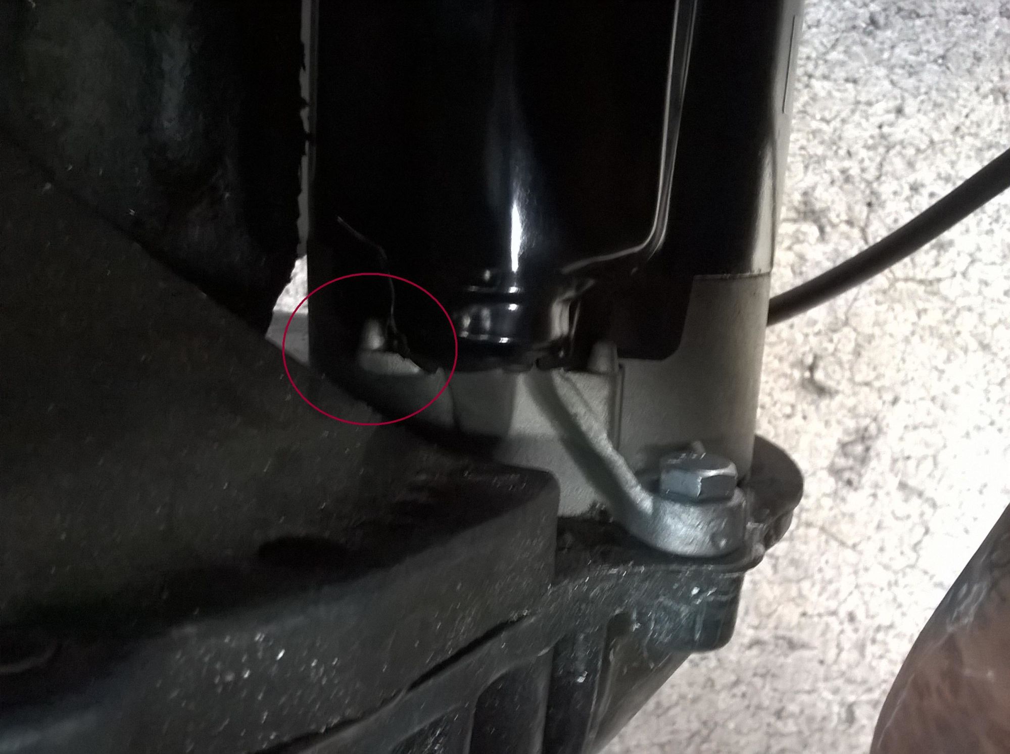

We then checked to see if we could squeeze in a 4 inch grinder to grind the head off of the bolt, but as you can see from the photos it's just too tight. My friend then broke out his Sawzall and with a new metal blade tried to get a bead on the bolt head but the throw of the blade kept throwing him off of his mark. So it was up to my Dremel tool with the kit of tiny 3/4 inch cutoff wheels. To get it even with the axis of the bolt head it took my friend on the top side (from the doghouse nacelle) and me working from underneath to manipulate the switch. We went through 4 cutoff wheels and another attempt with the Sawzall and we were very close to the mounting flange, so we stopped to see if we could break the starter past what little there was left of the bolt head~it held fast. :-arrgh. Beating it with my 5 lb. mallet to release some frustration and to see if there was any deflection we found the starter was moving a tiny bit. Using the Dremel once again and the cutoff wheels carefully shaving off by the fraction of a millimeter what I thought were the remnants of the bolt head... still it held fast. Taking my mallet and adjusting my body position for better leverage a beat on the starter with all the force I could muster and finally it dropped on my chest with the bolt threads protruding thround the mounting flange on the bellhousing. I bumped it with the trouble light and my frined saw the bolt move a tiny bit~sure enough the bolt was free and now could be removed using my fingers.

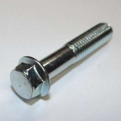

you can bet we used a conventional 9/16 head bolt on that damm thing when we mounted up the new starter. Total time spent on this single bolt was 5 1/4 hours.
