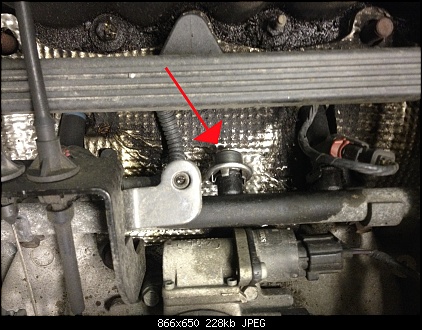

Will try..Took out newly installed TPS and found out I forgot the seal that goes with is. However it appears it was in right. Put new seal in when re-installing TPS. There really wasn't a need to turn clockwise. It slid right in flush mounted. like the original one I replaced. There is NO Schrader valve on my fuel rail.. just the little round attachment that helps regulate fuel pressure on the rail. TPS % reads 16.3 constant with new seal in. Still getting P0136 code which is the sensor I replaced with a Bosch. All my transmission codes are back P0743,P0753,P1765. Also still getting P1495, P0136 plus 14---ABS cluster malfunction.. WTF?

the photo is not my fuel rail just showing the fuel rail round gizmo

The port usually is near the front 2nd cylinder pointed away from the engine.

Nothing there. Gonna pull power distribution block and see if the mice ate underneath it. Also my evaporation pump P1495 is ticking a bit. Gonna see if I can give it a look/see/clean?? maybe.
