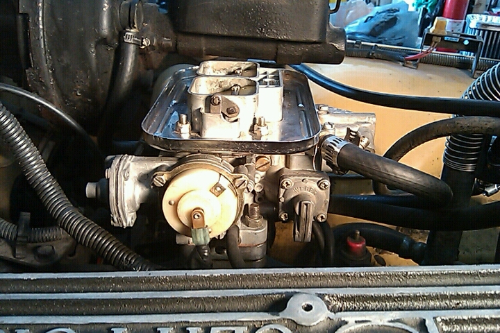

I want to say its a 32/36 DGEV, but I can only go off of pictures, It was installed when I bought it, and I have no documentation. It has the electric choke.
Here are three that should help.
First lets positively identify your carb. If it is a genuine Italian designed Weber it will have the series and size stamped into the base flange of the body on the end opposite the choke.
Of these three if you will study the tune guide,... consider each line of it as proved Weber facts and be be much better attuned to what adjustments if any need to be made to it.

OK, the rebuild is done - overall the carb looked very good however the idle tubes were clogged, but not anymore! I put the carb back on last night. It started and idled pretty good today. i had to shut the engine off, and now it won't fire :lol:. I definitely think I made some progress, and now I am focusing on the electronic choke. Reading up on that now...hopefully its just a matter of getting it adjusted along with the getting the timing back where it should be. I haven't given up yet!
Have you positively identified the carb as being a Weber? Reading of clearing the idle tubes leads me to think you maybe running with the Carter/Weber BBD. It will have the electric stepper motor at the rear of the body, adjusting air mix.
If it is a Weber it will appear near to the diagram and it's identification will be stamped at the base on the end that is opposite of the choke assembly end.

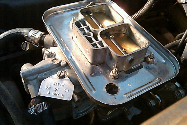

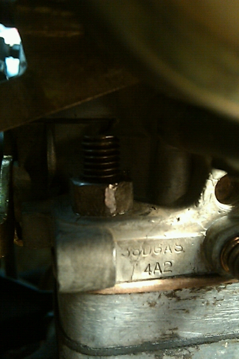

I have a metal plate with Weber stamped on it along with some numbers....nothing that resembles model numbers. This plate is attached to the screw next to the fuel inlet tube. At the base opposite of the choke there is a stamp "Italian" but no model number. With that, I assumed it was a Weber.
geeze I'm learning a lot more than I had intended to!
I just put in a fuel pressure regulator, I can see fuel going into the carb and I can smell fresh gas....
Based on the appearance you have the gem of the Redline Weber jeep conversion carbs, a 38DGES Thanks for the pictures.
If you will look closely the ID stampings will appear where I mentioned, considering that the two sides are longer than the two ends of the body and the base is that area which has the carb mounting holes through it.
Here is the tune guide line for that series. Let us know how well the carb allows the engine to react while establishing those to be expected maximum screw settings. The screws do tell all as the point of reference to tuning the carb to fit your application.

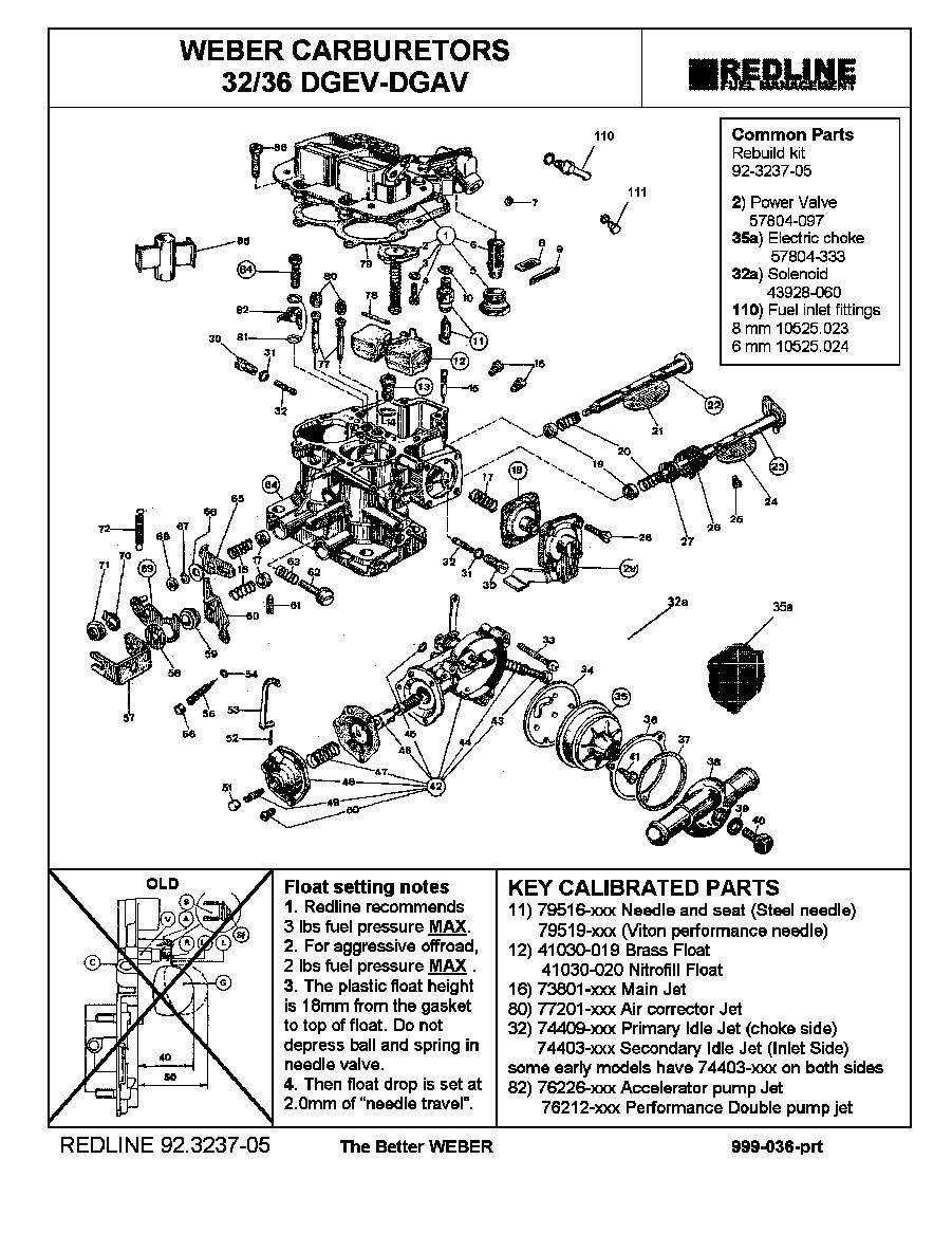

While you were inside did you find it necessary to adjust the floats in order to establish the setting that Redline Weber recommends that us jeeperz use and your mention of a clogged channel, orifice or jet I wonder what and where found that issue?

It's all good with the kit, both the DGS and the DGV kit parts are the same. The concern may be that you used the float setting guide illustrated on the DGV detail sheet. Did you and are the floats brass or plastic?

Is that just an aluminum casting or is that a crack on the base?
