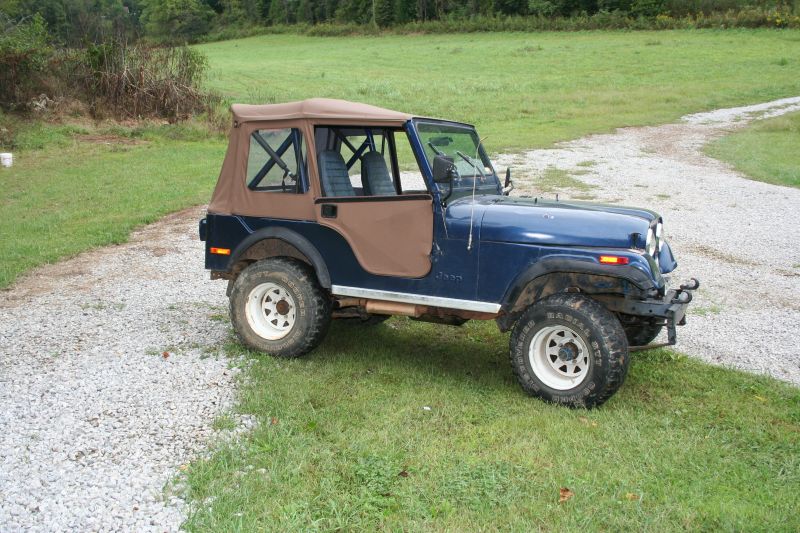

pic1 as purchased

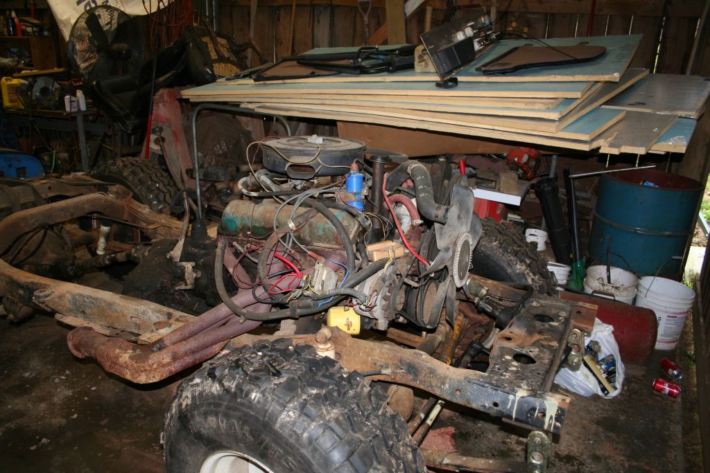

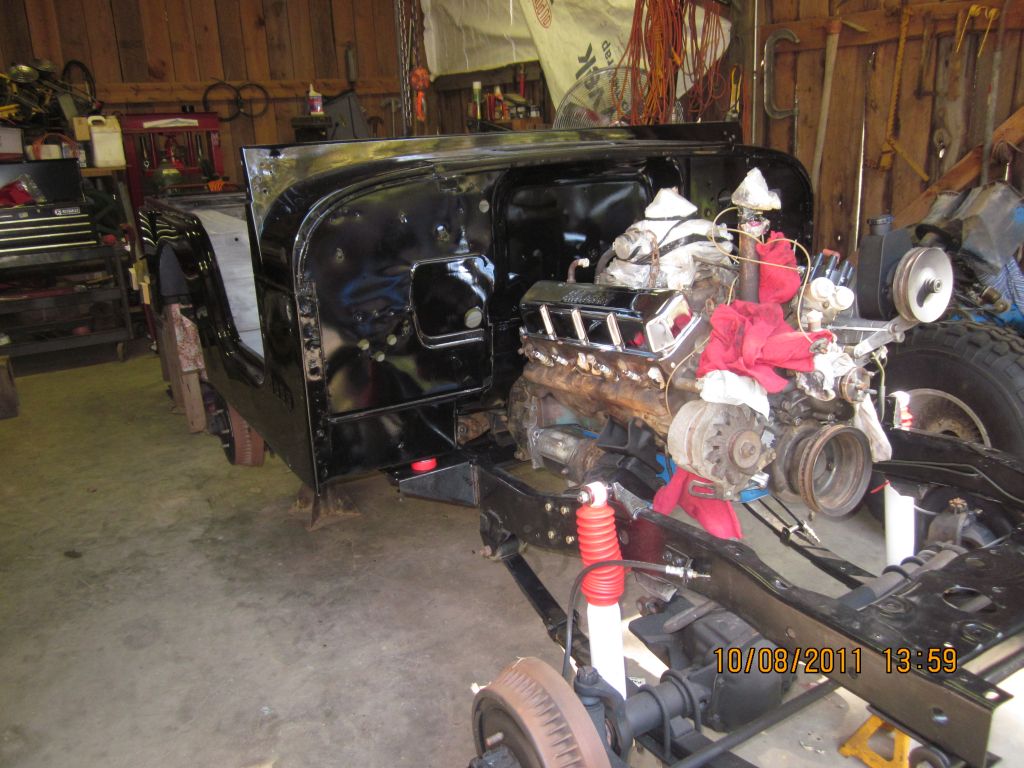

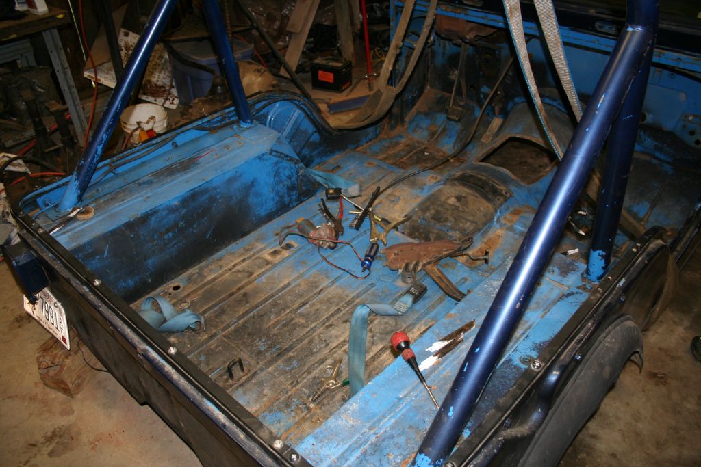

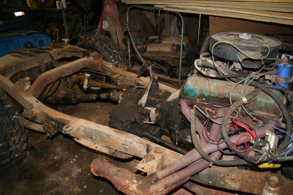

pic3 & 4 body's off engine and transmission to go - frame is excellent shape

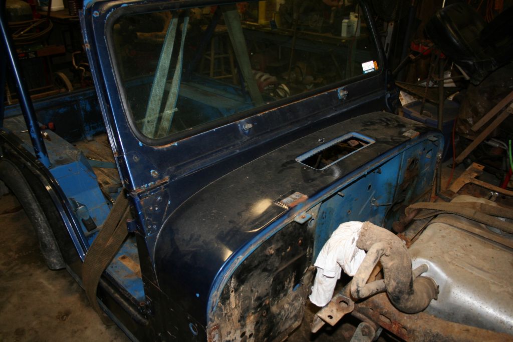

pic5 & 6 body has mimimal rust for a 76 year model

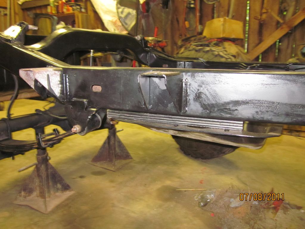

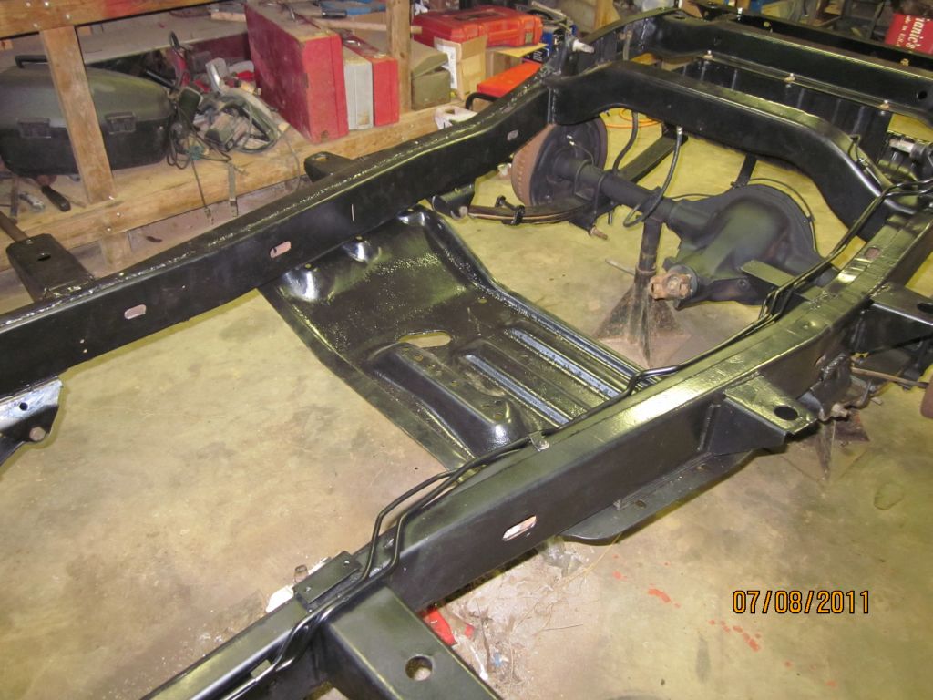

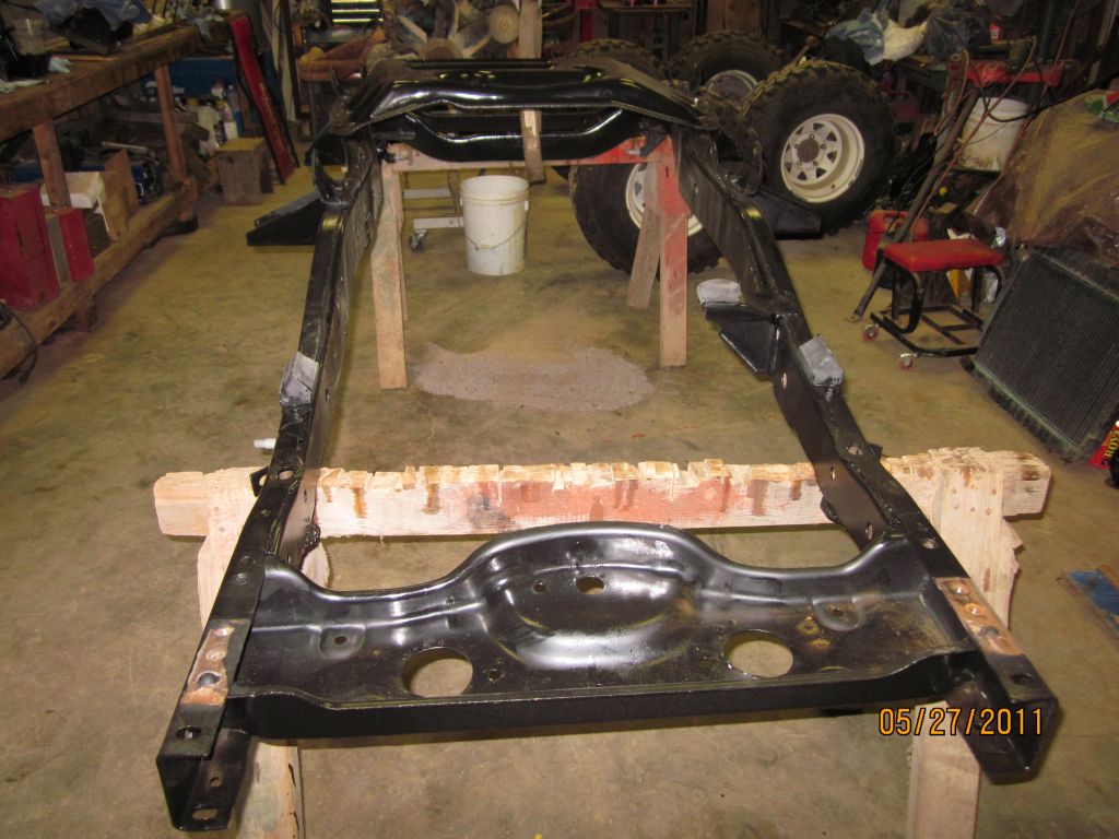

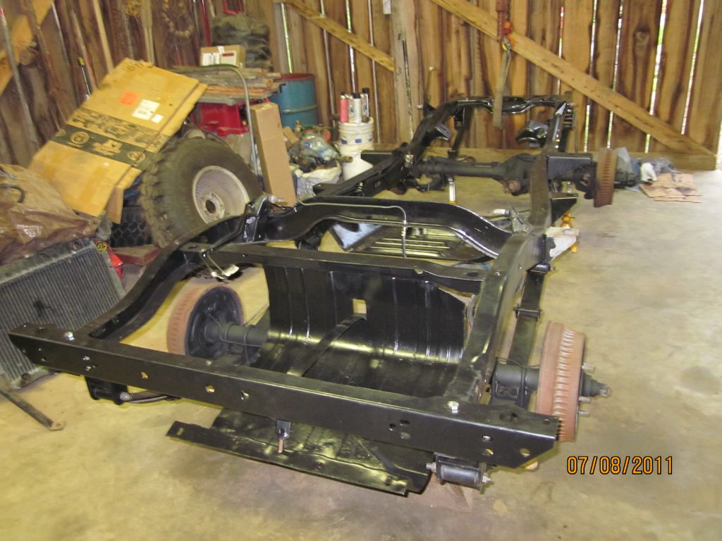

pic7 & 8 frame after sandblasting and painting with por15 coating
pic9 added shims to accommodate the T18A transmission
pic10 new brake and fuel lines installed
pic11 engine, transmission & tub reinstalled - tub was sandblasted and then sent to paint shop for some black metal flake paint.

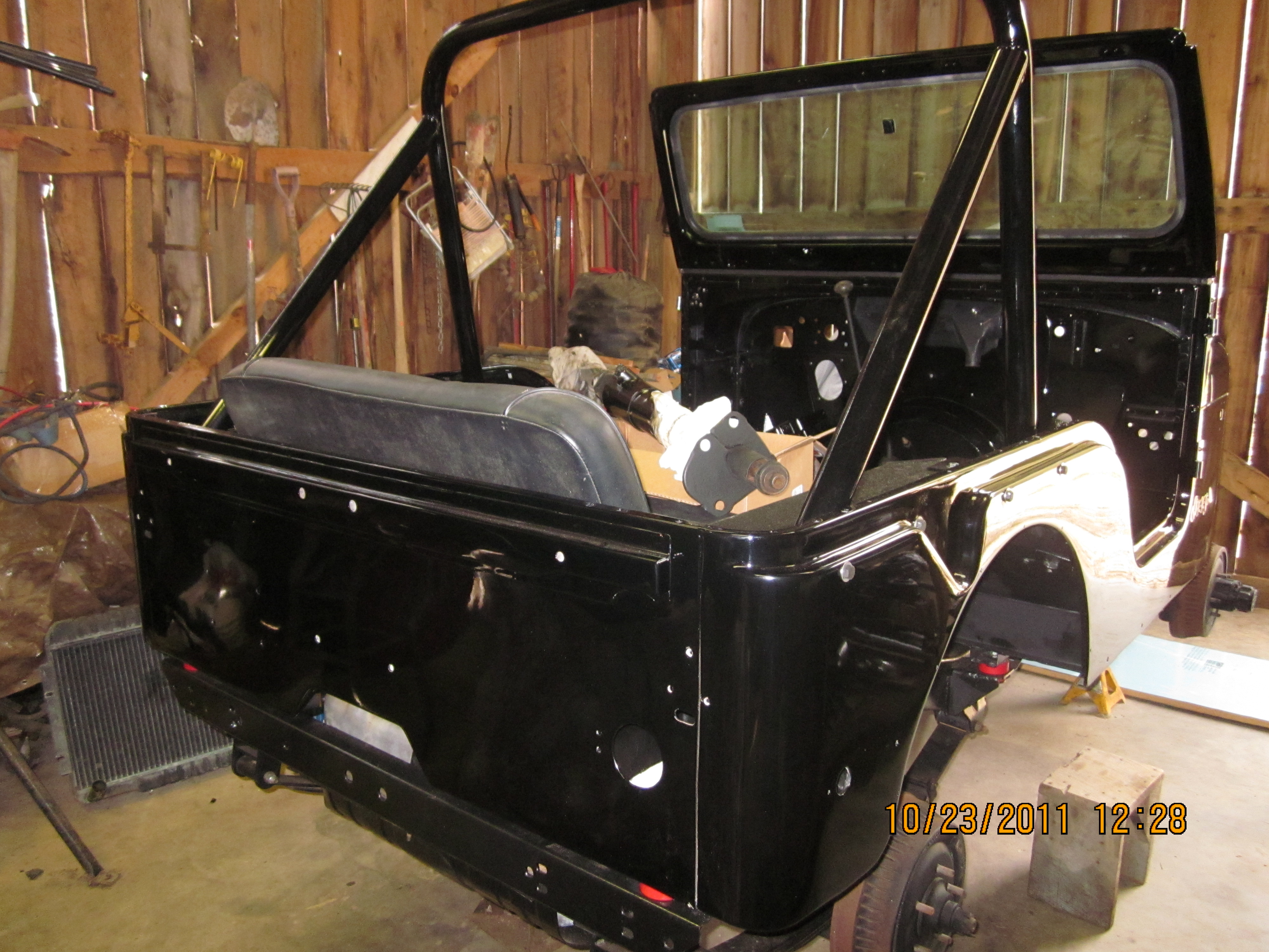

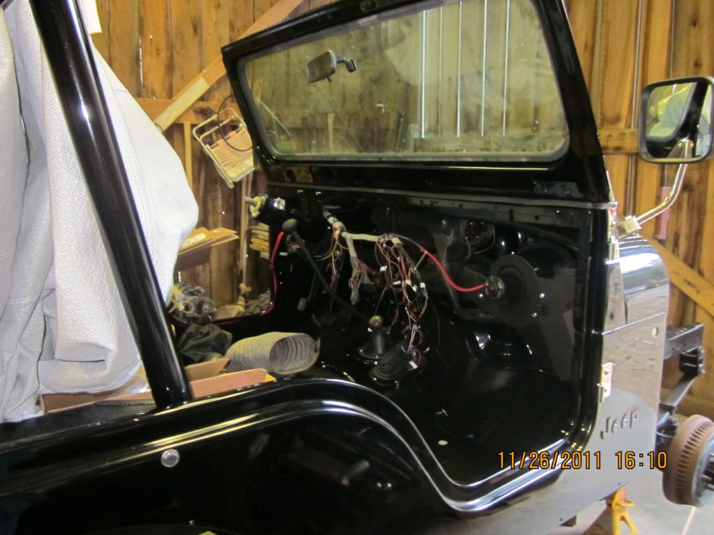

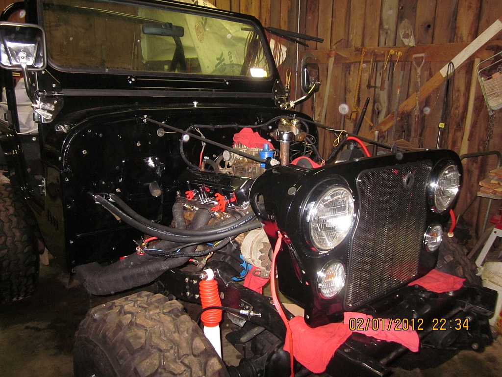

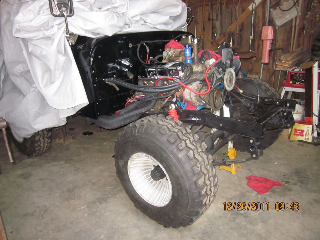

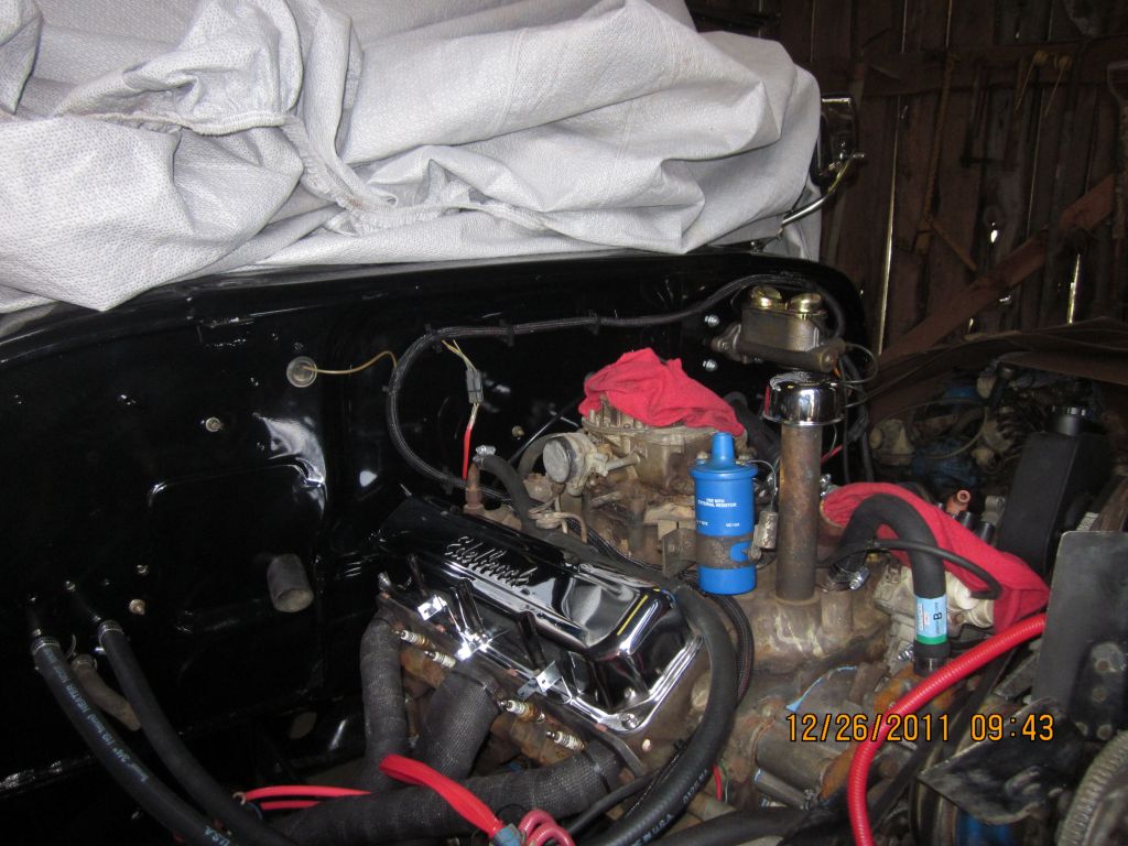

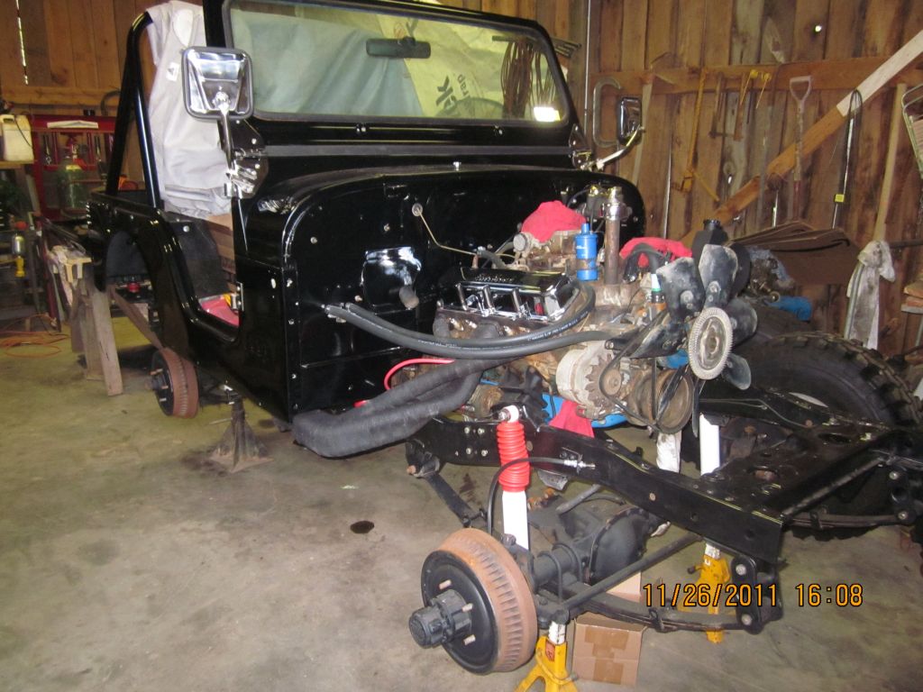

Some more pics of the progress over the holidays. Looking like may have an issue with the rear driveshaft angle??? Engine compartment wiring and steering box to be next to reinstall.

Lookin' good....looks like the body was in great shape to start with(lucky you!!)
Just keep pluggin' away at gettin' it back together...no need to rush & screw something up this late in the game.

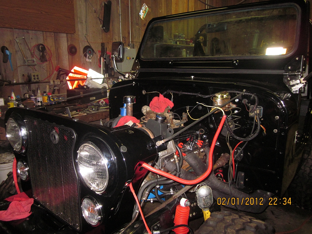

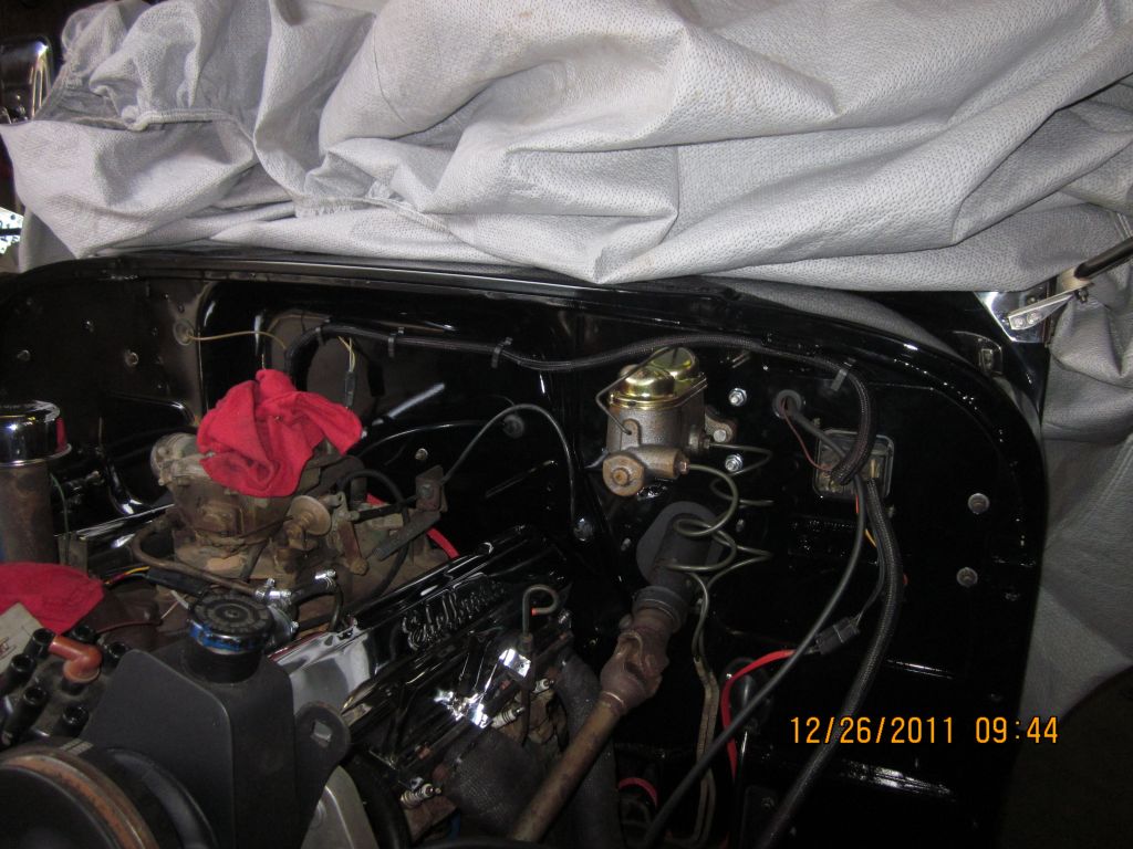

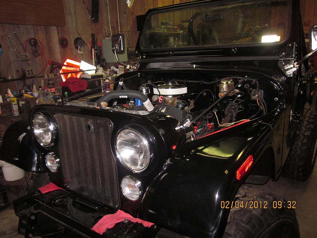

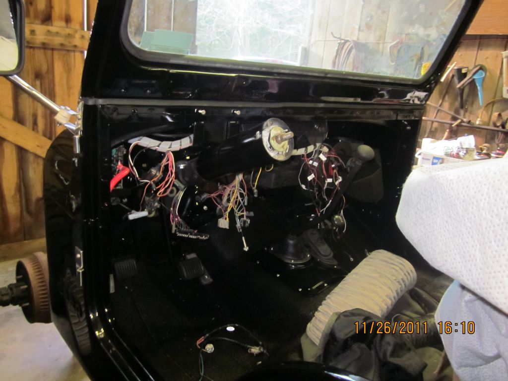

Didn't have much time over the Christmas holidays, work got in the way. Did get the engine compartment wiring harness installed, brake lines completed, steering gearbox installed, and the centerbore of the wheels milled out so that they would fit.

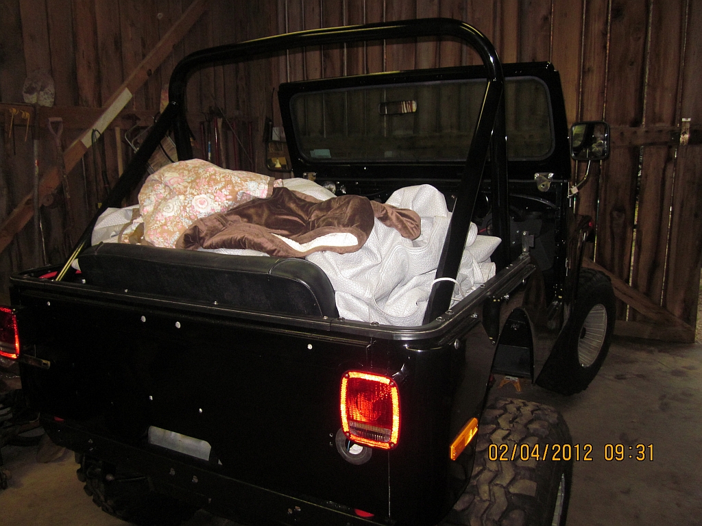

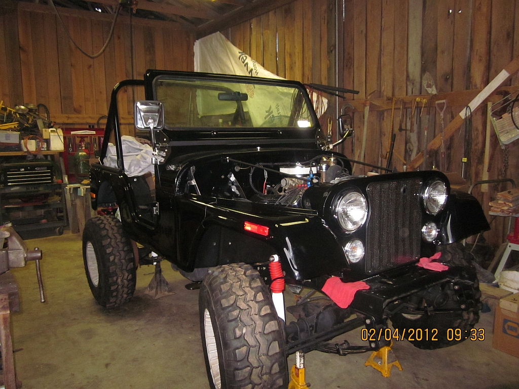

Has anyone tried the "flex u-joints" from Tom Woods. Due to the transmission change the rear driveshaft was shorten and with the 4" lift the angle increased. Hope these do the trick.
A little more progress made on this home trip. Almost ready to put the wheels on and take it down off the jack stands. First time for a lift and looks like I'll need to adjust the drag link to make the steering line up. If anyone knows how much it changes the steering it would be appreciated.

Due strickly to the lift, had to changed shocks, brake lines from frame to axles, emergency brake cables, replaced the pitman arm, reardriveshaft angle. I also changed from a 3-speed T-150 to a 4 speed T-18A which compound the rear driveshaft angle due to the output moving back about 2-1/2" inches. Before the lift though I was having tire rub when off road.
