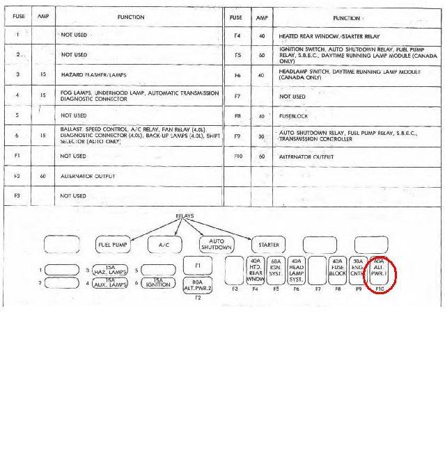

If the Alternator isn't putting out 13.9 amps min, you will never properly "re-charge" your battery. If the field tester says your alt isn't putting out enough , strip it off the vehicle and take it in to be bench tested. Another free service...
Now if the bench test shows bad, replace it....if it is good then you have a short somewhere.
