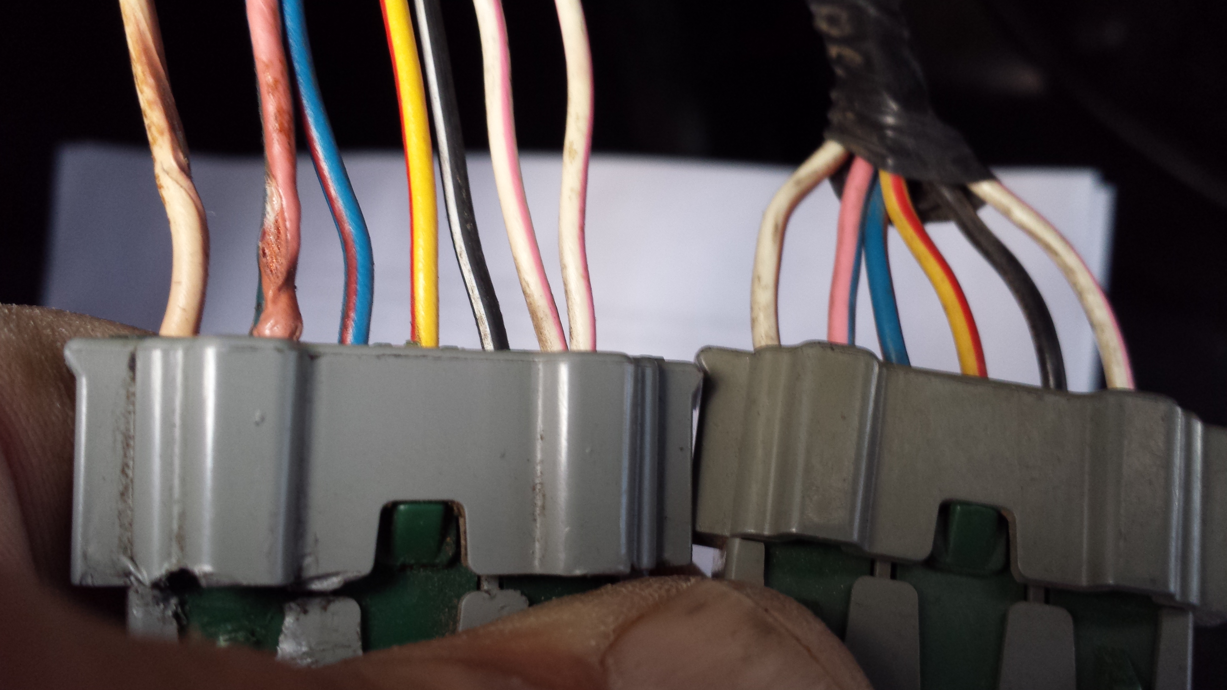

Later, it caused a short. The connector that attaches to the brake switch was slightly melted on one side. I replaced the connector and the brake switch (and the fuse).
I then noticed my brake lights activate when I turn the engine on. If the engine is off, it doesn't matter where the key switch is, they work just fine. Brake lights come on, turn off when you release the pedal, turn signals, parking brakes, everything works.
It is only when the engine is running that my brake lights are full on. If the engine is on, I get no reaction from the brake switch whatsoever. When I press the brakes or remove the brake switch and use my fingers to activate brake light switch, they still stay full on Red.
Can someone please help. I am good with voltage meters and have some tech experience on amps and radios, I am ok with car wiring but in no way am I an expert.
Please help. I am at the end of the trail and will need to use the winch on this one. Below, (my son, I know, had to post this one. He loves jeeps and I love him). The second pic is the connector I purchased at the salvage yard. The connector on my jeep had one extra wire, both going to one pin. I simply spliced them together to the same pin as the original.

Welcome to JEEPZ.com . I don't have the wiring diagram , but from your picture of the harness plugs , it looks as though the 12 gauge white which I believe goes to your brake light is shorting with the pink wire. Try a continuity check across the two to see if they are . The plug looks over heated and may have lost some of its ability to separate the two and the terminals are shorting. That would explain why the brake lights are live when ignition is on. If the plug is compromised and the pink wire is live ignition on , it may be feeding the brake light wire without the brake pedal depressed.

I'll check continuity. I replaced the connector that was damaged (burned) with the one on the right. Finding a connector was extremely difficult.

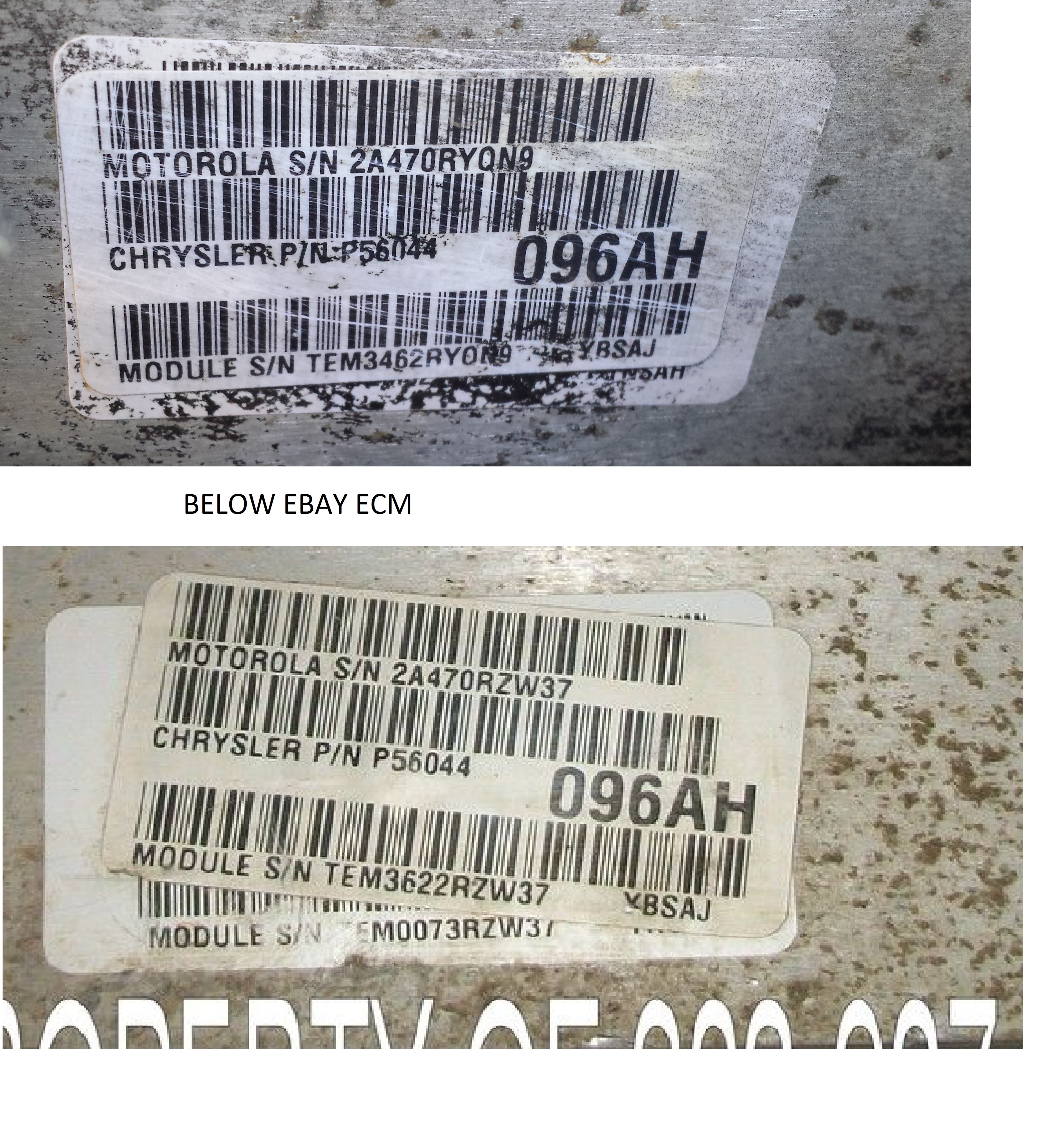

I found a computer with the exact serial number like the one in my jeep (P56044 096AH). The ebay specifications state the computer is for my exact model but they also say its for a "MANUAL TRANSMISSION".
Here is my question: WILL THIS COMPUTER WORK ON A JEEP WITH AN AUTOMATIC TRANSMISSION? DOES THE ECM CONTROL THE TRANSMISSION?
the first thing you need to do is start calling the local new jeep dealers and ask how much to reprogram an ECM. Then check to see if they have any compatibility issues they know of, by supplying your VIN ( they can Identify options and factory settings from it) and then tell them the ECM you have/are considering to be sure. MOST of the settings and options are programmed very few other than year and engine are hardwired since having separate parts for every option would cost jeep more than basic programmable units. But there are always those rare exceptions, and if your luck is like mine, you'll have one. As an example last fall I rebuilt the 249 transfer case from in my 95 GC ltd. A super simple job as they are very simple and reliable xfer cases, but when I went to put it back in the confounded catalytic converter was in the way, so I took it off the transmission jack and lifted it in place and had the spouse try to get one nut started on a stud. long story short, short job still isn't done due to weather issues... I ended up dropping the xfer case on m chest and fracturing my
