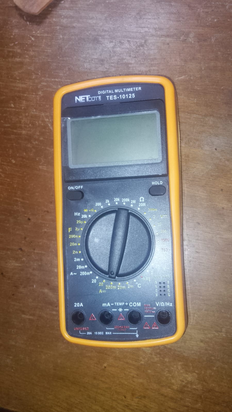

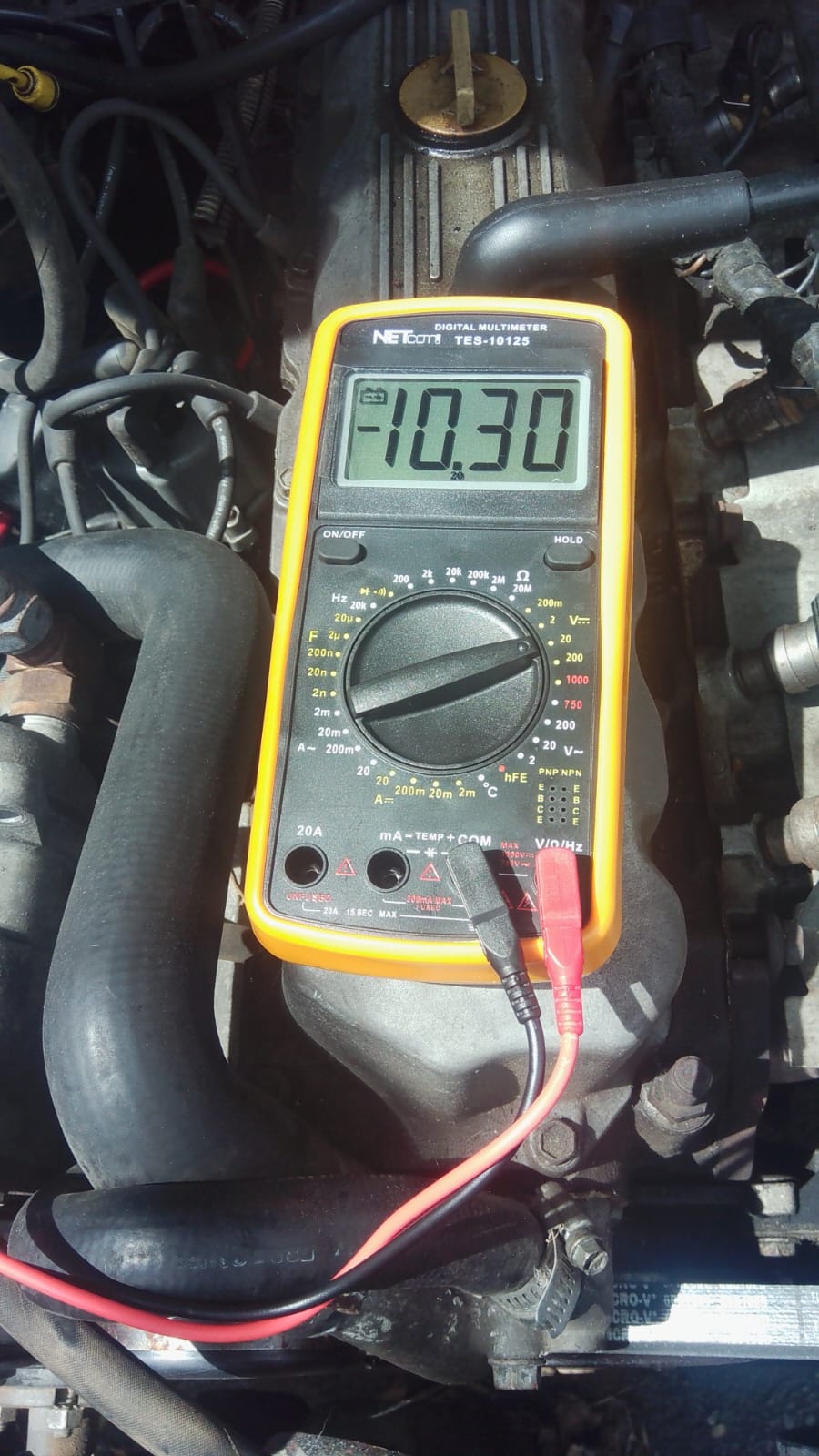

This makes no sense to me. When I ran the draw test with the settings that you told me this is what I got

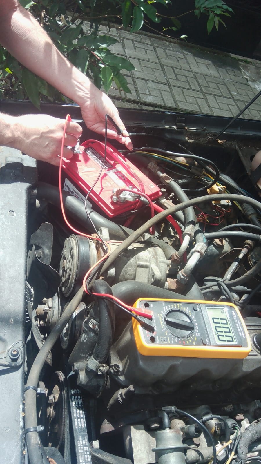

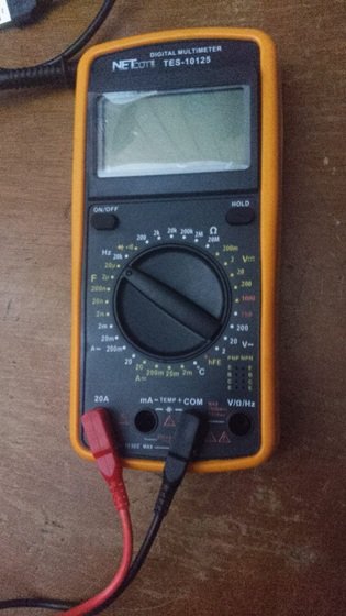

I reset the meter to do a DC 20 amp test and moved the red probe to the right side of the black as you can see in the image. I checked the battery and got 12.43 amps so I did the draw test with the same settings that you can see in the image below and the results. what I do not understand about this is the negative sign?

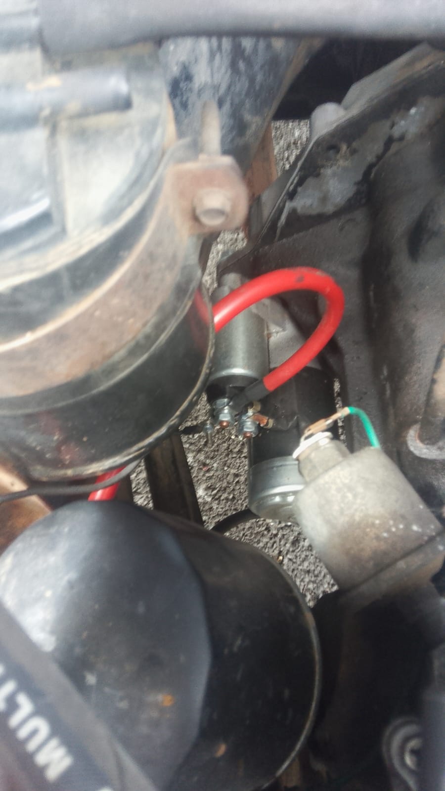

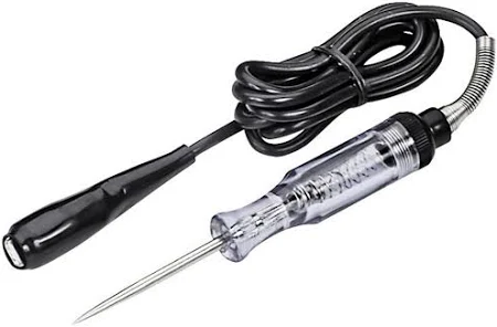

Now this is going to get weird? the last image is of the starter solenoid let me give you the details the negative battery cable is NOT connected the keys are on my belt loop everything is off inside the Jeep. I took a test light one that looks like a screwdriver and all three polls, the ignition wire pole, the battery cable pole, and the wire below the cable that goes from the solenoid to the starter on the solenoid all three have power going to them?
How is it drawing power when the negative cable is NOT hooked up? The fact that all them have power tells me the solenoid is bad but how is it drawing power from the battery without a negative cable?
