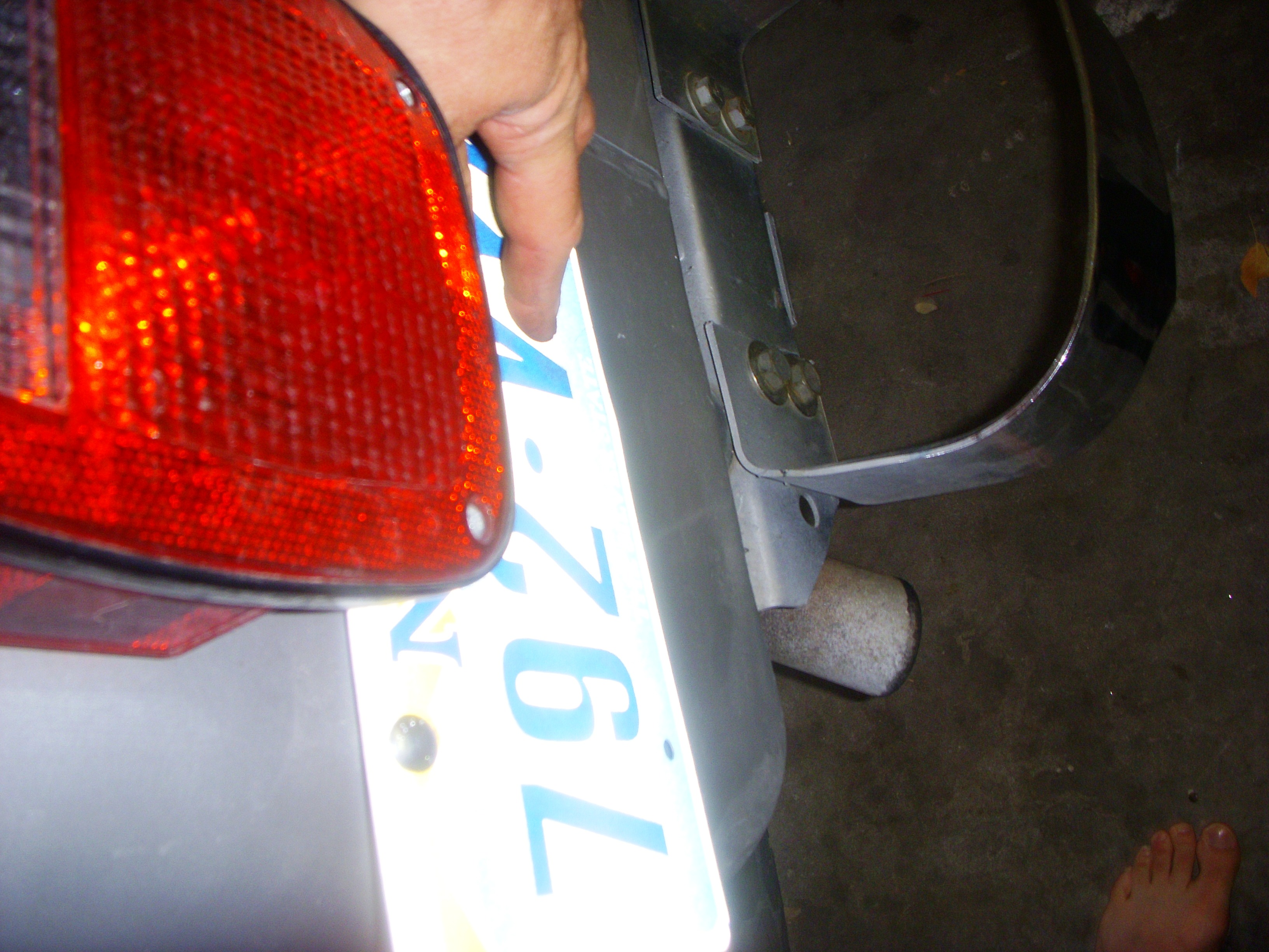

I don't think body shift has anything to do with it, she has 2 pics taken straight on showing a physical variation in the axles themselves. I did notice where she said she swapped the wheels out. I would do a quick check to make sure you didn't get an off-wheel with a different backspacing. If it makes you feel any better my CJ has the same problem and nothing wrong I can find.

The one pic is my daughter sitting in the jeep. I know what you are saying about the physical variation in the side view but it runs pretty straight and I can't find anything else but the jacked up and missing mounts on the passenger side.

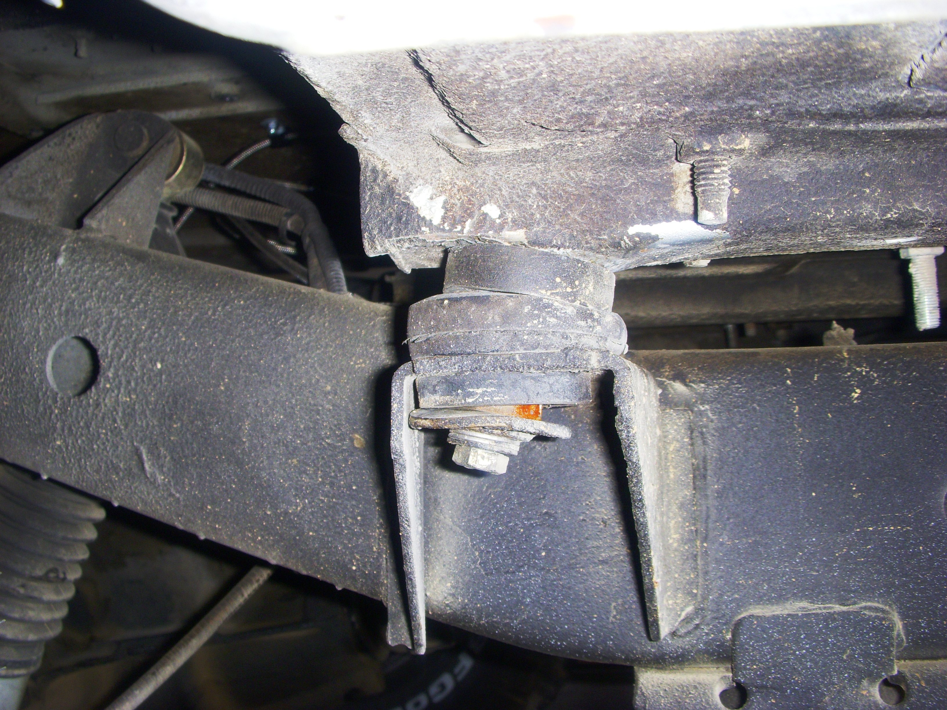

1st... Is of the passenger rear body mount.

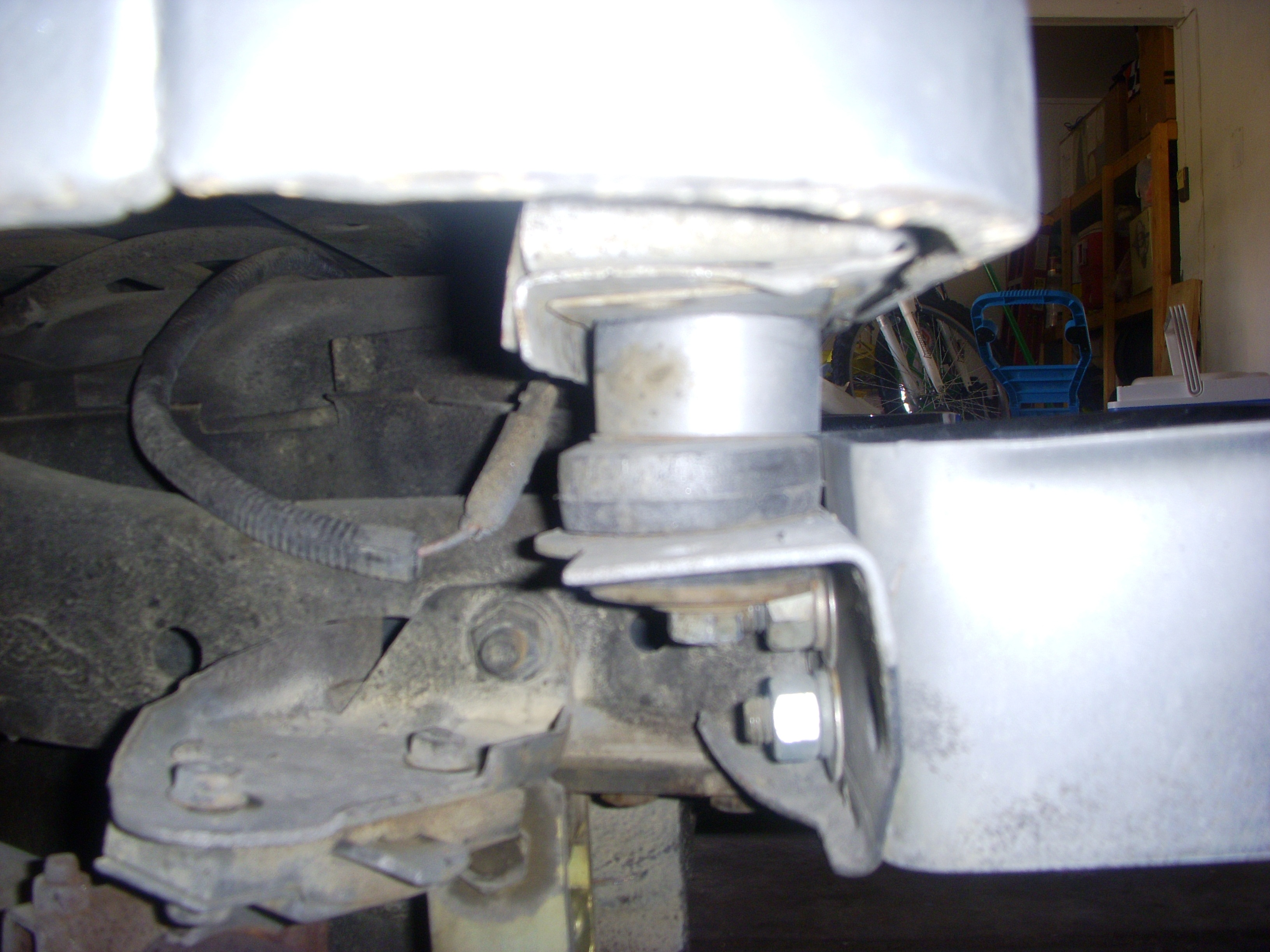

2nd... Drivers body mount.

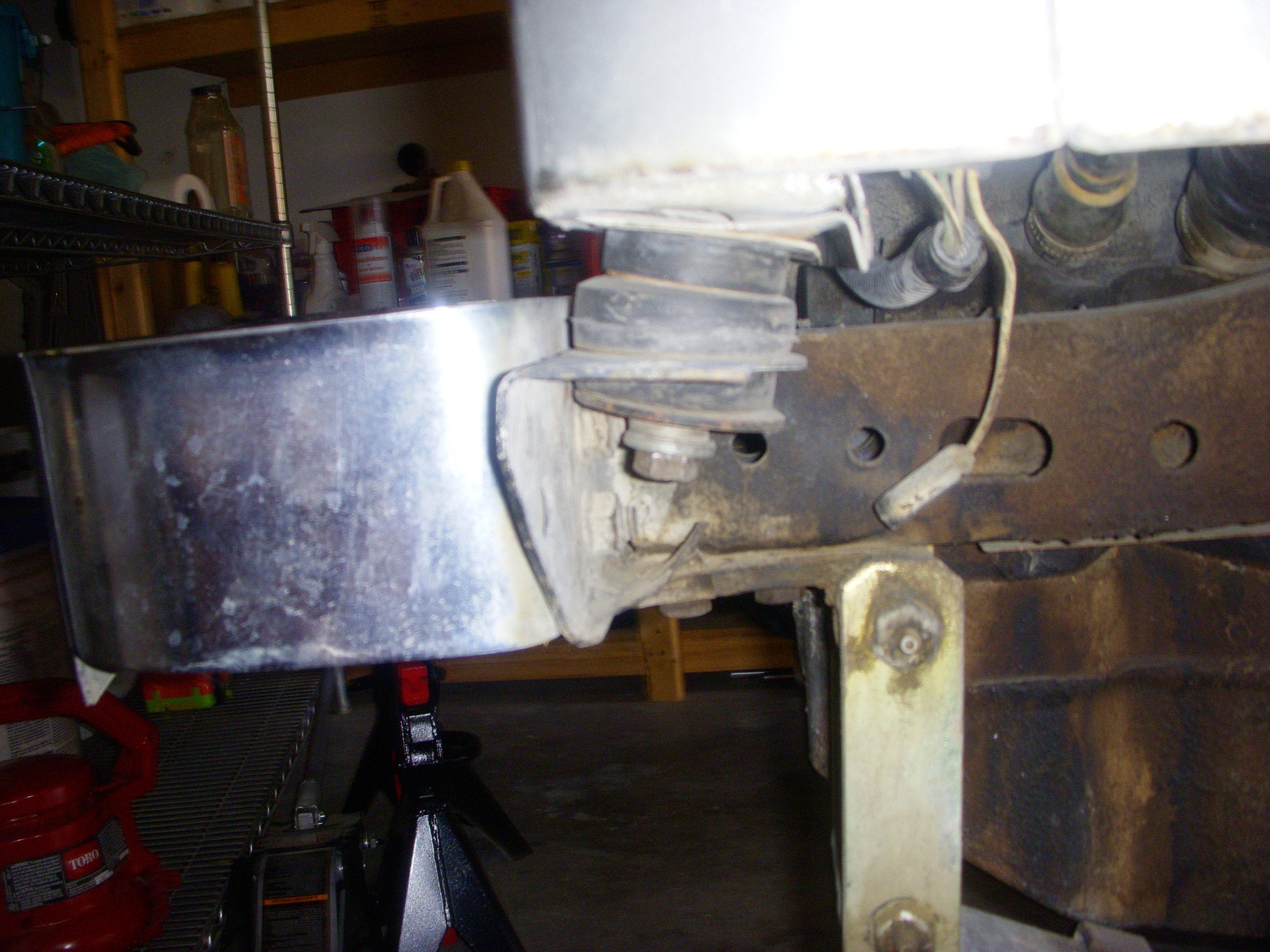

3rd... Passenger mount in front of wheel.

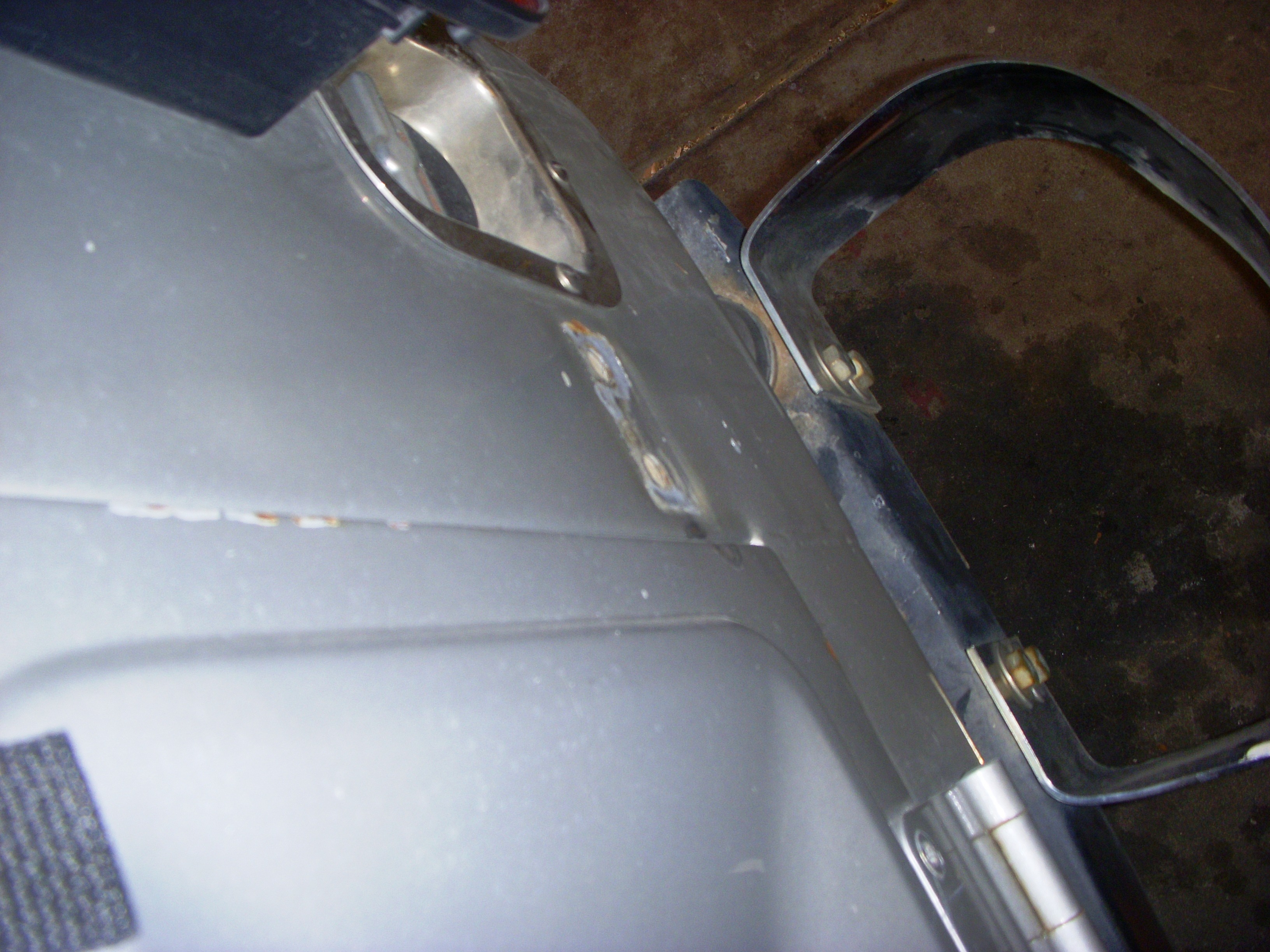

4th... passenger side body rear.
5th... drivers side body rear.

Wow! that is jacked.. That very well be why the Jeep looks like it was going down the road crooked. That body is definitely shifted from the frame. And a BIG WELCOME to you..

It looks like the bolts didn't get torqued down enough and slid the Body mounts around until they seated crooked and stayed that way. It's amazing how a little adjustment can go a long way. Definantly put new body mounts on and I'm with the rest of the guys. That should fix your problem. Good Luck and Great lookin CJ!

It's more likely to happen on the taller body lifts, as well as any body lift where the pucks are stacked. Stick with 1" max, and the body lift kits that replace the original body mounts so your new body lift is all one piece are a good idea.

Well the frame is bent. On Wednesday it goes on the rack and I will find out the damage. The drivers side has 1" body spacers. The passenger side had the makeshift body lift parts so the body sat straight. Never noticed it with the skinny tires on it.
I guess it is buyer beware. And the airman I bought it from seemed so honest. Said he built this with his Father and owned it for the past 10 years. I would have to think he knew the frame was bent, hopefully it is not to bad.

Well I should get the jeep back today or on Saturday. The estimate is 15-16 hours for the straightening of the frame. BTW it was 4" to 4-1/2" bent to the passengers side. See one of my first pics and now I can see it plain as day.
