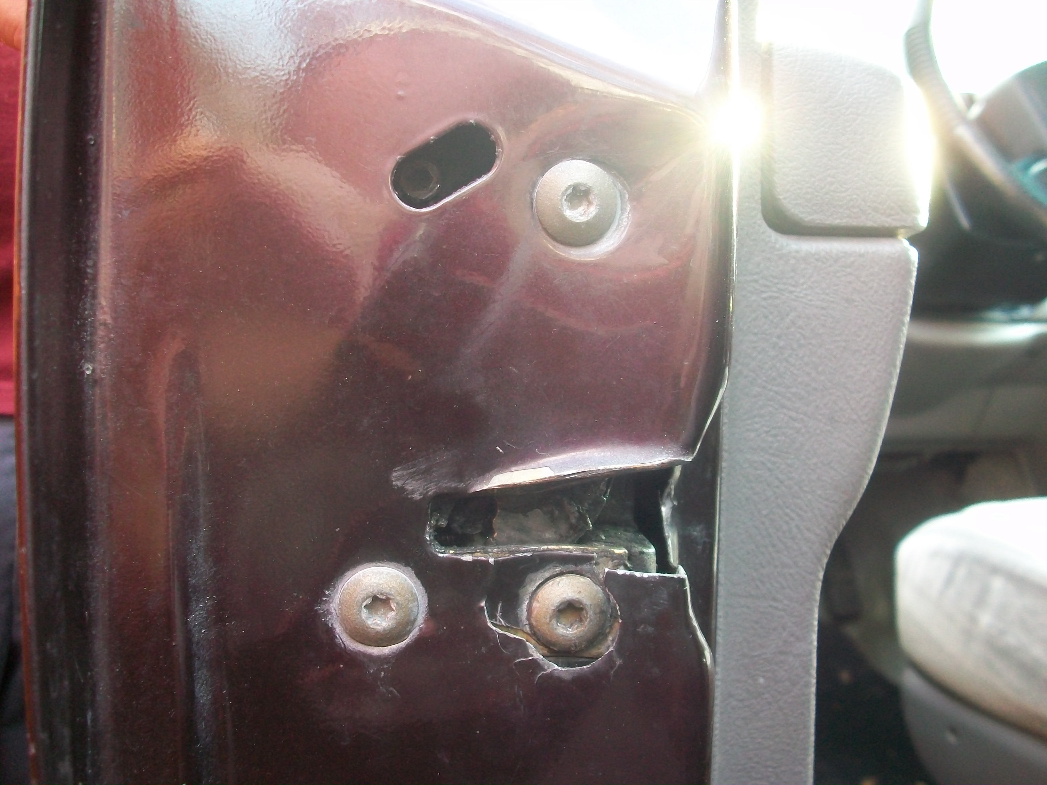

Here's a picture of the busted door latch mechanism. Apparently the up/down play in the door caused this to not hit the piece on the frame it should latch on squarely, this caused the bolts to loosen over time and the metal to start tearing away on the lower right bolt.
