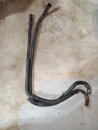

here is an ebay listing for the lines. they are used on all the xj right hand drive models, the right hand drive wrangler, and it looks like the right hand drive grand cherokee, too.
i geuss i can verify sometime since i have a right hand drive wrangler
Thanks superj. Great find. Definitely look like the real thing. I would be a bit reluctant to buy second hand ones because it is impossible to guess what condition they might be in.
on that valve....
those are on the left hand drive jeep cherokees, grand cherokees, and wranglers. they get brittle with age and break when you try and move the hose around a bit to do anything on that side of the engine. i think that is why its hard to find the rhd hoses, since it doesn't seem to be used on the rhd jeeps. i was going to comment on that valve and possibly using the lhd hoses last night but i forgot while i was searching before bed.
reading through more forum posts, it seems everyone has gone to the silicon lines, or used pieced together lines clamped to bits of copper pipe
That's how I'm getting by at the moment, bits of copper and Jubilee clips.
the part numbers don't search well with how they posted in the part i quoted from the other site. they have changed to the new style, though still work.
4637938 (supply)
55036801 (return)
they do return as discontinued though, as you noted earlier. they are on this page from oemparts online
