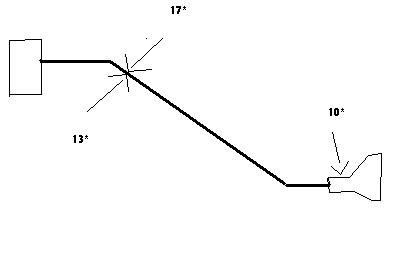

ok a very simple drawing of what and where i measured.

The top measurement does nothing for ya. The bottom measurement is only accurate if you're sure the diff housing above the pinion is perfectly flat and parallel with the pinion shaft beneath it.
I recommend placing your anglefinder on the ear of the slipyoke, right above the ujoint cup retaining clip. Make sure the ear of the slipyoke is on top of the tailshaft. Then do the same for the yoke attached to the pinion.
You need to do whatever is necessary to find the angle of the transfer case mainshaft (same as rear output) and the angle of the rear pinion shaft. These are the two that need to be as close to parallel as possible. Then we'll worry about getting that slipyoke far enough onto the tailshaft.

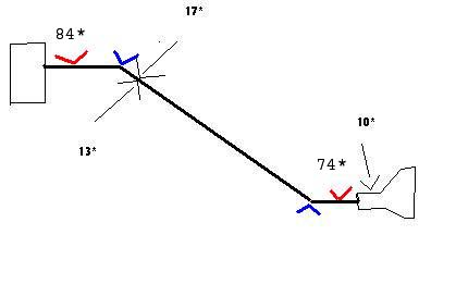

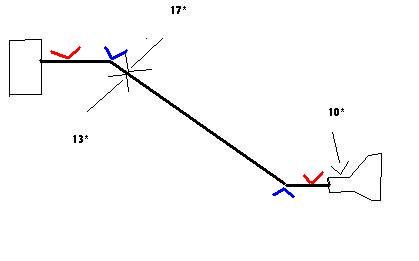

so is the red what you are talking about or the blue? LOL
Measure the angle of the red.

ok Igot 74* on the output on the axle and 84* on the TC output shaft. jsut out of courisoty what are the stock specs?

Just wondering, but it's 74* and 84* to what? if it's to being at 0* (horizontal) then your transfercase and transmission and engine would be sticking almost straight up in the air. And your diff. pinion would be pointing almost straight up too.
Are you sure it's not 6* for the t-case output shaft and 16* for your diff. output shaft??
I can't tell you the shims that you need, just trying to figure out the angles so someone else can help you.

that is jsut what I read on the angle finder thingy!! he he
i assume it would be angled to 90* (seings how the patrs are so close to a horizontal line.) I believe in your description you were thinking of a vertical line. so back to math class here!! subtraction, how do i do that stuff again?? LOL (J/K)
90-84 (for tc) =6* differnece between level
90-74(for axle)=16* difference between level
difference between the two is 10* but i dont think it will be that easy. maybe by cutting that number in half (10/2=5) meaning that I would need a 4-6* angle diffreence in the rear to properly adjust the pinion angles? MAYBE?? im lost in my own thinking again!! LMAO
