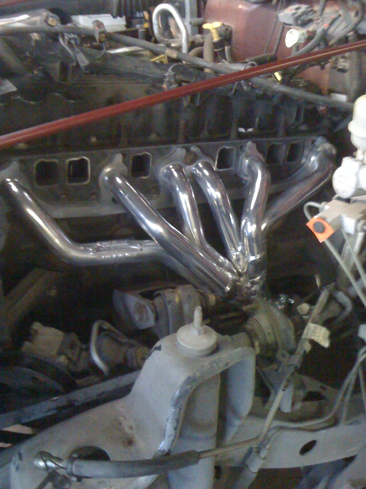

Here's an Edelbrock headers. It's sounds good paired with a flowmaster mufflers.
