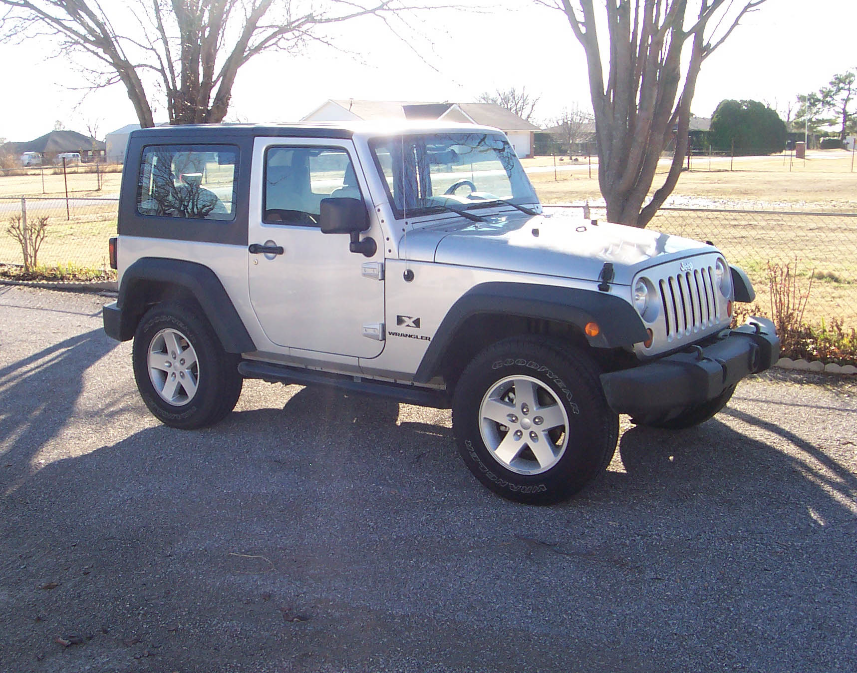

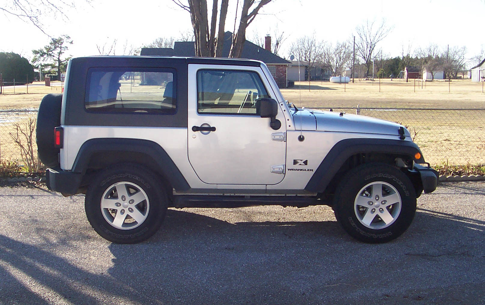

I have a 08 JK. I'm not gonna be rock crawlin, mainly mud and sand. My questio, I have the stock 255/75R17's on it, what is the largest tire (width & height) I can mount using the stock wheels and without lifting (or w/ minimal lifting). Thanks.

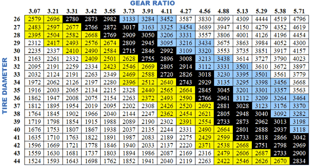

Ok a newbie question for you. I will be going from 30" to 32" after a 2.5" lift what gear ratio should I be looking at hoping I'm ok with stock/

Your going to loose some power going to a bigger tire, this chart should show you what gears to tire size you need. its in RPM's with stock 'jeep' transmissions, based on I6 motors.
Yellow is low torque, black its near stock, and blue is for higher torque.
For a daily driver try to stay in the black.

That chart would work well for any motor.
I wouldn't worry about the color, just find where your stock gear ratio and tire size intersect. Then find the tire size you want to run and move to the right until you find a similar RPM. That gear ratio will get performance back close to stock.

That RPM chart. Is that engine RPM, at what speed? I'm asking, because I've got 31's, and to get 2163 RPM, I'd have to be going about 80! I don't think the YJ can run that fast! Lol.
But it would be 2483 with your stock tire size of 27". It doesn't matter what transmission or what speed, it's all relative when using your stock tire height and gear ratio as a baseline.

I realize it's all 'relative'. Just asking because the chart states it's for a I-6 with stock trans. That's what I got, but just saying, at 60 mph, 5th gear, I'm reving at a max of around 1500. Not that it makes a difference. I understand I can use the chart, using math.
