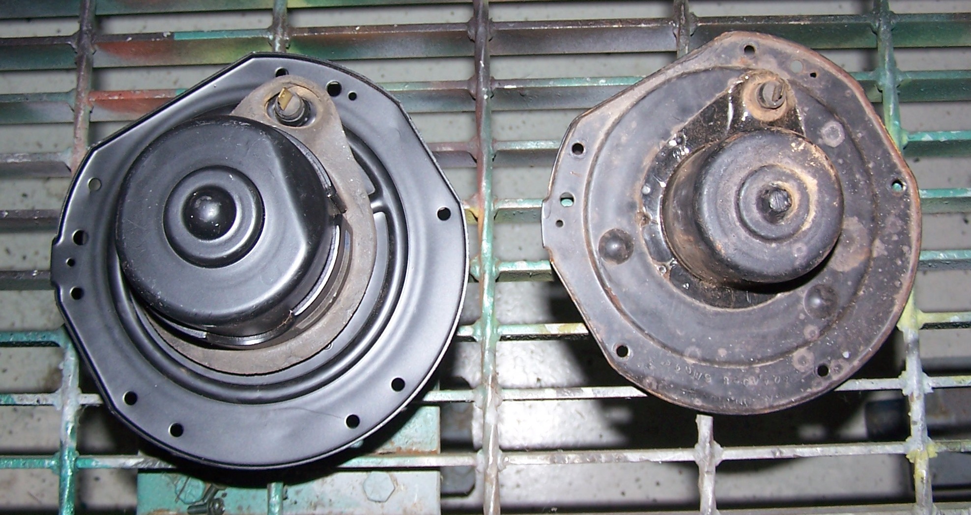

AHA! Finally found a pic of the correct motor. Note the motor on the left is physically larger unlike the VDO Made in China unit I looked at;
Now my photo of the Made in China VDO unit (Note the motor itself is the same size)

Last night I took the 3 1/4" hole saw (I have no calipers at home) and it fit snugly into the existing hole. :redface: This tells me that a P.O. likely tried this upgrade before with a substandard blower motor, the label was painted over and even acetone didn't work to reveal where this existing fan came from. Notwithstanding, I have a new Made in The Great White North arriving today so I'll install and see where I stand. In the meantime I have a new aluminum jig prepared mentioned on the Terry Howe page so if anyone is interested for the cost of postage, I can mail this to you for your upgrade.

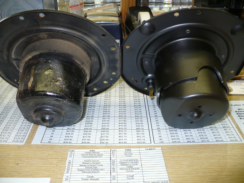

Okay gang, got the 4 Seasons motor and it's configured like the one on the right;
and while the relief for the motor on the left is 3 1/4" (firewall hole) the one on the left has that steel collar, lacking a set of calipers does anyone know the dimension of this type of motor with the steel collar?

Got the hole hogged out last night despite this head cold, used the aluminum jig as described in the article but, given the nature of the only metal hole saw I could find, the jig broke just as the saw was beginning to bite. Luckily it had scored the metal enough to see where I had to grind relief, so got out my trusty Dremel (I've used this thing on the Jeep more times than I can remember) with a titanium cutting/gringing bit and ground the relief in about 10 minutes. Smoothed out with a half round file. Today at work, if I'm up to it during my lunch I'll be installing the "Made in China" heater core and Made in Canada blower motor and seal it all up. Will keep everyone posted.
