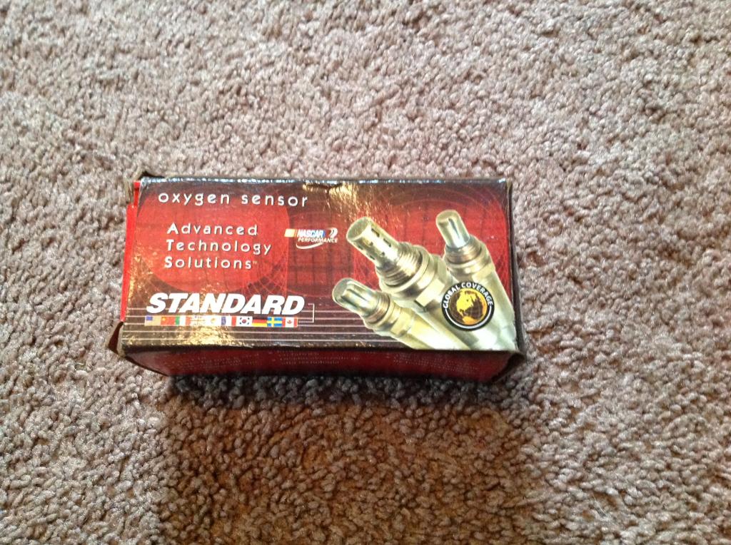

update: ran the jeep on the interstate. It did not buck, hesitate, or sputter out of the parking lot, pulling on to the main road or merging onto the interstate. It is running rich as I can smell it when I let off the throttle and when stopped the RPM is around 1100. The O2 sensor i put in in the pic below. The other pic is the original i pulled out

Is it just me or are all the pics the same?
what BRAND O2 sensor is it? this actually may be the answer you seek... Bosh sensors are notorious for creating issues... and they are the mfg of most if not all "house brand" sensors. Stick with NGK/NTK for reliability

If you look back a few posts he shows an image. I believe he stated he got them off ebay.
Oh I looked back it was Az.
UPDATE: Ran the Jeep to work this morning. The CEL was on due to the O2 being unhooked. The jeep was running at high RMPs (1500-2000) just at idle in Neutral. I stopped the jeep and reset the DTC just to clear the CEL. Started the jeep back up (O2 still unhooked) and the jeep ran fine until the CEL lit up again. It looks like the PCM runs a "normal" open loop until it expects the O2 sensor to be operating. Once it doesn't provide data to the PCM, the PCM will go into a default open loop (the scanner showed the system was in OPEN2 mode vs the OPEN mode during regular warm-up). It appears the issue is the O2 sensor. Now I'm trying to determine if the issue lies in the wire harness or the sensor itself
I contacted the seller on EBay and advised them the SMP sensor does not work with the Wrangler. They said due to the issue with the sensor, they will ship me a NTK sensor to replace the SMP (plus a mailing label to return the SMP)......... update to come
