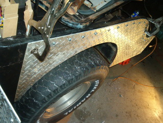

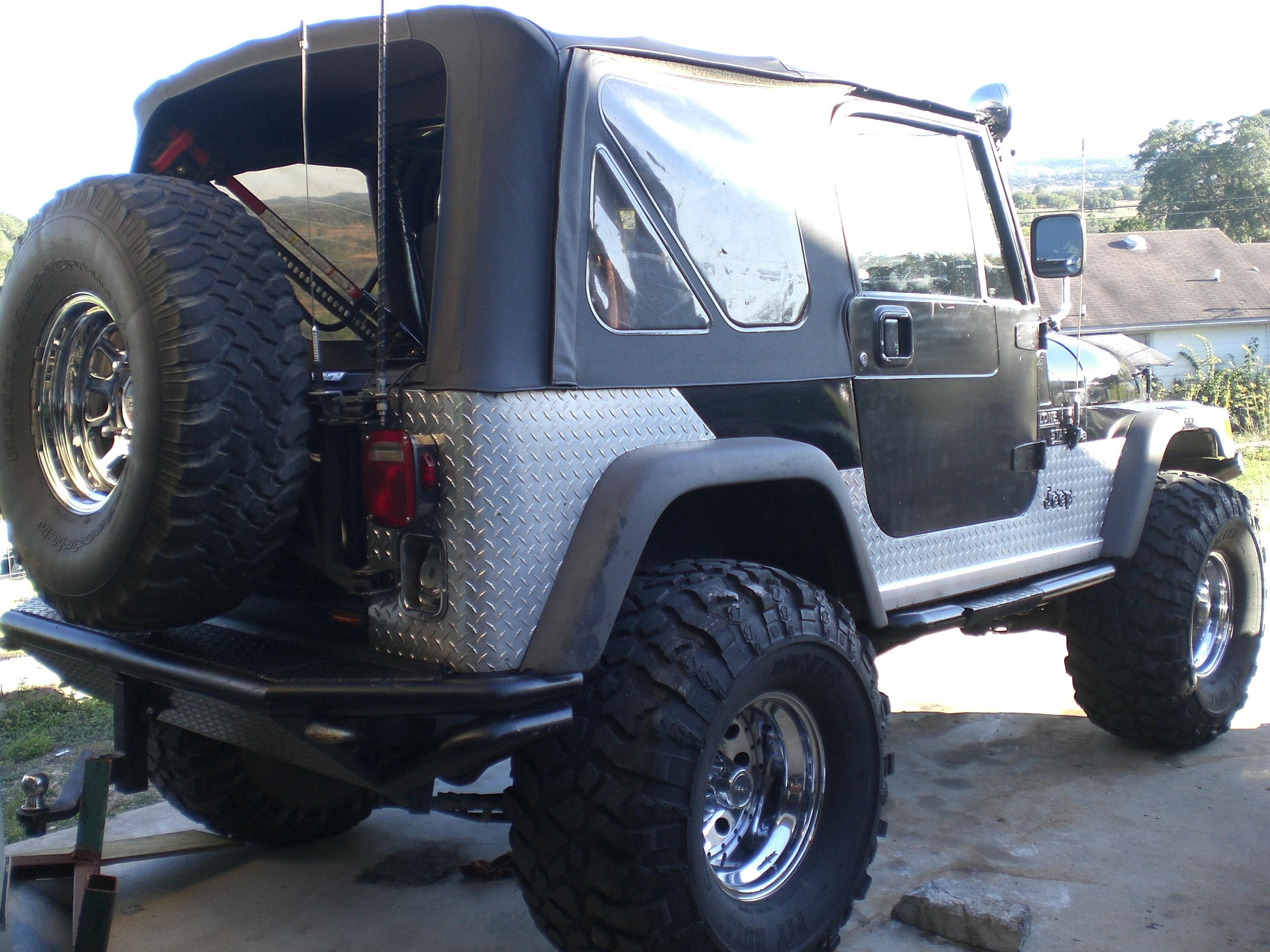

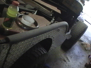

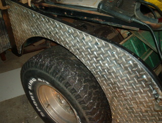

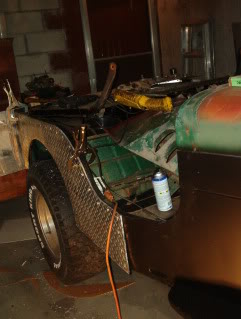

I did Full body armor 1/4 inch alum diamond plate

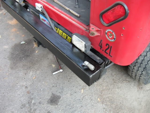

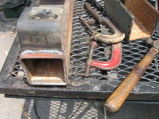

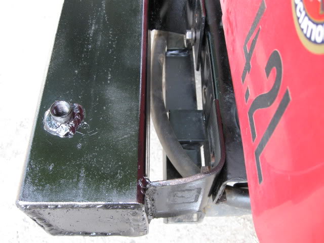

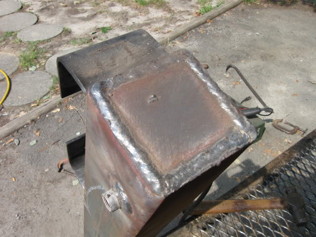

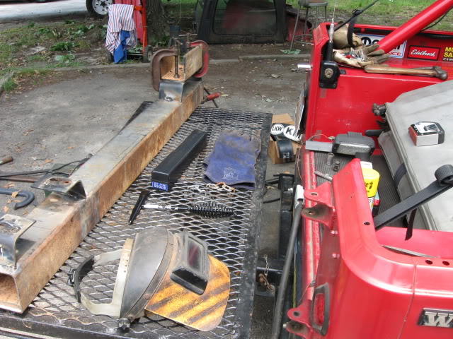

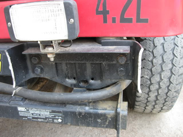

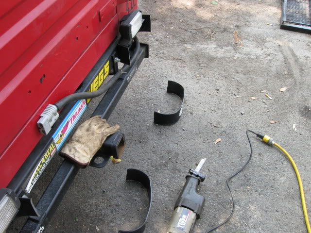

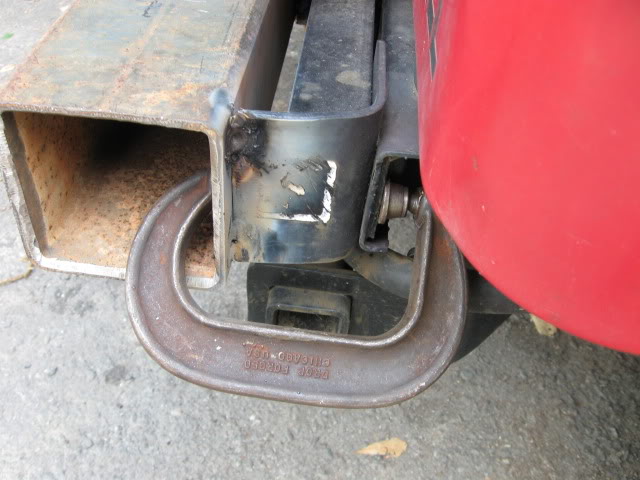

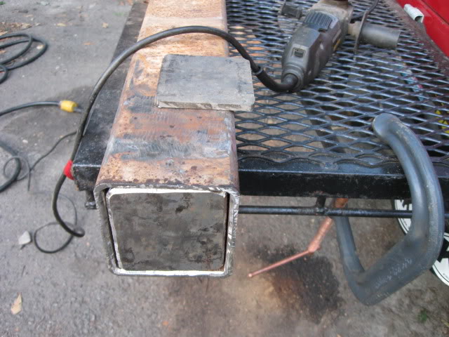

I cut most of my bumprettes off & welded a square tube to them with my 220 amp on board alternator welder. I capped it off, & welded some half couplings in . Now it's an air tank for my York OBA!
I am an experienced (Certified) welder, & anyone doing this type of pressure vessel welding should have knowledge of what it takes to make one safely!
NEVER DRIVE ON THE ROAD WITH PRESSURE IN THE TANK! Get rear ended & it might explode!
I have the draincock to let out the air after I'm done using it.

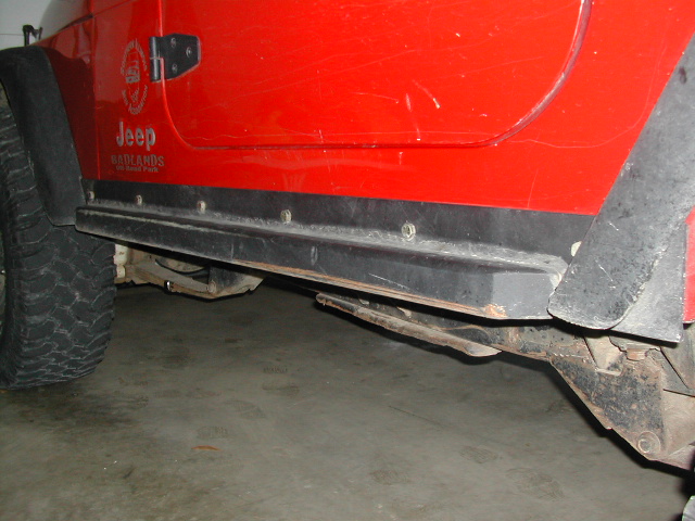

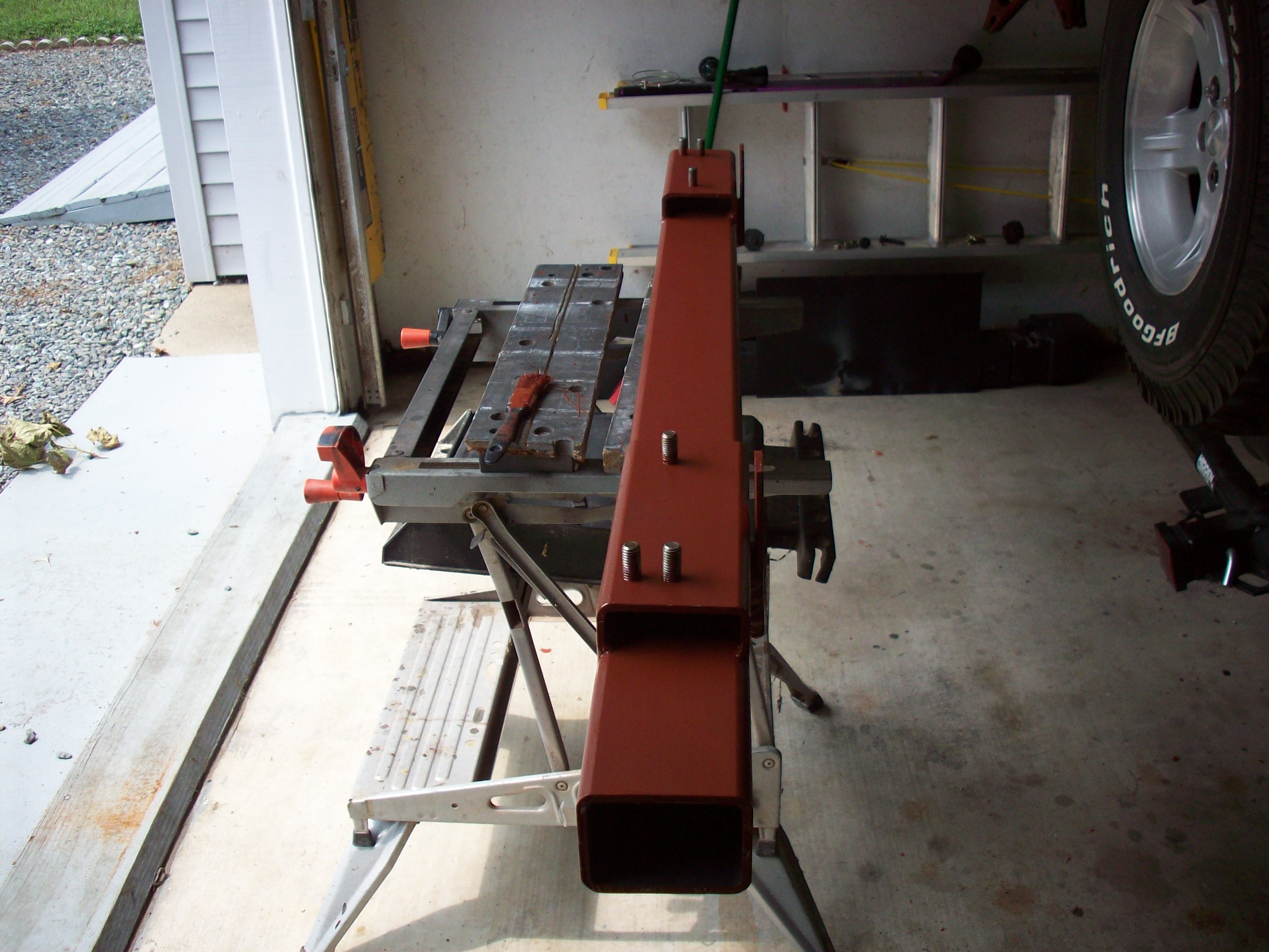

Homemade rocker protection, 4"x4"x.25" angle with a 2"x2" tube added as a stand-off, makes for a 6" skid on the bottom.

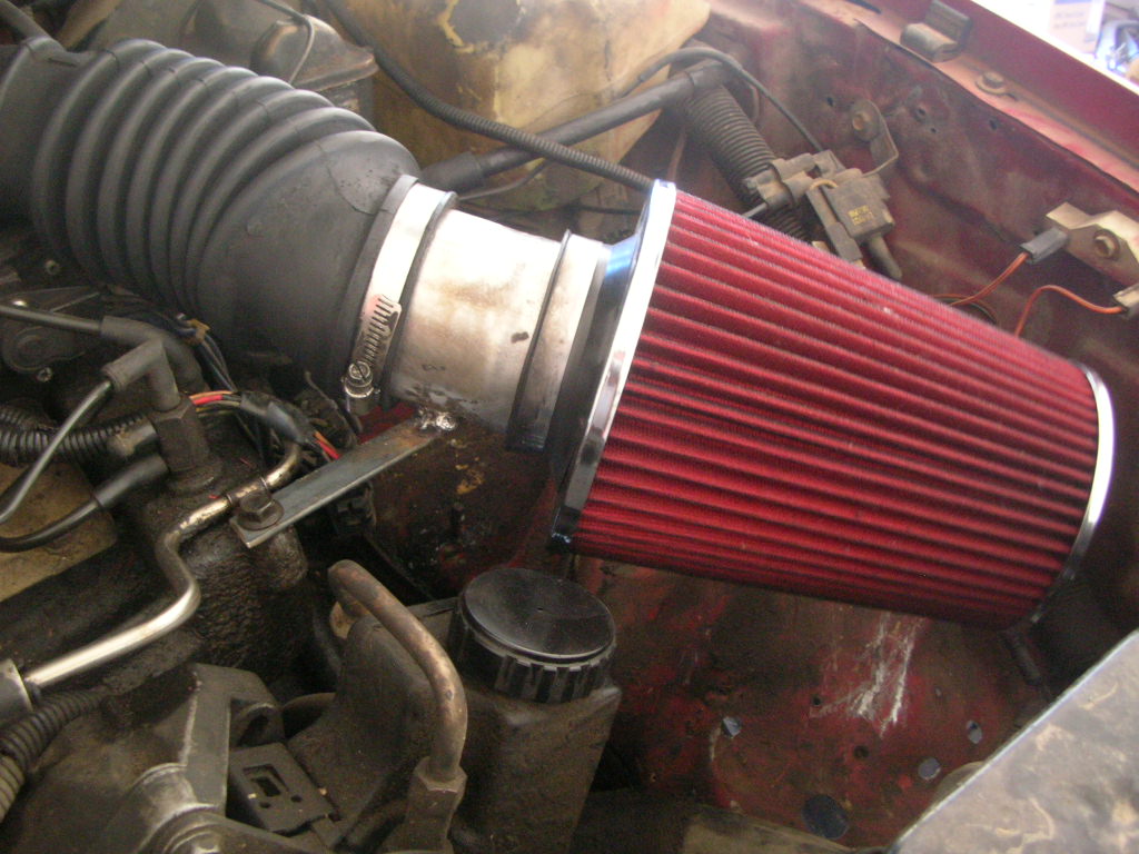

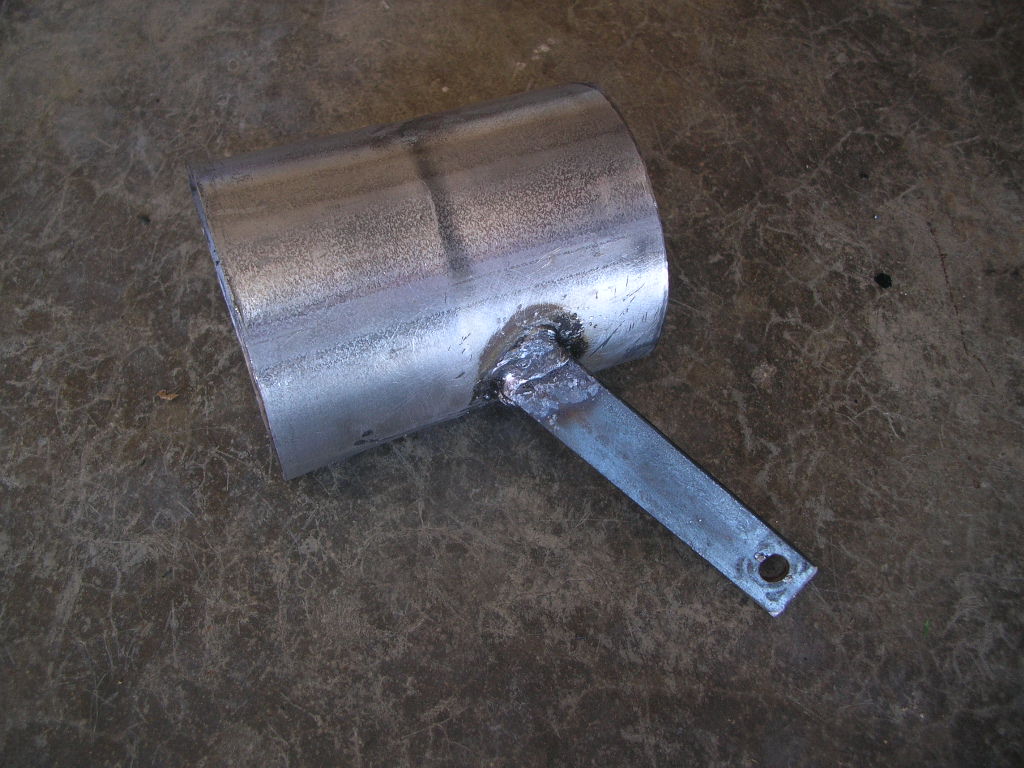

Piece of exhaust tubing, one end expanded to fit intake tube and other end expanded to fit conical filter. Metal bracket for attachment and high-flow intake is done.

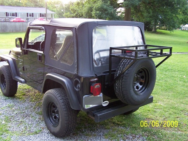

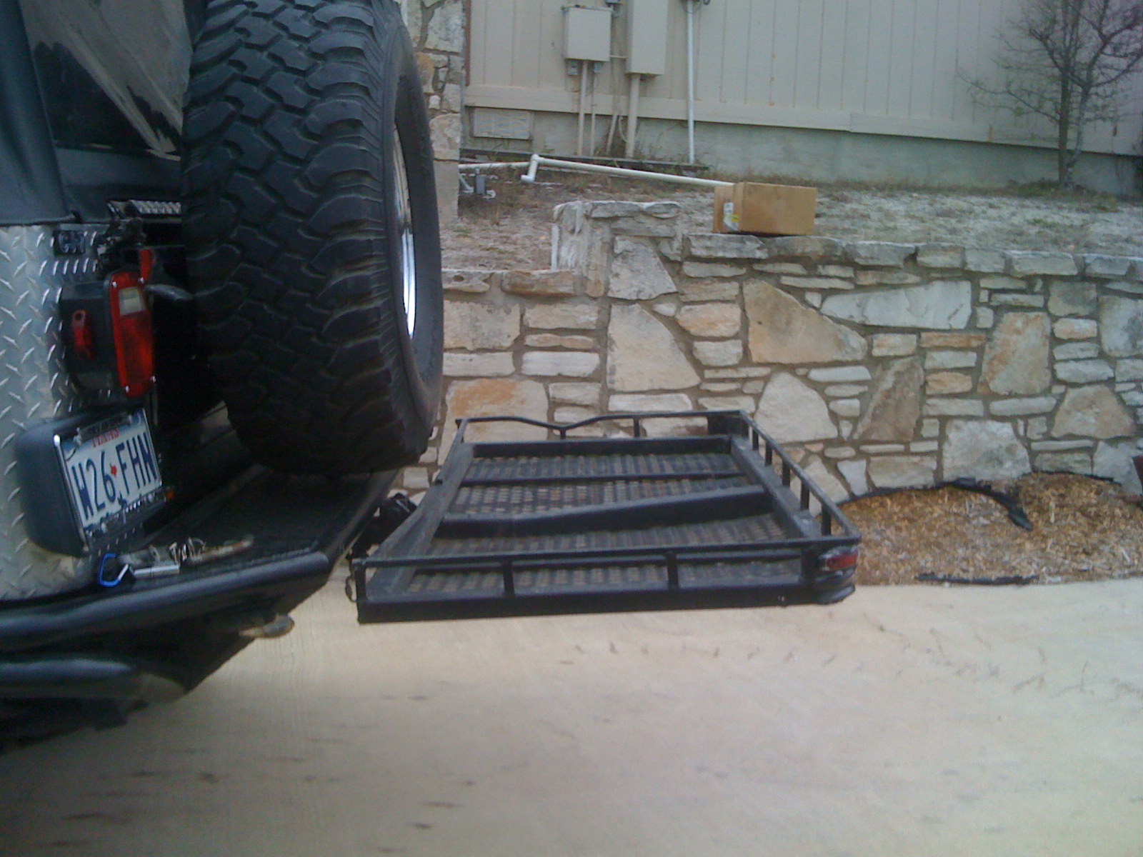

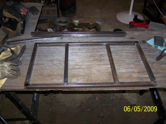

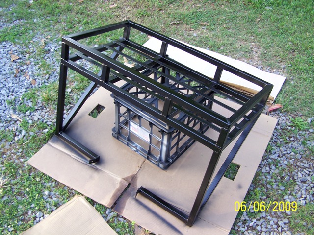

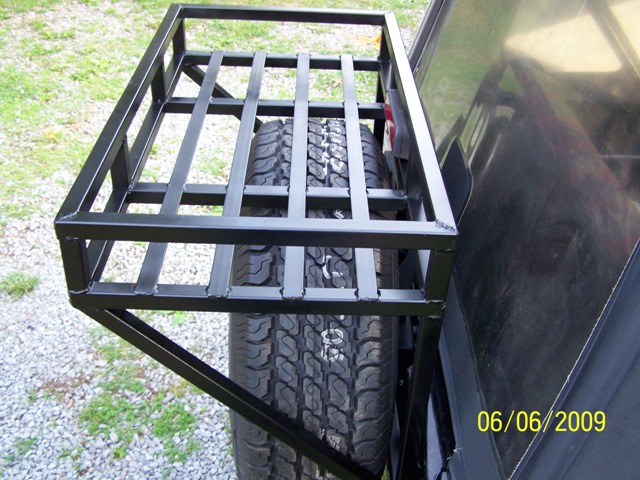

I fab'd up a homemade Rock Rack to carry odds and ends. Worked out great!

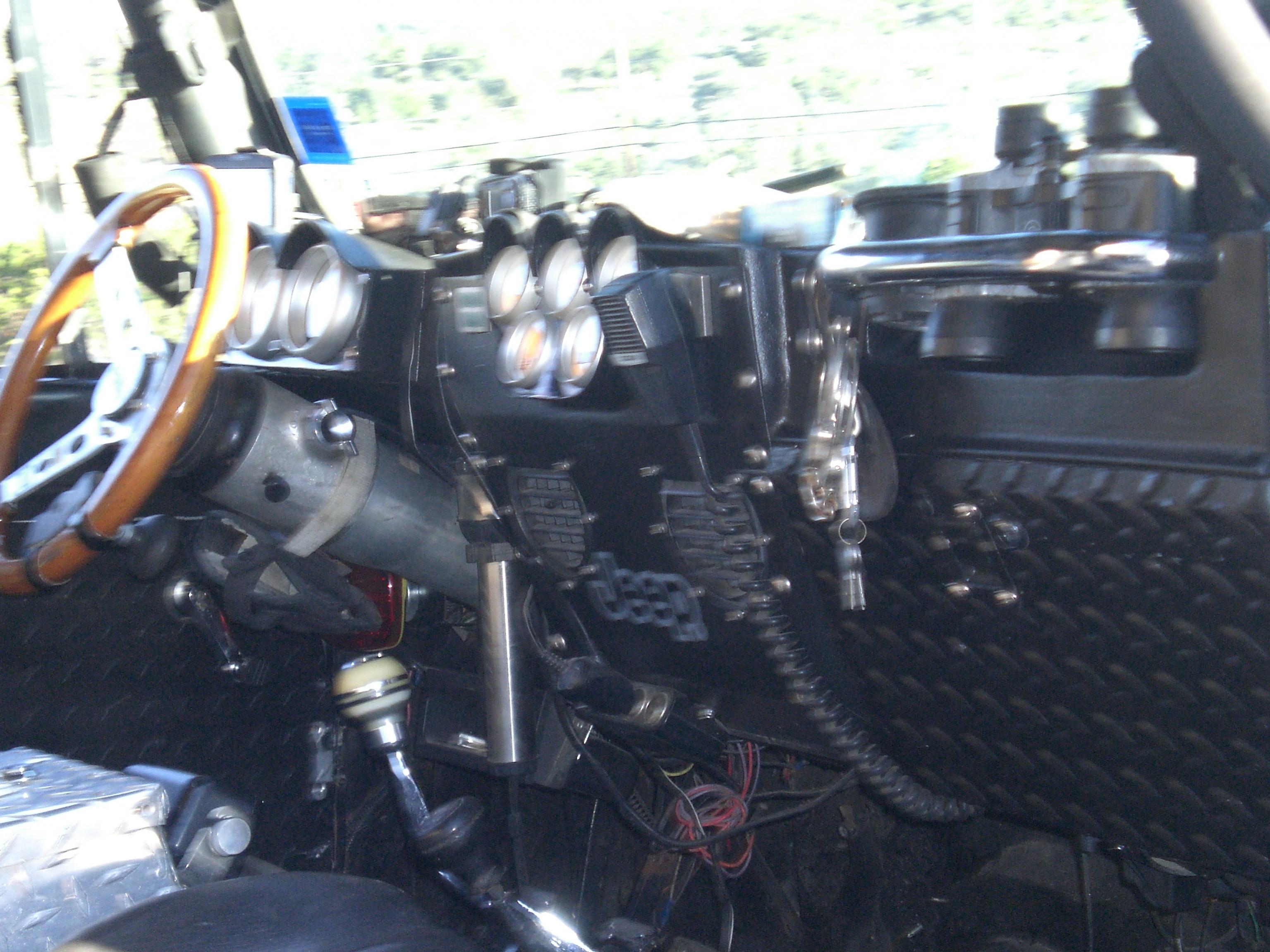

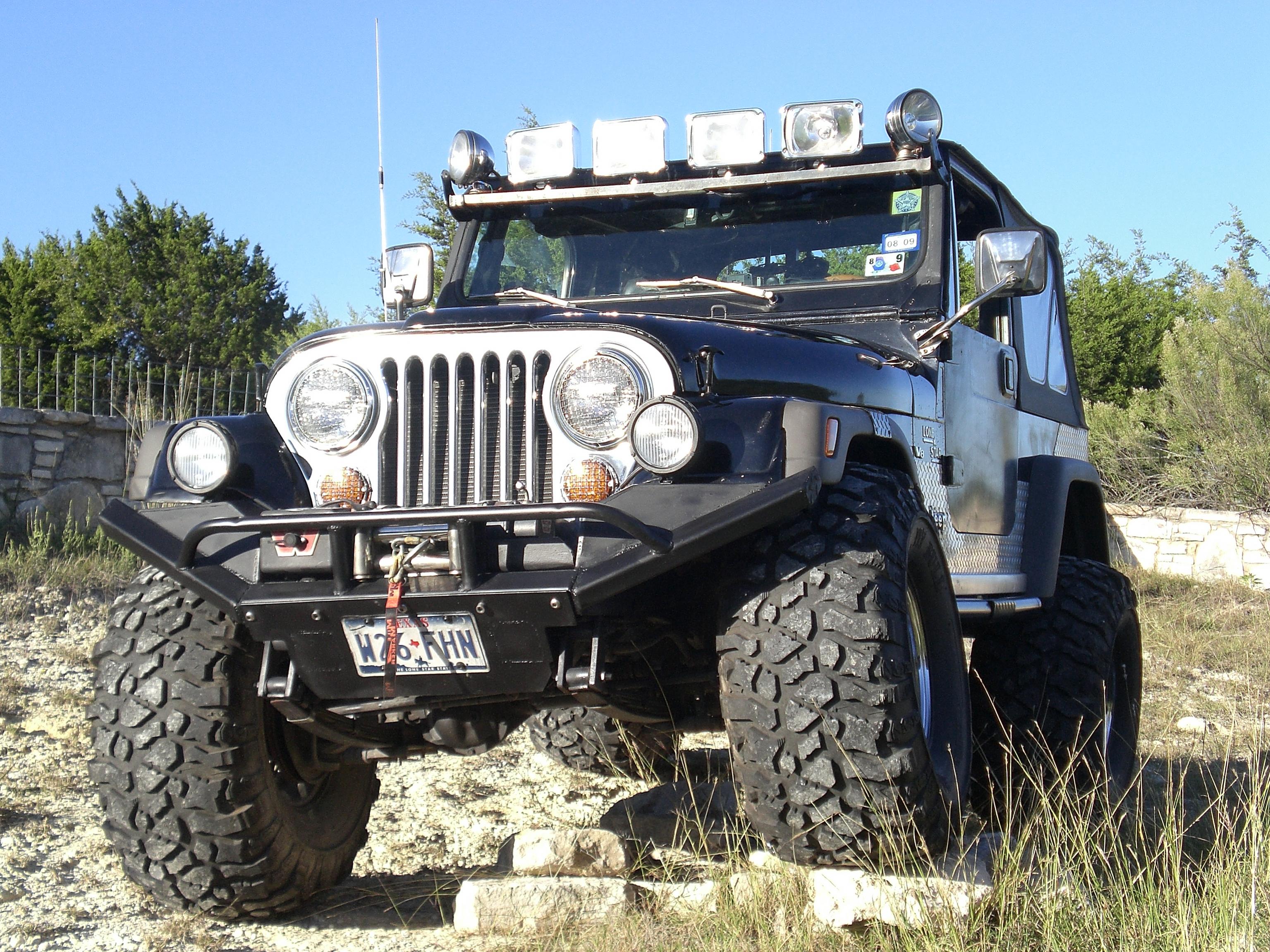

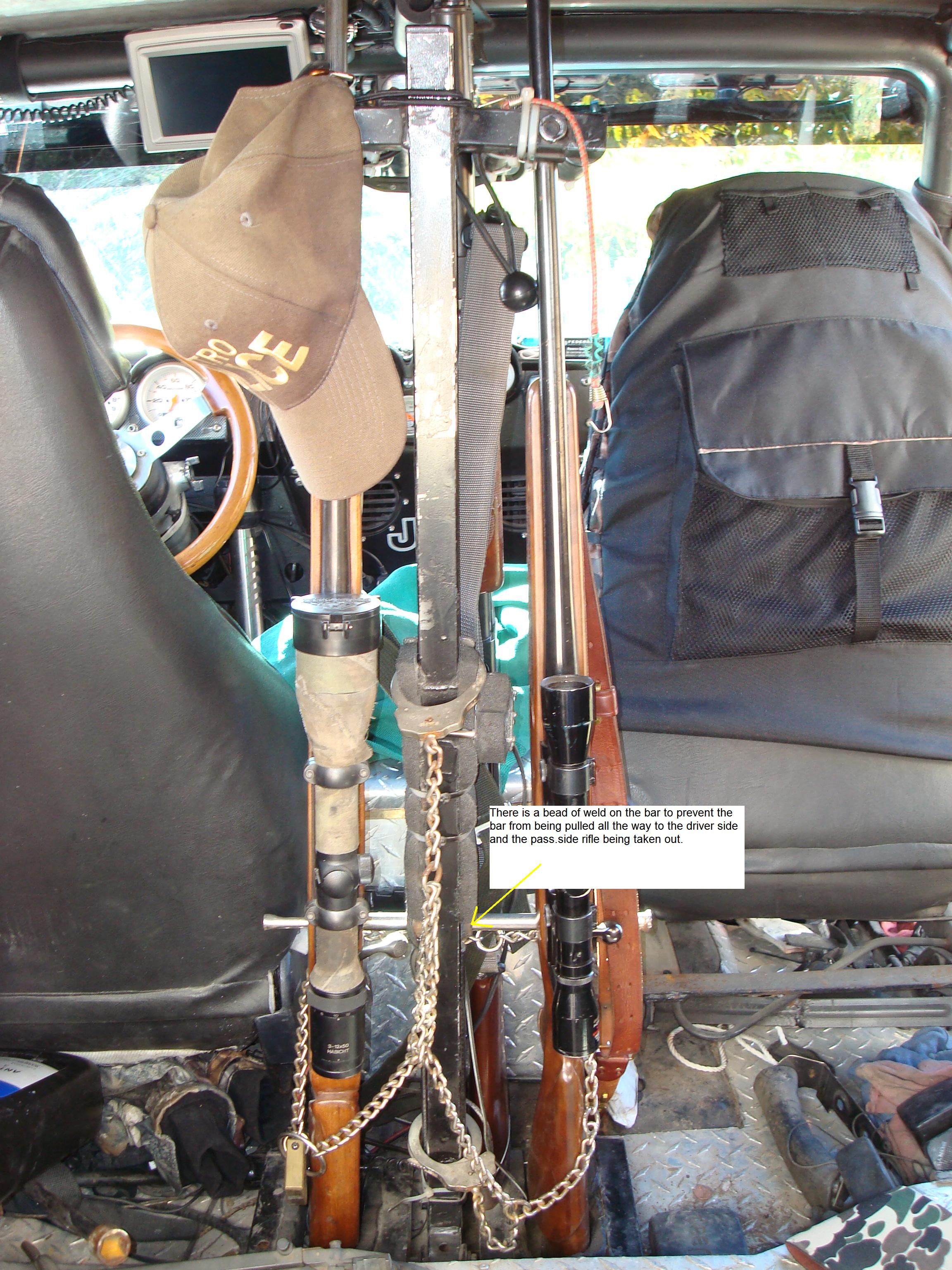

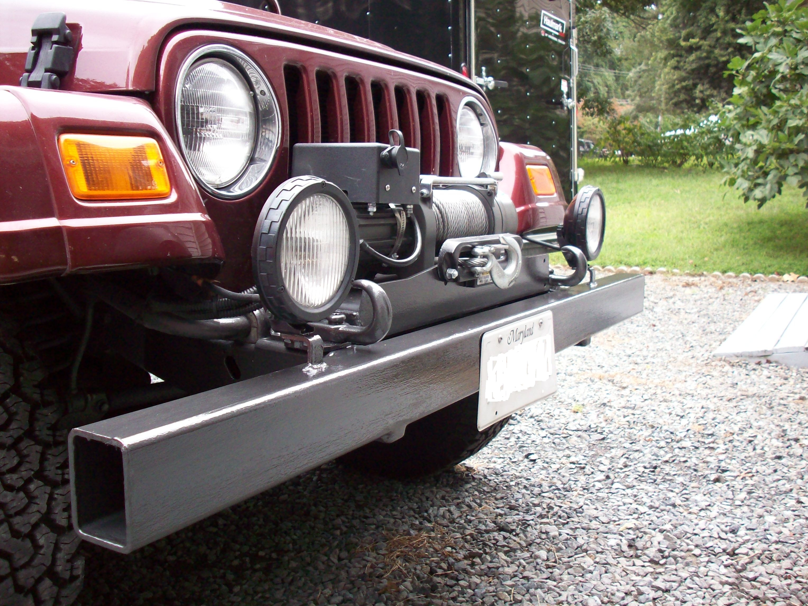

Home grown fabrications. Left top, Rifle Rack. Holds 3 rifles. Top middle, Built the Light bar and the front bumber with a winch plate. Top right, Custom dash board with a locking glove box that houses the radio, cb and pistol safe. water proof. Bottom left , Rear bumper with a hidden locking recovery box, nurf bars corner/ side armour, heavy duty tire carrier. Bottom middle, Folding game carrier.

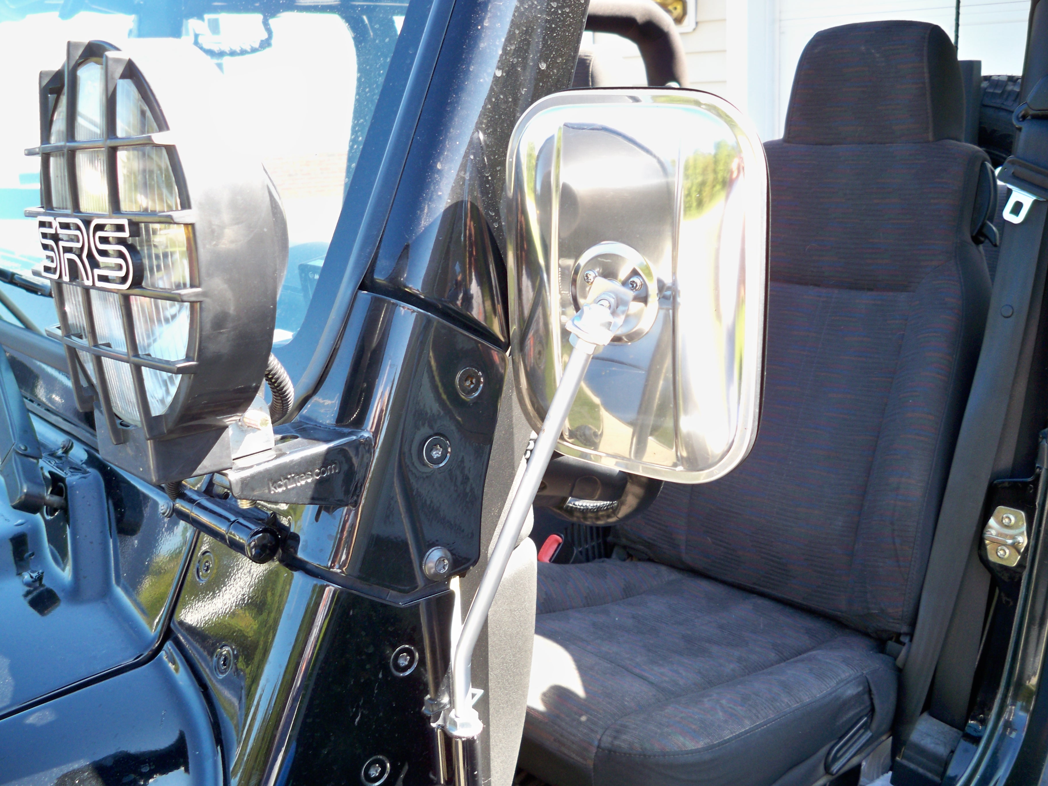

Okay, here is pics of my homemade mods.
First is morrors so I could go doorless. I have about $20 bucks in making them.

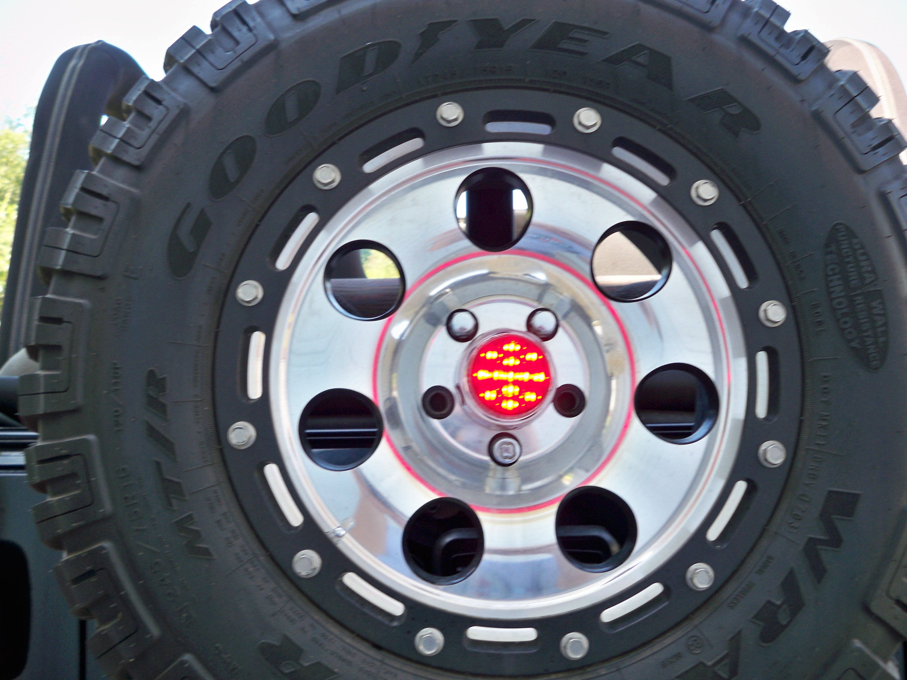

Next is my thrid brake light.
Side veiw.
Lights off!
Lights on!

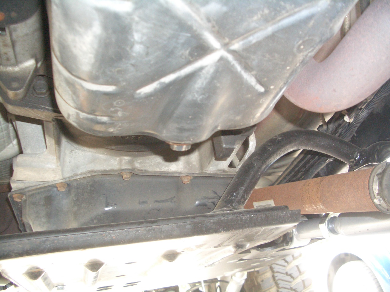

I made a trans. skid plate from the orig. one with some 1 1/2" tubing bent to clear the front drive shaft, just some slight mods and it works great. I have a rubicon express 5.5" long arm lift.

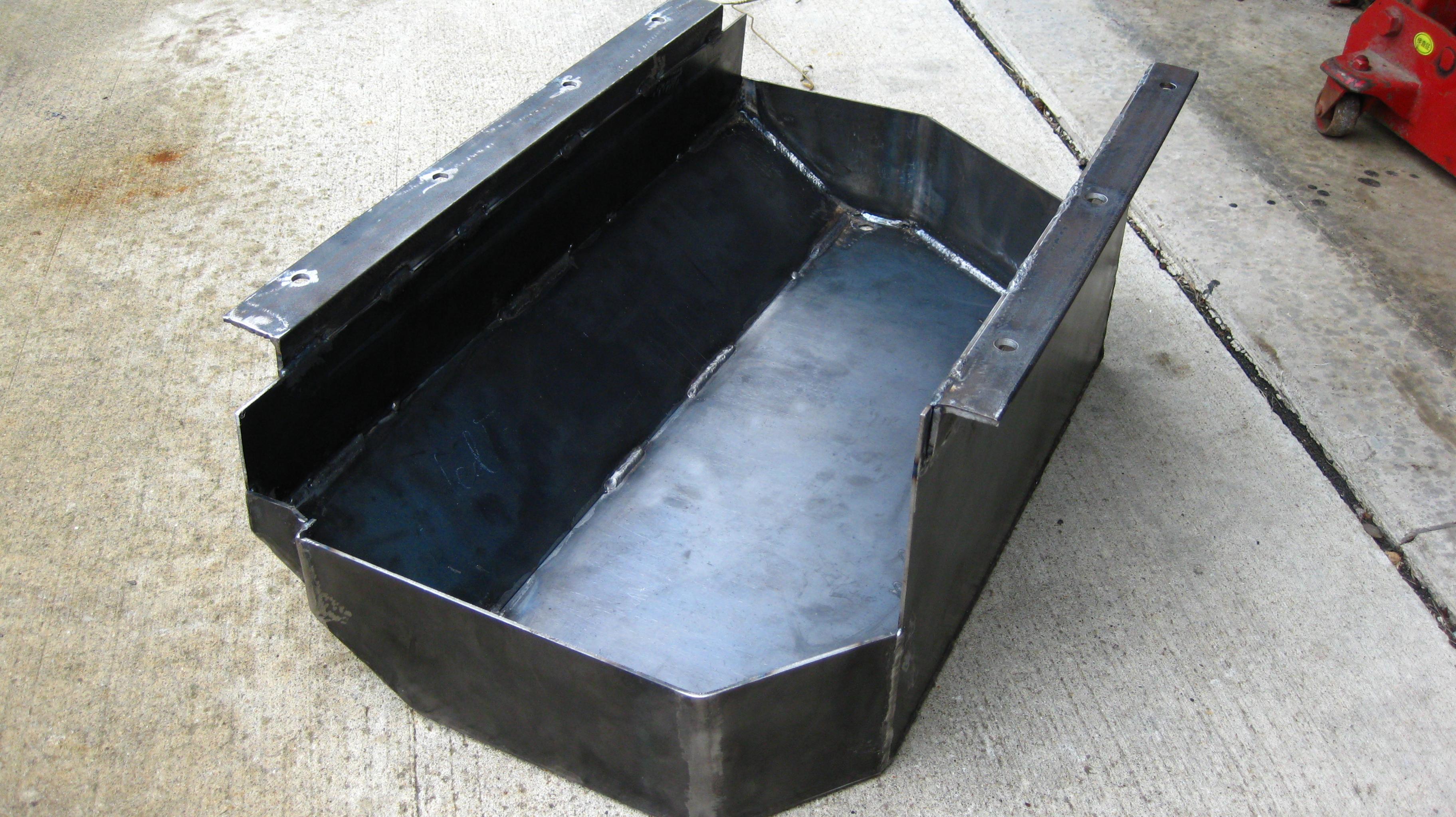

I made this. It's a monstrous tank shroud for my 20 gallon tank. I've made a group of other things. I'll post more pictures later.
My next project will be a stubby front bumper. That will be fun... :roll:

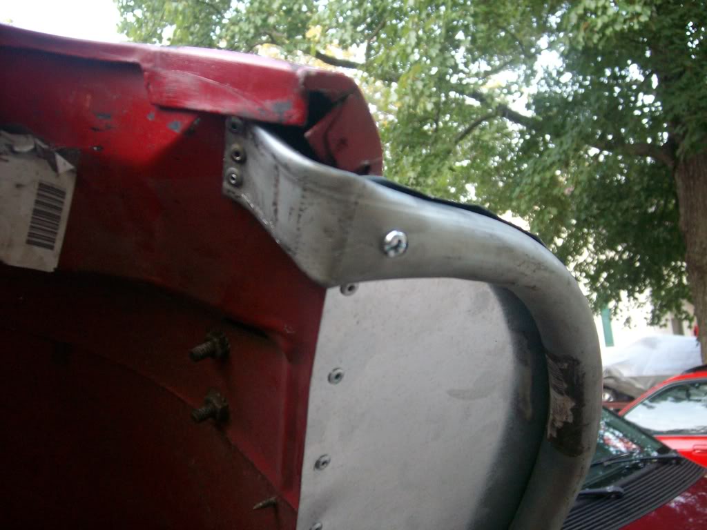

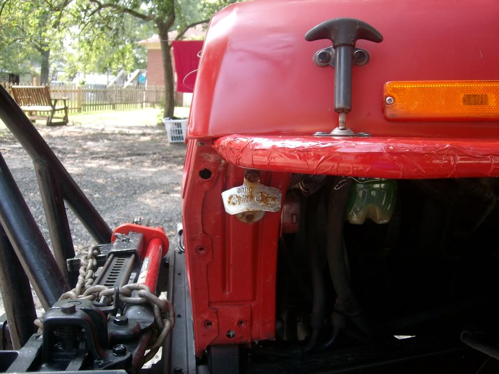

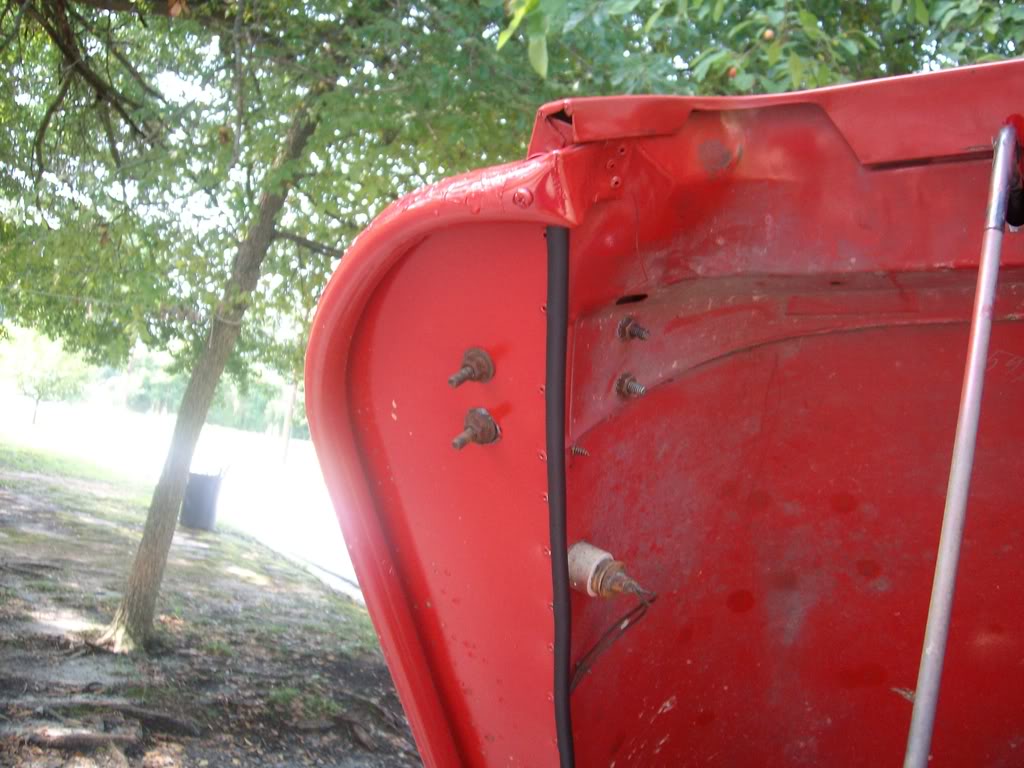

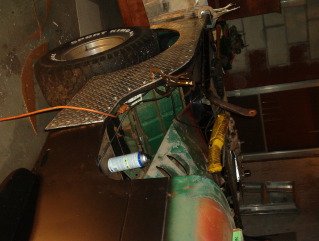

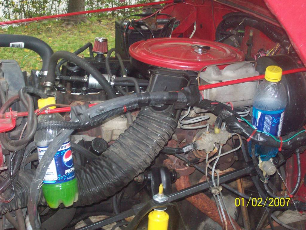

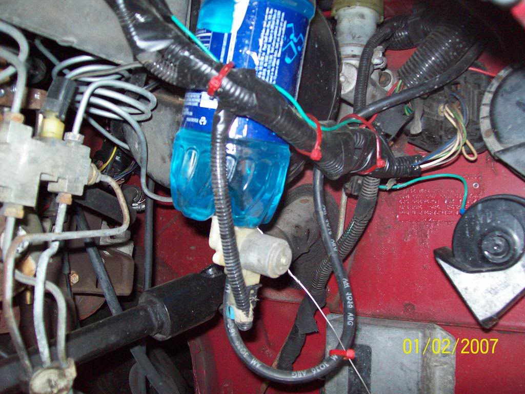

Here's another one, I removed my front fenders to fab some hood mounted ones. (3/4' EMT conduit & ductwork sheetmetal)
I even moved the marker lights to the hood.
The duraspark box got mounted just above the charcoal can on the firewall.

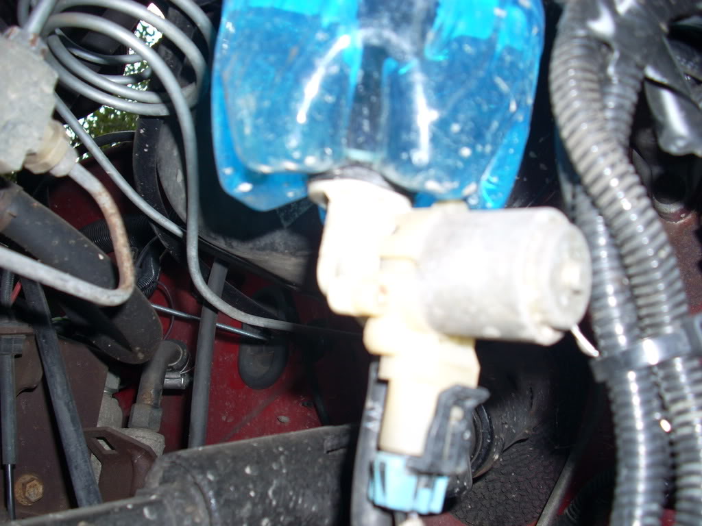

Problem, what to do with the coolant & windshield washer (WW) reservoirs?
Pepsi big slam bottles have just enough volume, & the big mouth opening just fits a 3/8 drive 13/16" spark plug socket.(be sure to remove the rubber insert, or you'll crush the filter)
That socket is the size of the screen filter in the stock WW tank. This filter releases the pump when turned counterclockwise.
The pump fits perfectly inside the base of the soda bottle, & they've been working nicely for two years now!

I got a few really small overflow bottles and also a few real small wiper fluid reservoirs got to look better than pepsi bottles LMFAO Ill let them go cheap
Well thanks for the offer, but I'm trying for a certain motif.
Gotta let my redneck freak flag fly!:D

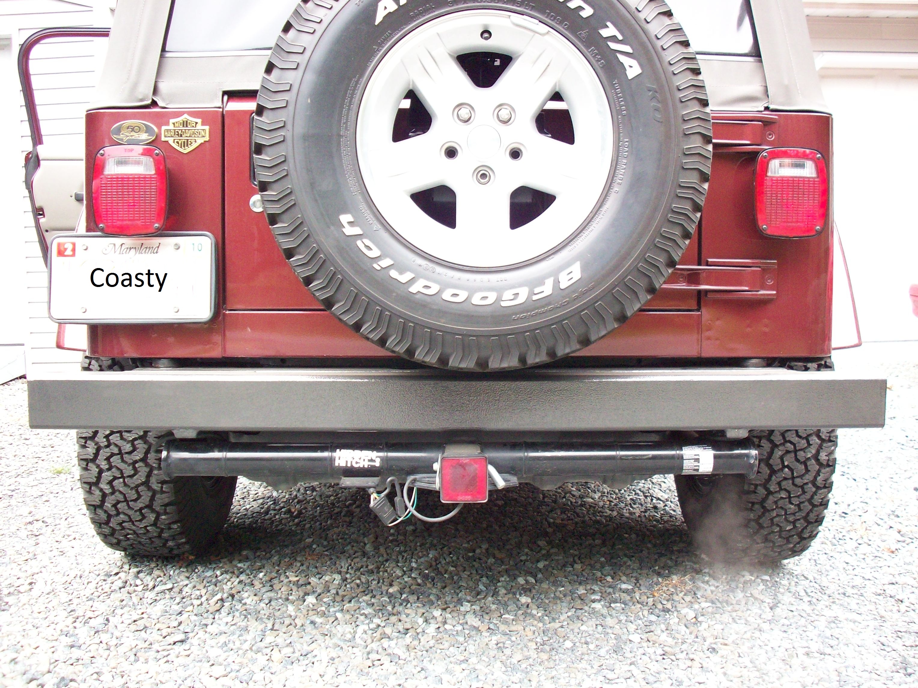

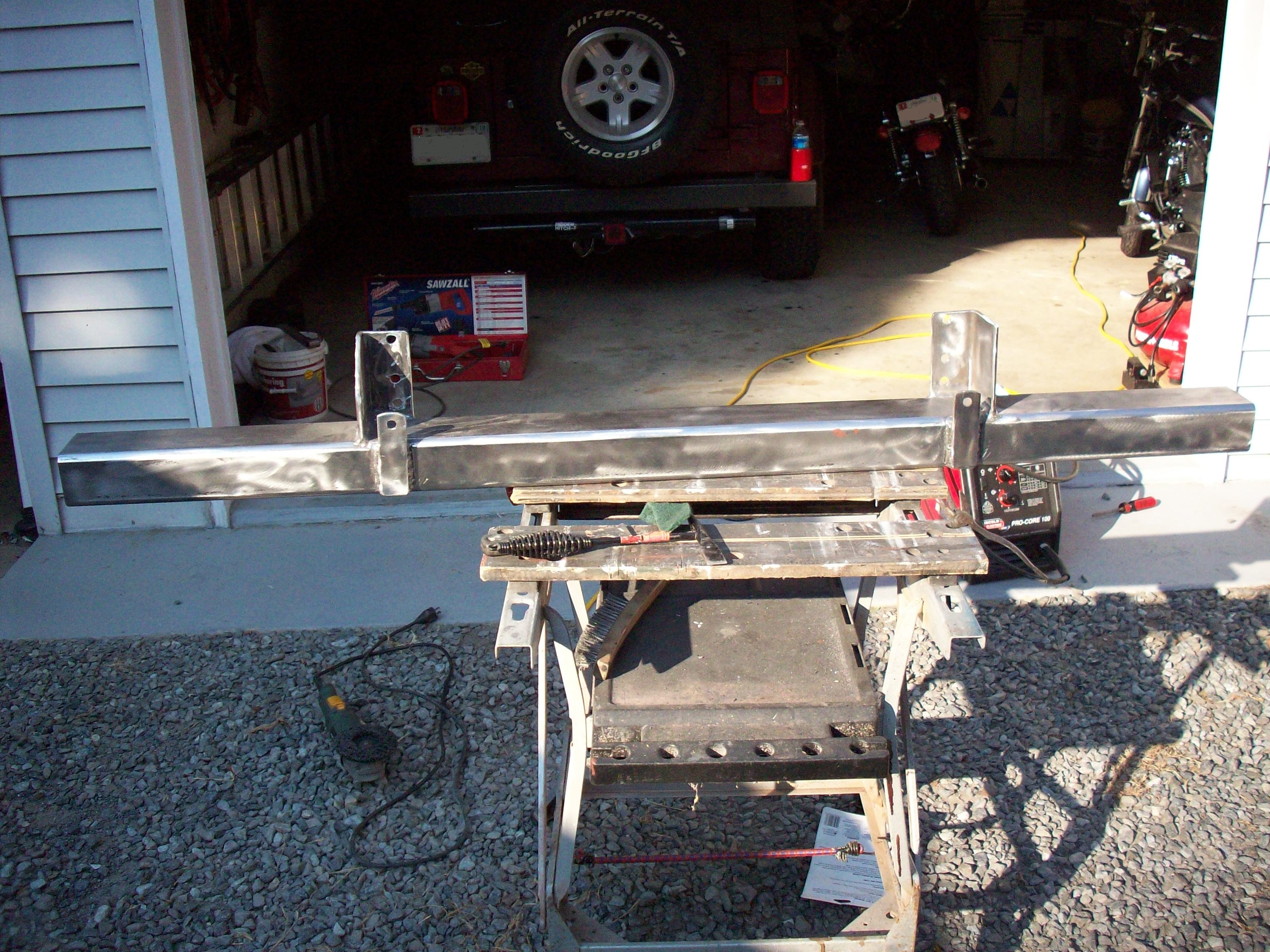

Recelent fabricated front and rear bumpers
Yeah, he must have stock in PEPSI!!
But he can`t be a true redneck, because I didn`t see any duct tape
under the hood. :funny:
One thing is for sure, the bottle opener could come in handy at the
:cookout: or :party:!!!

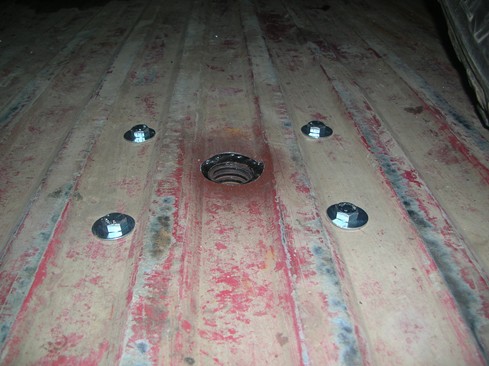

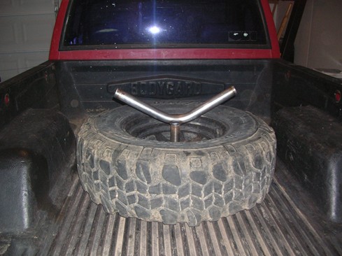

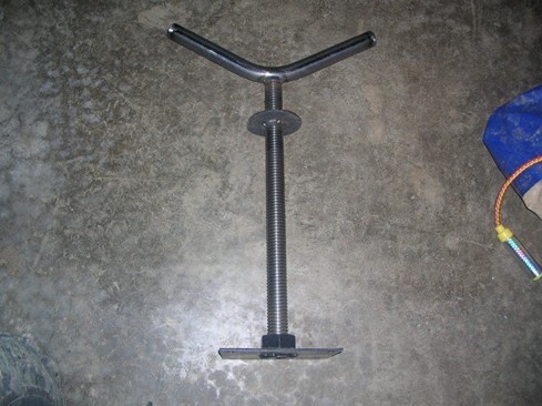

Made a spare tire mount for the bed of my MJ using acme rod, it was important to me that nothing protruded into the bed when the spare was removed.

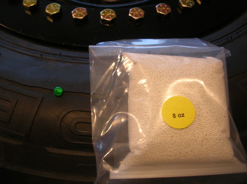

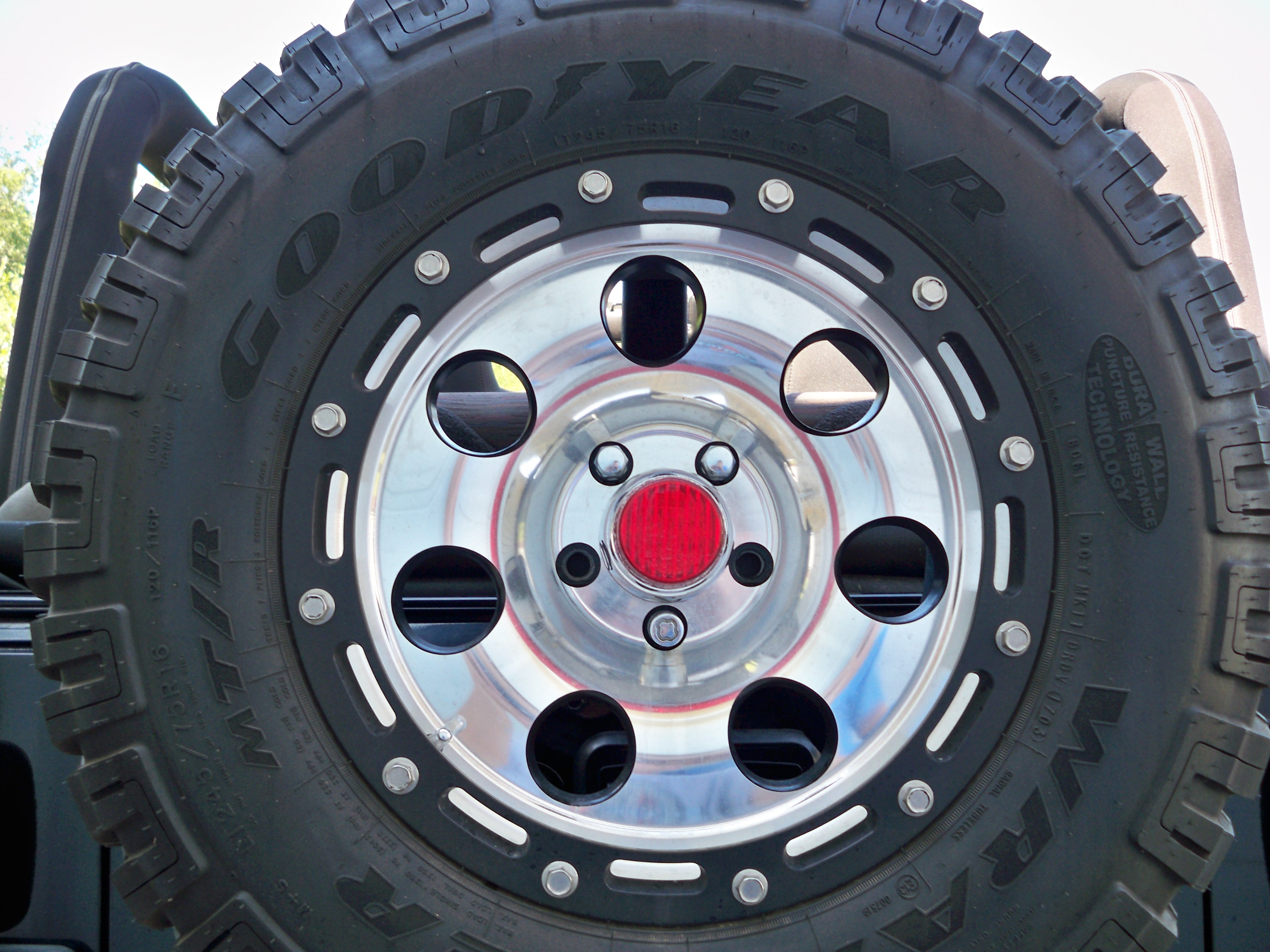

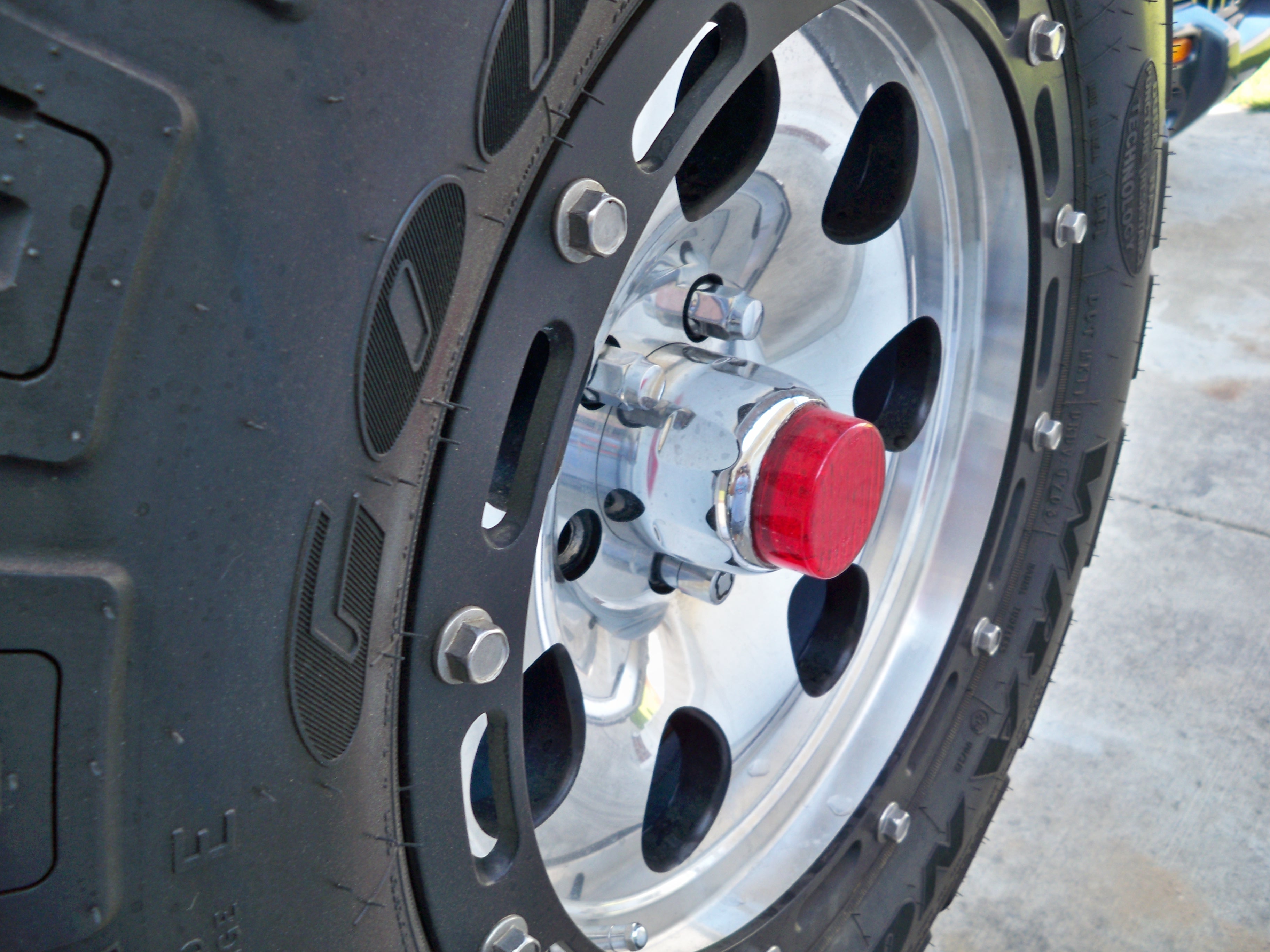

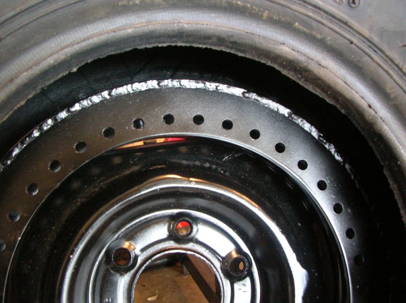

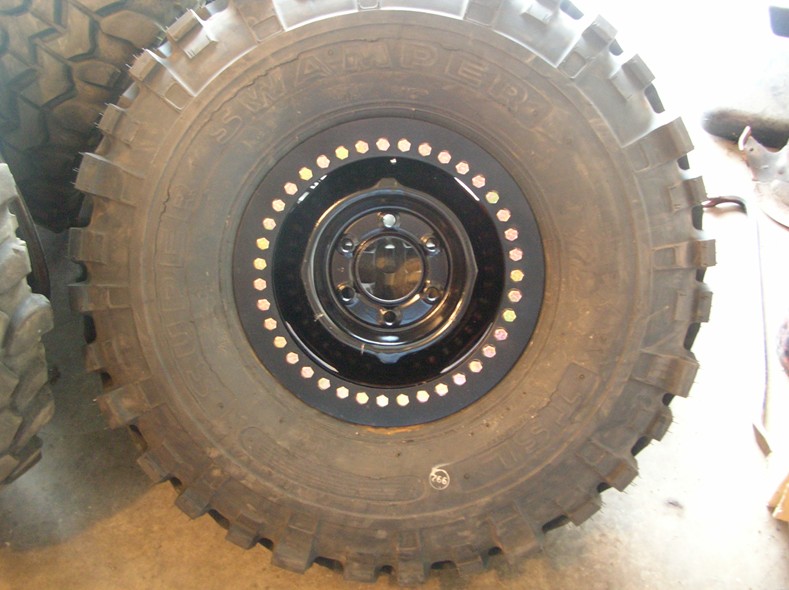

DIY beadlocks with DIY internal tire balancing.

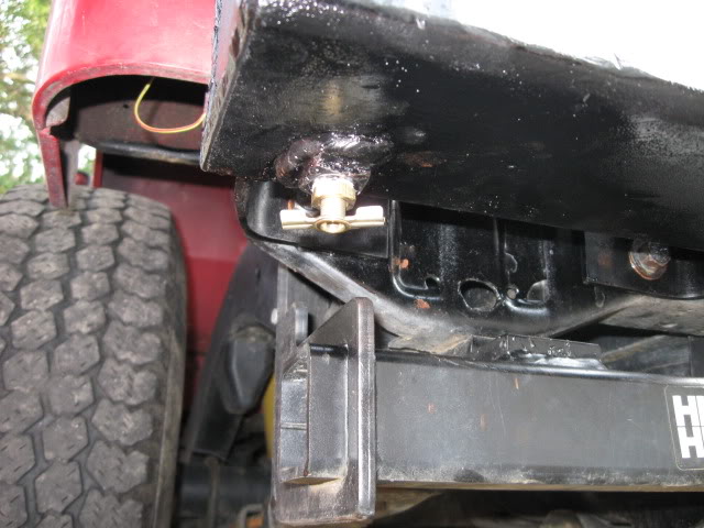

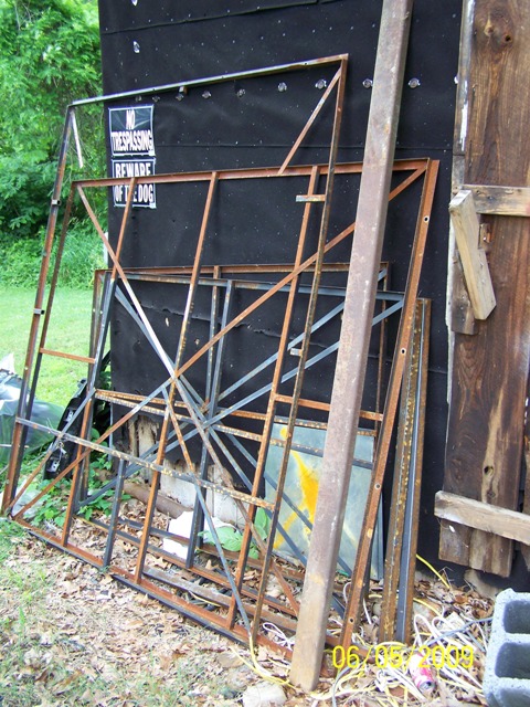

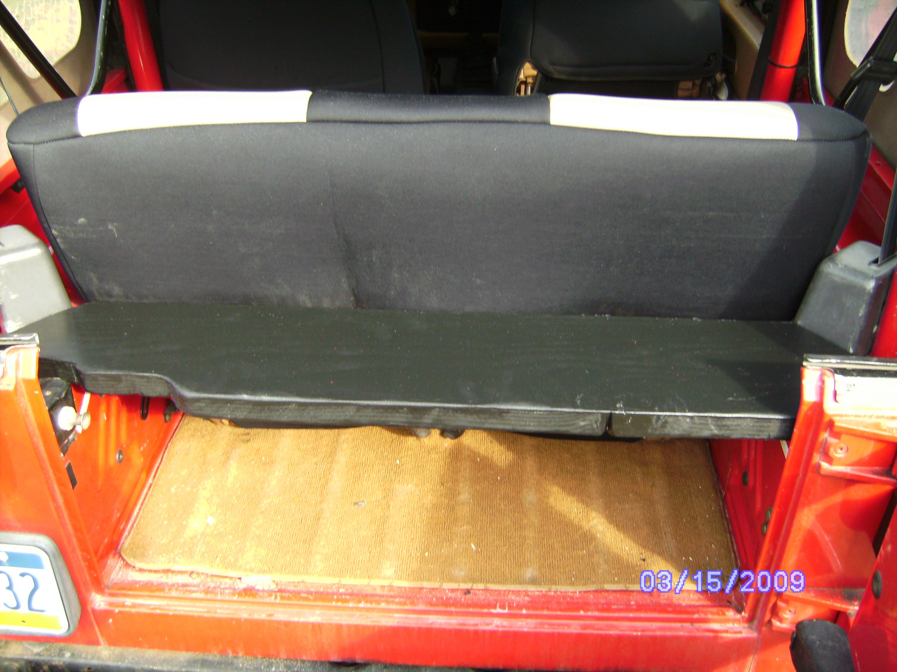

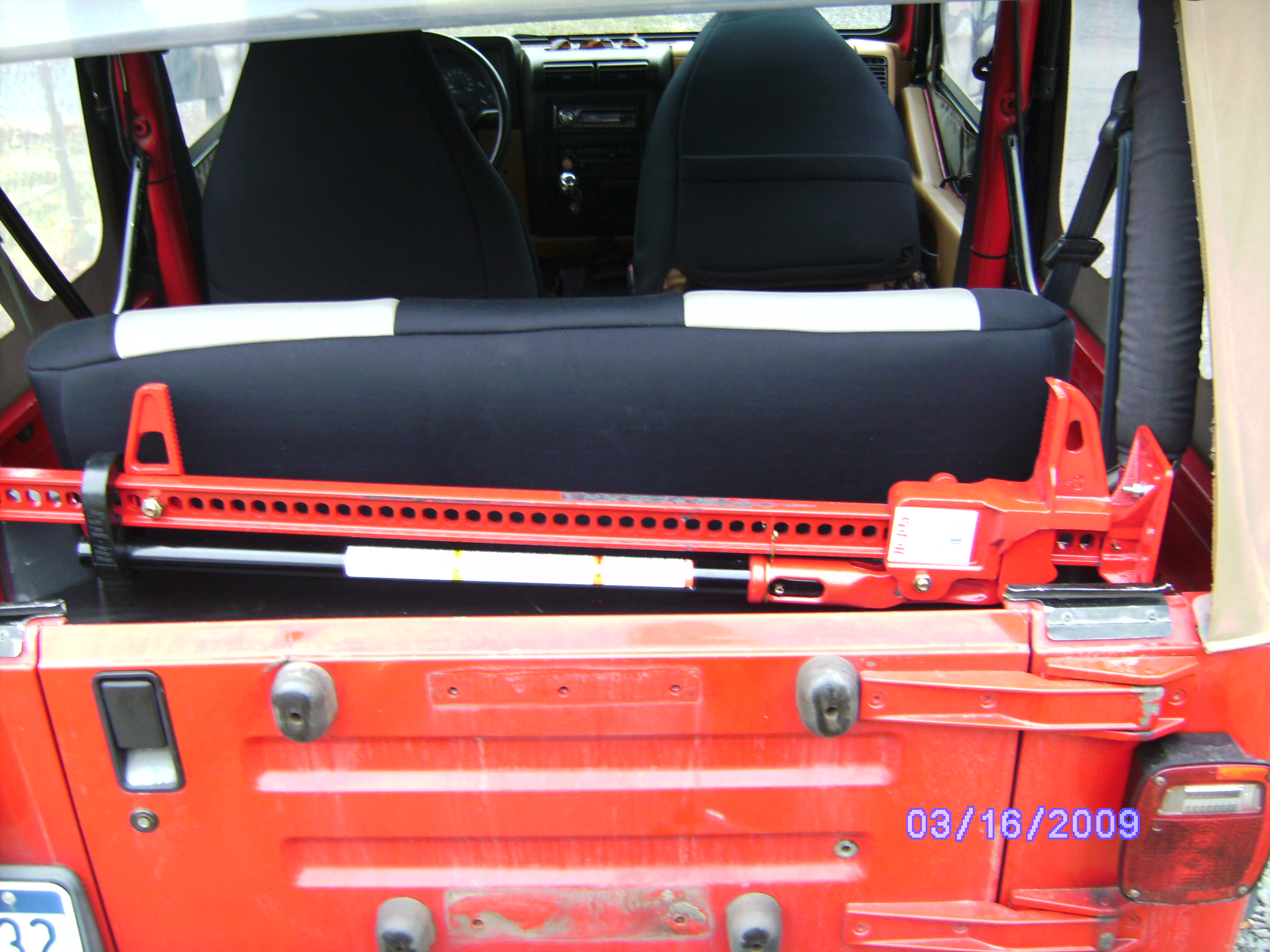

I made my trunk cover like most of every one else did.Also used some fence peices to hold the hi lift inside the jeep.
