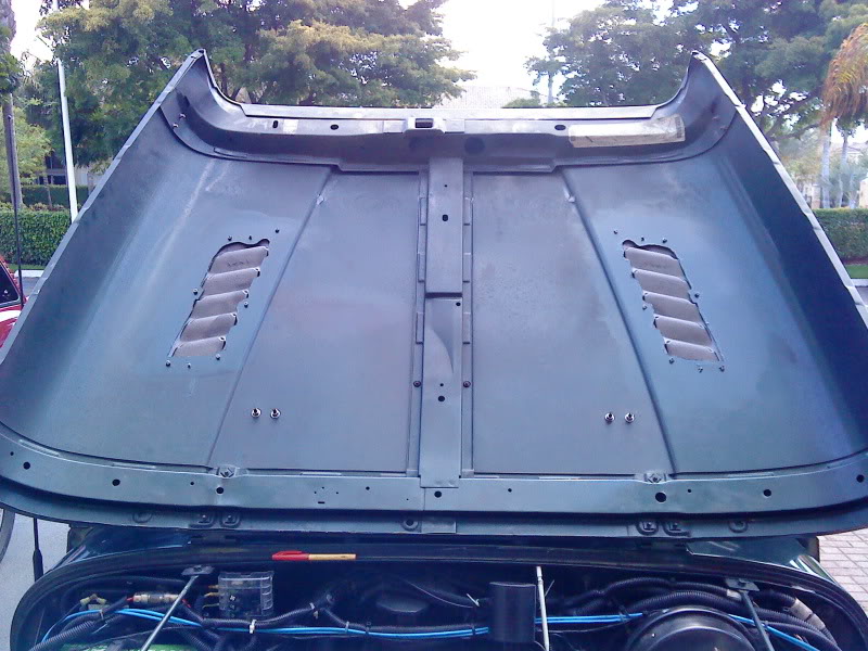

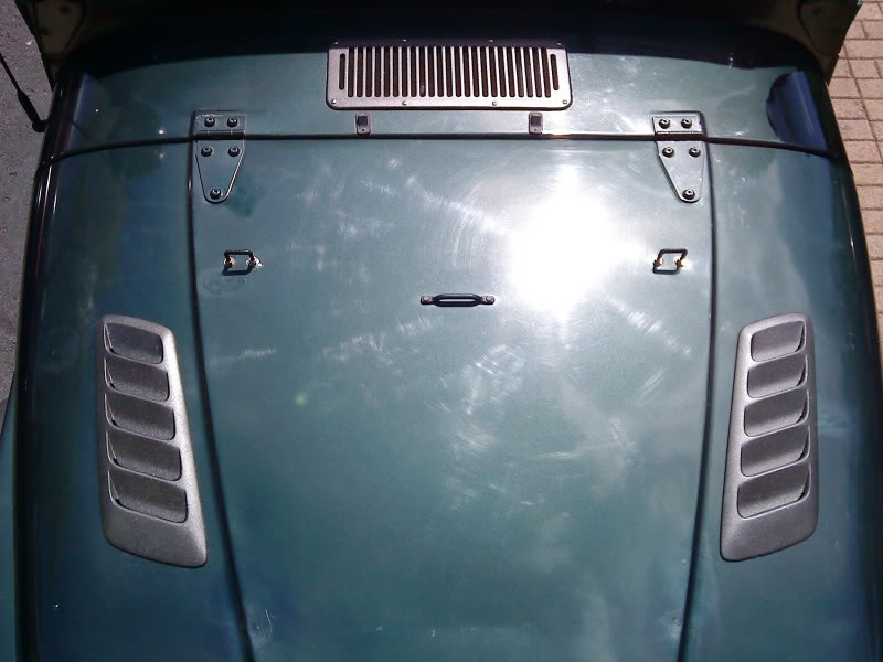

Also, I got tired of replacing cracked vacuum lines, so I put some Pontiac hood louvers on my hood...

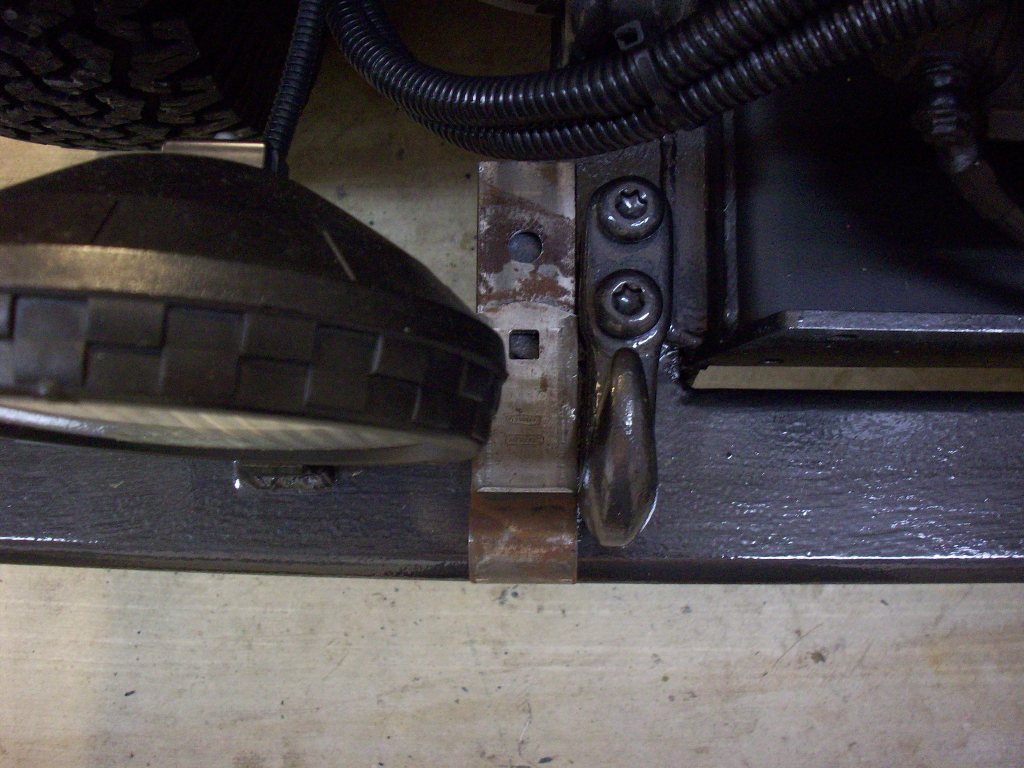

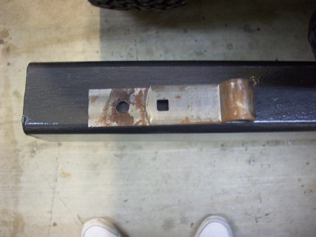

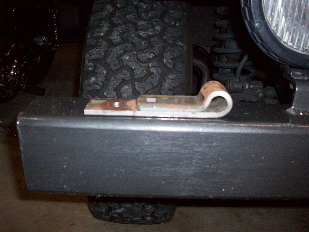

A friend asked if I could fabricate some mounting brackets for clevis pin for his rear bumper. I took some pictures on the front of my jeep to give an Idea they could work there too with a little extension. I was at my local farm supply store when I came across some real heavy duty strap barn hinges. They are one and three quarters of an inch wide and 3 eights of an inch thick. Have drilled holes and will be runnig a weld bead all around the strap and then will temper it for more tensil strength. Dry fitted the on the rear bumper and it looks good.
I know some will say they are not heavy enough and I also had that thought. So I frbracited one took it to a friend who load tests crains. The strap parted at 7450 pounds so yes they will be good for pulling you out of the mud.

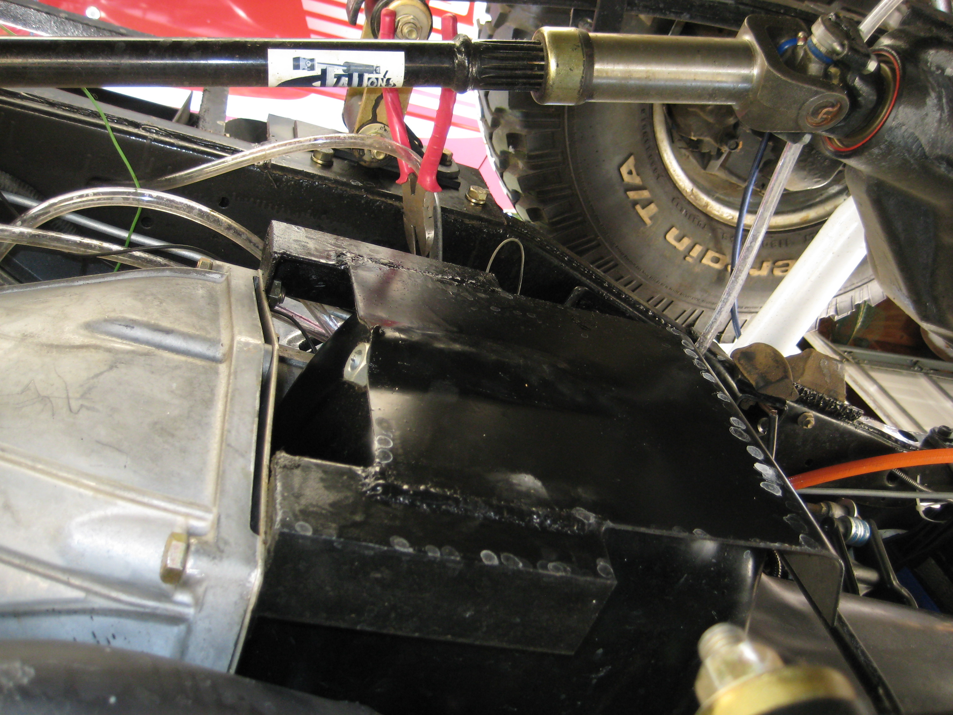

Homemade front bumper

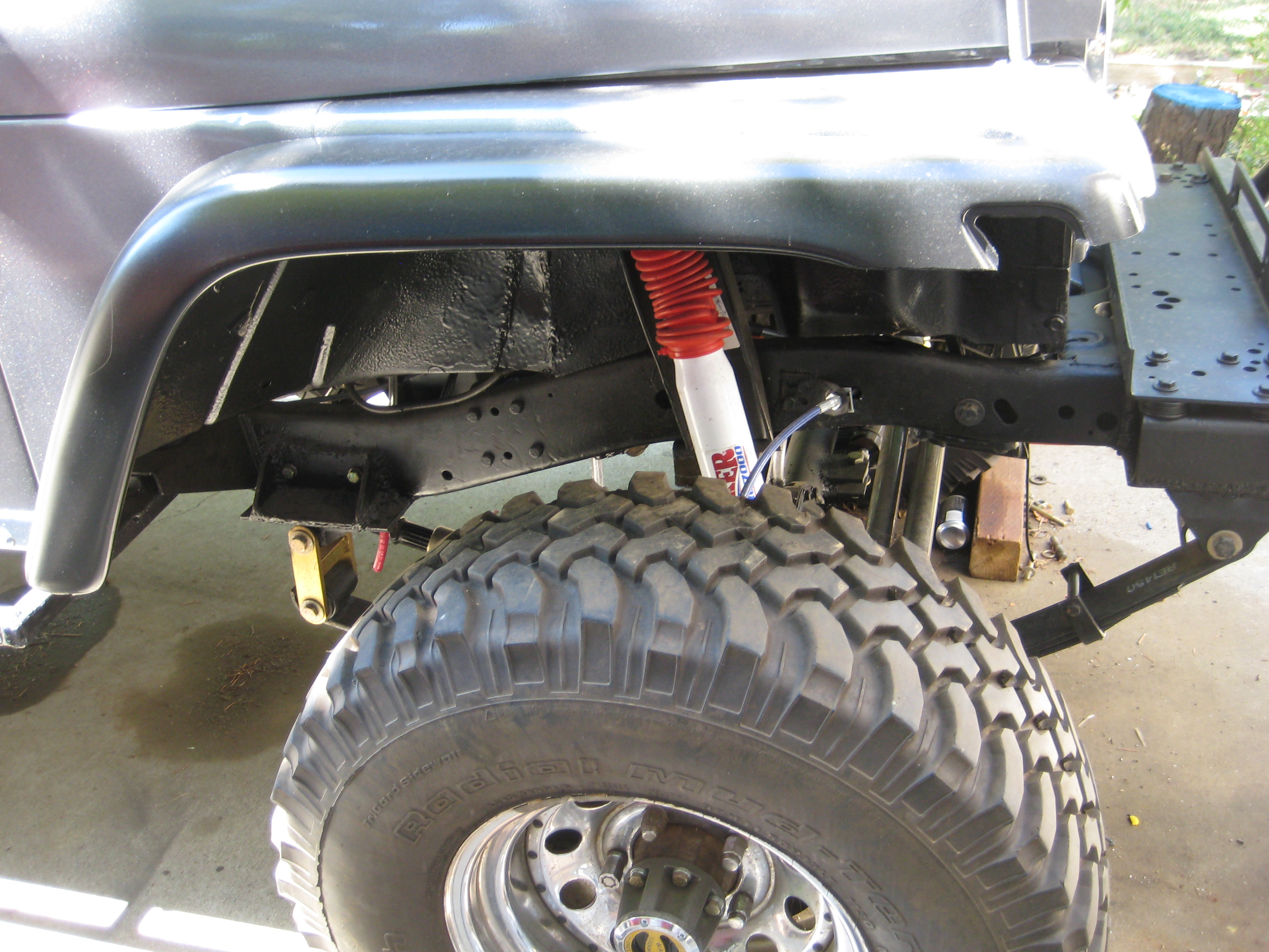

cut up and extended CJ7 flat front fenders, shackle reversal with outboarded springs tied into winch plate, bumper, and frame
rear ice chest gas can and water can carrier receiver hitch mount

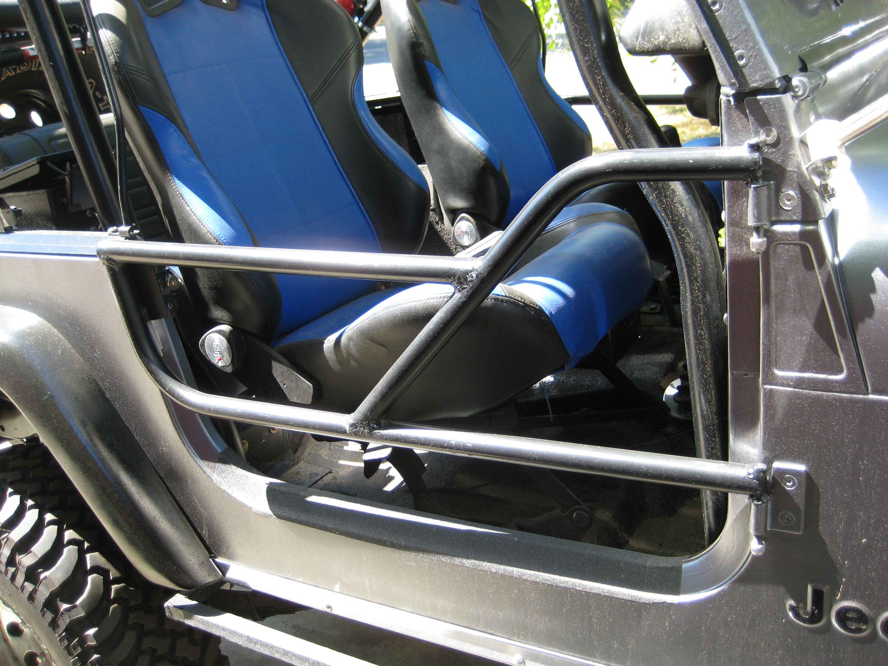

tube doors,
oil pan skid plate

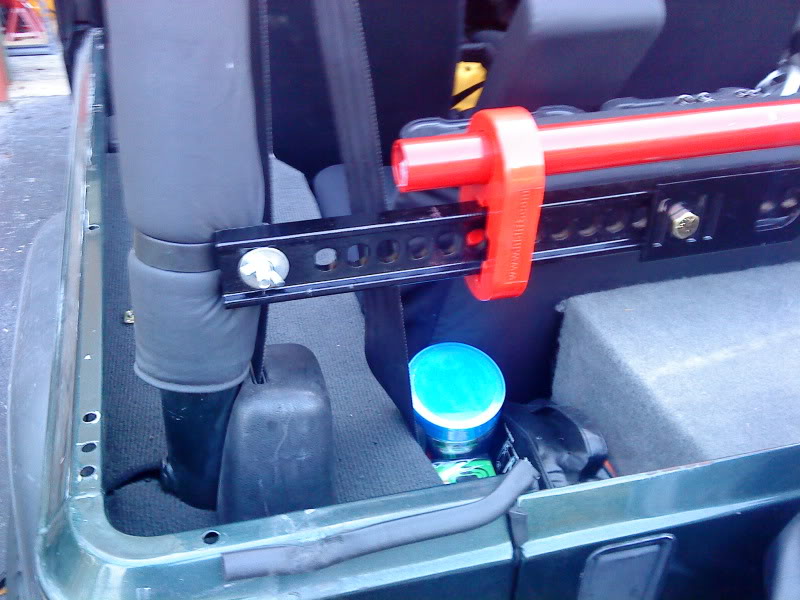

also not pictured: high lift jack mount inside on roll cage, u-bolt skid plates.
How does the front suspension handle on road and off? You lost a lot of ground clearance by mounting the shackle below the frame, did you consider mounting it up higher so the spring eye is even with the front spring eye? Many cut and sleeve the frame in order to do this, for you it may be as easy as moving the outboard shackle perch upward and moving the forward spring hanger down.
I like the tube doors! If only I had a tube bender,
welder, & the skills I could make my own!! :lol: LOL
