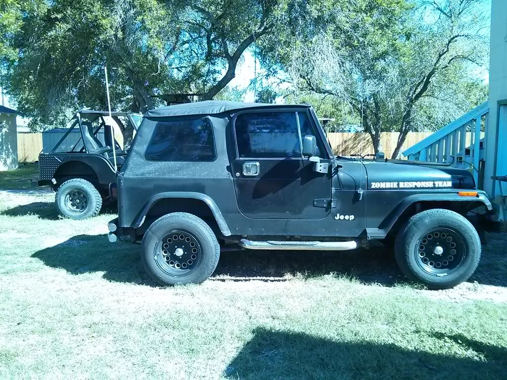

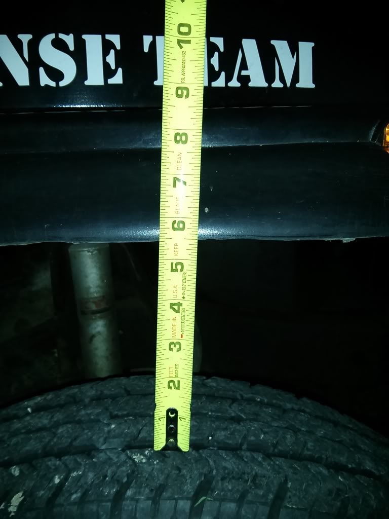

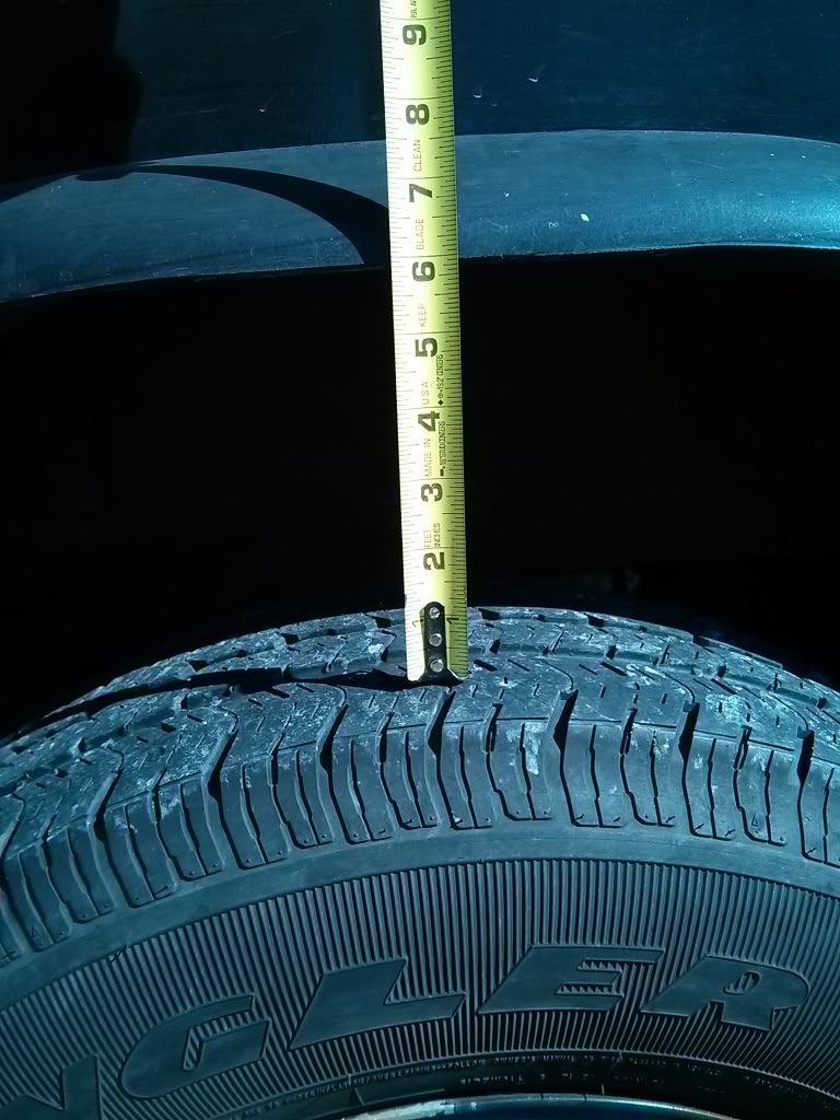

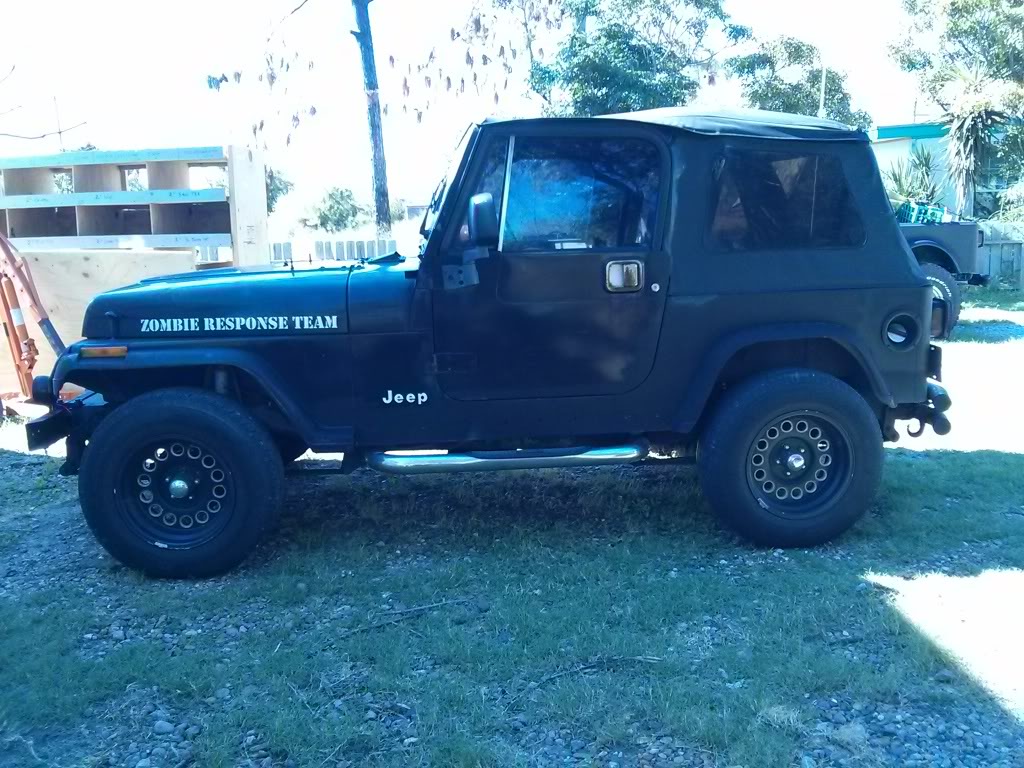

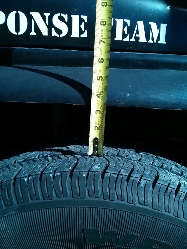

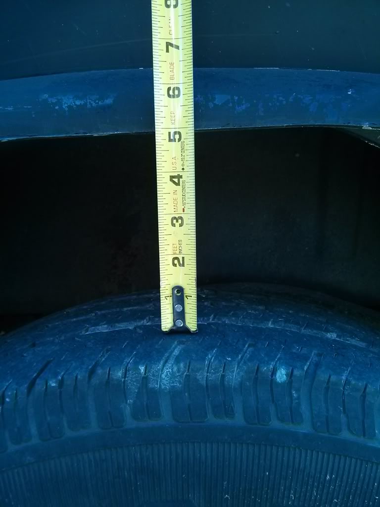

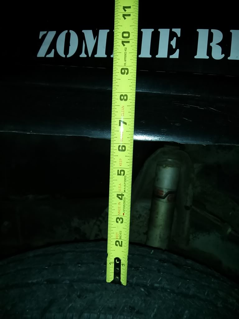

OK, here are the pre-lift pics with a tape measure.
Side shot
Driver front
Driver rear
Passenger rear
Passenger front
Passenger shot

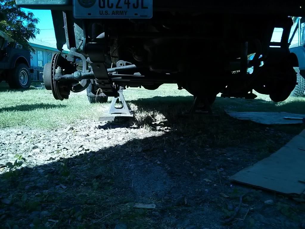

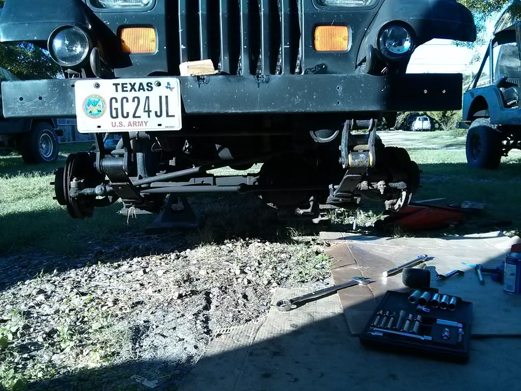

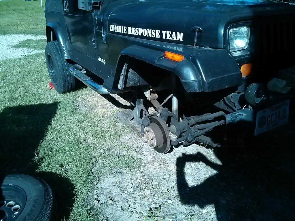

Some disassembly pics
Always use jack stands, your life/limbs are worth more then putting a lift on!
Use 2x12s to make a solid place for the jack stands. They are no good if they are going to tip over the first time you try and break a but free.

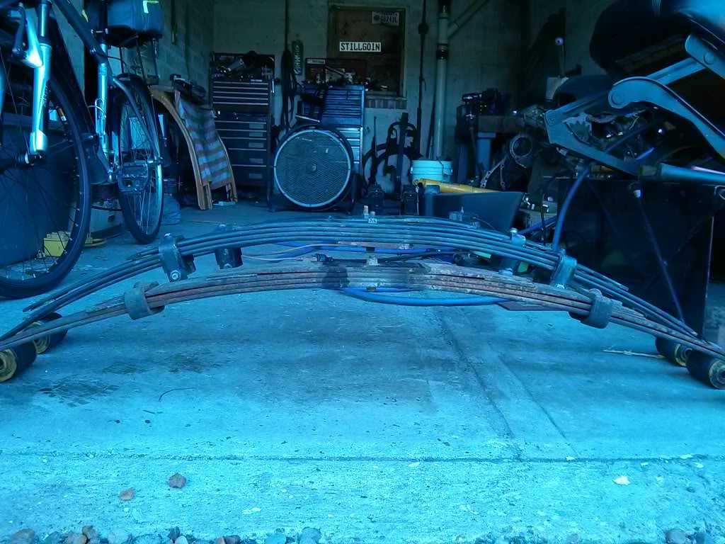

A stock front spring next to a 2.5 lift spring
Stock spring on the left, OME on the right

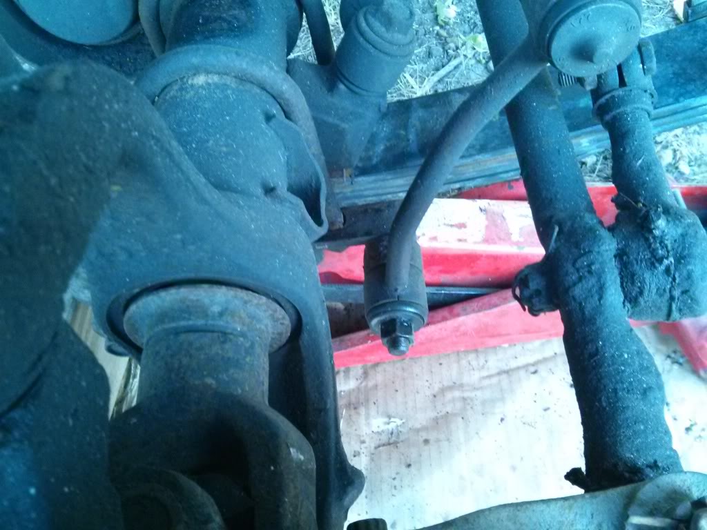

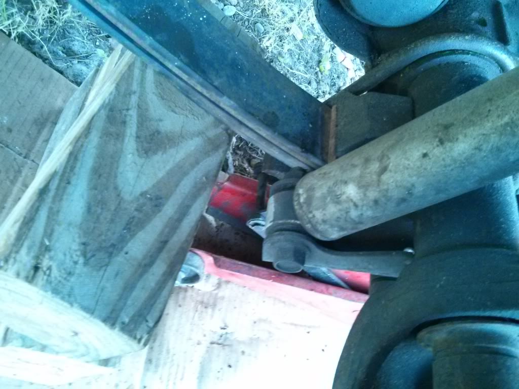

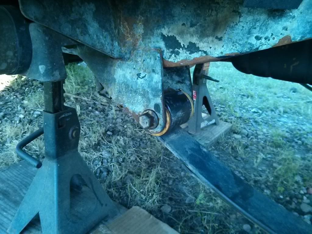

When removing/installing, this bottom nut/bolt is one to remove
This nut/bolt must be removed also
You can remove this one or just loosen it. I am a fan of removing as little as possible so I just loosened.
This is another to remove to put the shocks on. Need the top one to but I forgot that pic. The top but is easy to find though, follow the shock up and use a 9/16ths wrench.

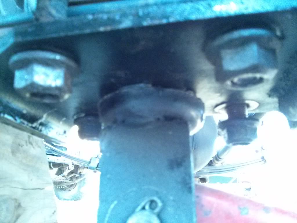

This is the underside of the u-bolt plate. Those four nuts must be removed to change the spring. I have the jack craddle covering the centering pin so you cannot see it but if you lay under your jeep and look under the spring, this is that area.

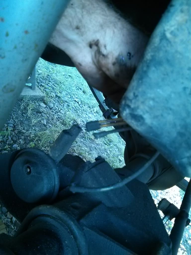

A little side note: unhook the air lines to the vacuum actuator or they will tear and your jeep will be two wheel drive for a while, like mine now is :/

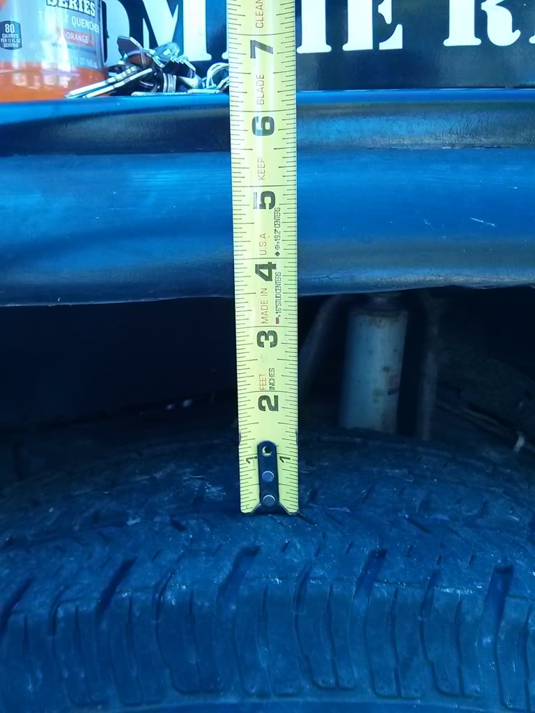

Here is the front springs swapped out and measurements taken.
This driver front after I drove down the street and tried to two wheel drive up the huge dirt hill from my normal pics
Passenger side front after driving around and wishing I hadn't torn those lines off the rubber plug.

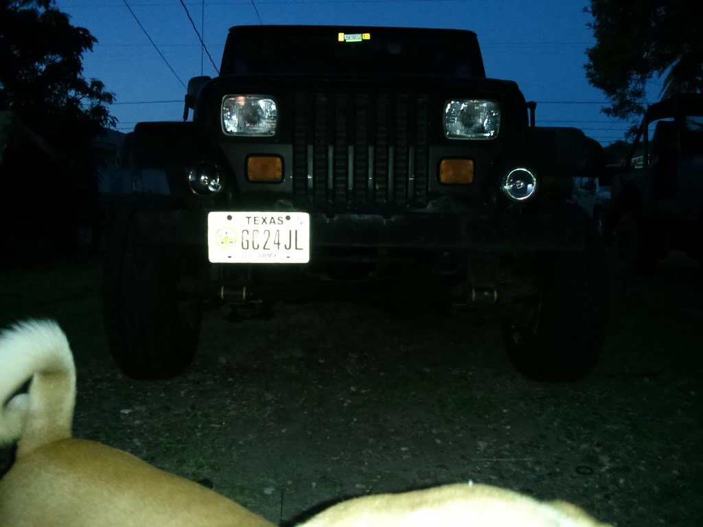

New front shot with dog used as measuring device. Dash loves to be in film. He is a real ham
Nice arc on those springs . Hope that means a comfortable rebound on and off road . Good boy Dash , keep an eye on daddy's jeep while he's at work . Maybe he'll let you take it out for test ! Woof !
I see a vacuum line repair kit in the works next .
OME ride great. I am hoping to finish today after work and then go cruise around.
Yup, need a repair kit now. Bummed out that I forgot about that
J. I noticed in your first disassembly pic that your front factory brake line is stretched tight, may want to look at that or get longer steel braided lines. I just happened to notice it.
yes sir. i noticed it too. i am going to have to search and find what other make/model factory lines fit so i am not paying a ton of money. the passenger side really is the one that got taught, the driver's side didn't at all
