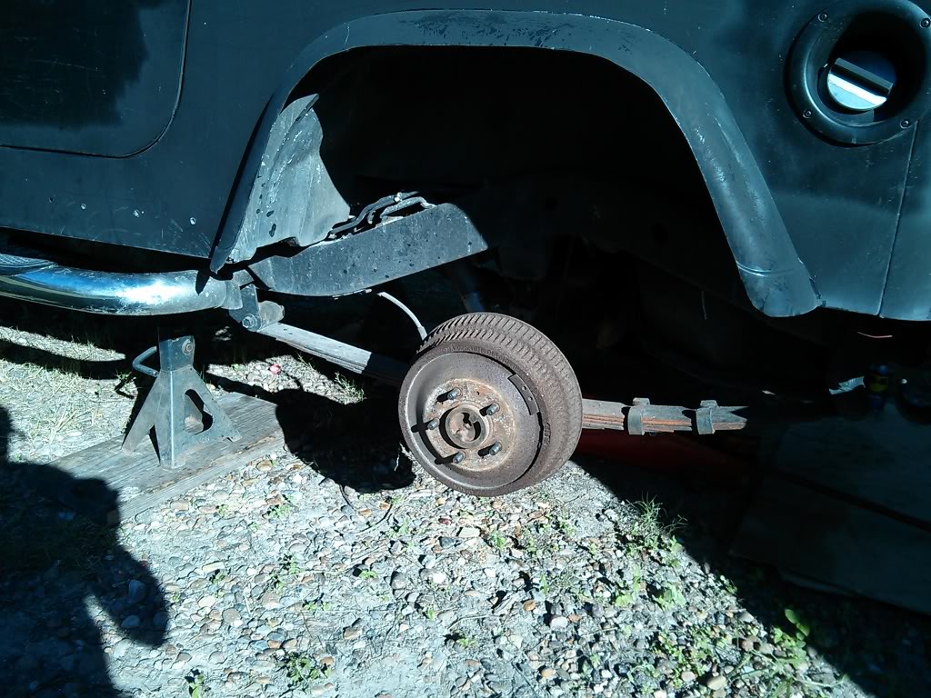

Set up jack stands on something solid again.
Looks solid

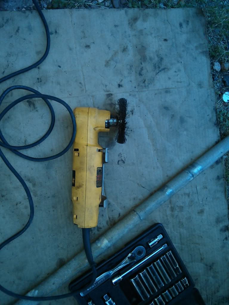

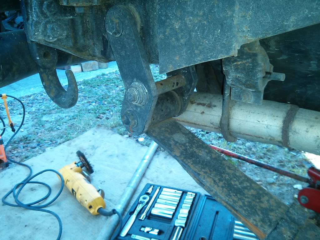

Get tools. The wire wheel on the grinder cleans threads good so stuff comes apart easier
This size is the most common size for this swap. Take that bolt off also.
Loosen this bottom bolt and remove also.
Undo these ones first though, somehow my pics are not in order.

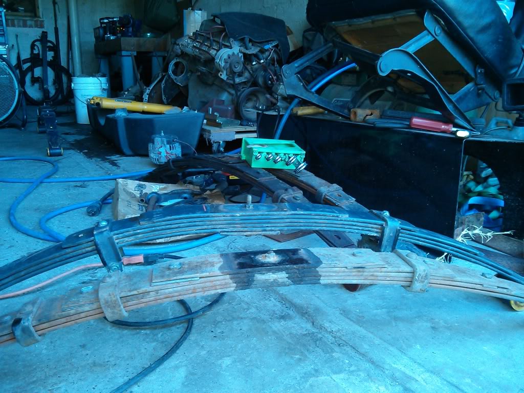

This is the difference in the rear springs. Major difference

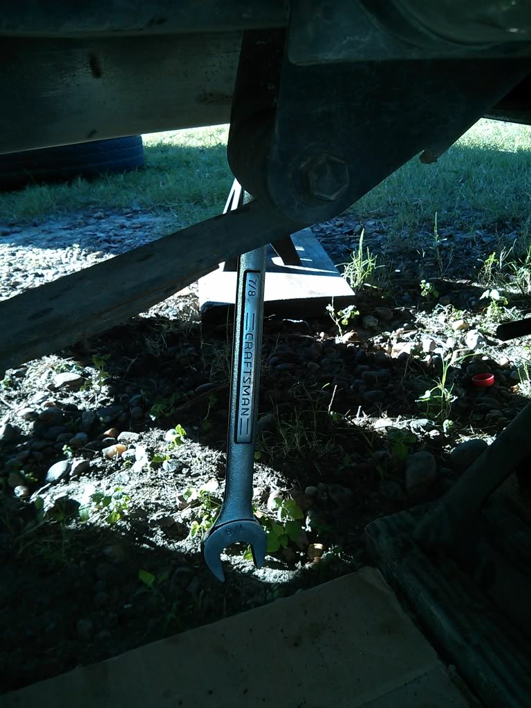

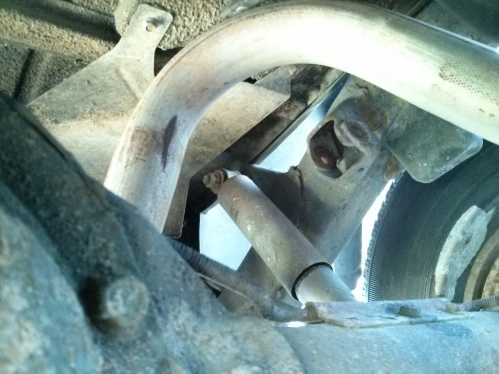

When doing your shocks, see that but on top, take it off.
Undo the nut/bolt at the bottom of the shock and the shock will drop out.

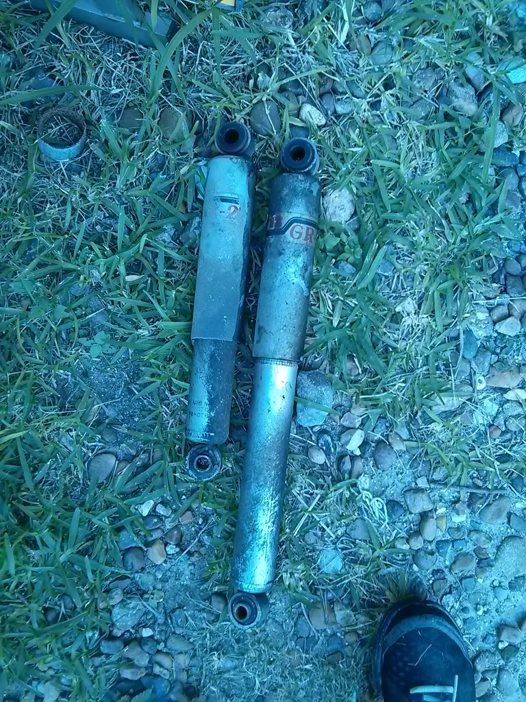

If your shocks come out like this, be glad you are replacing them, the small one is no good.

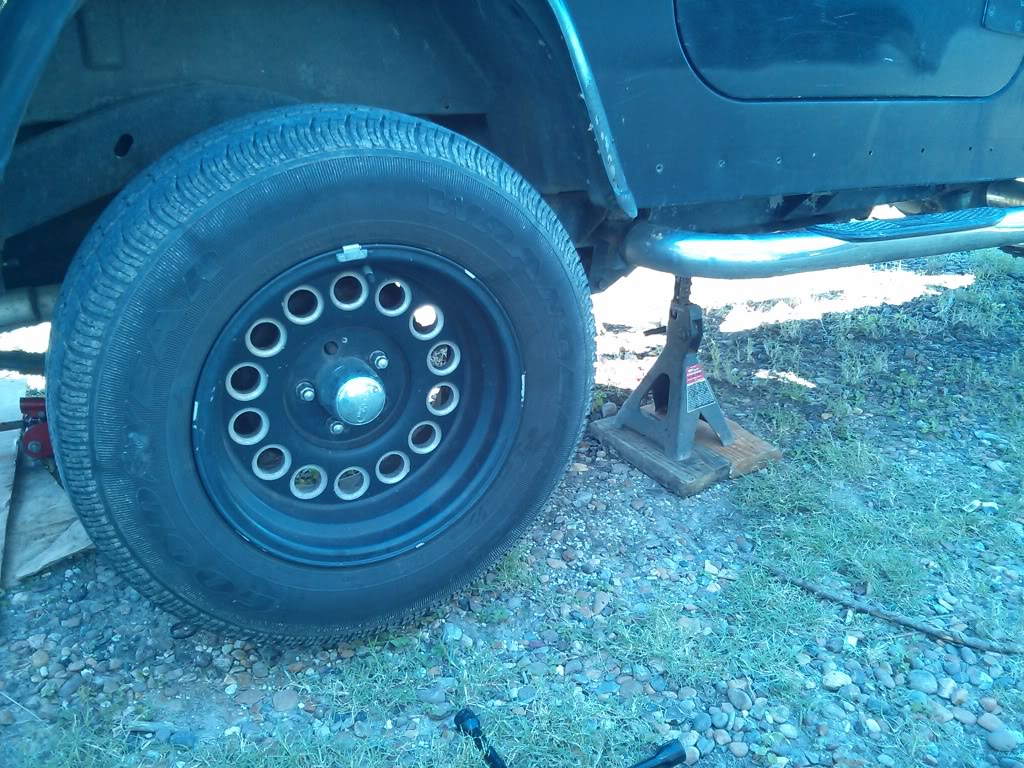

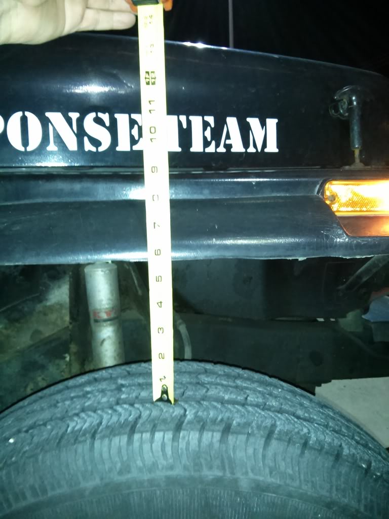

Now, reinstall your shocks and tighten stuff down. Remember when doing this, don't fully tighten the suspension till the jeep is on the ground or it will ride crappy. Then after that, park it and measure the lift

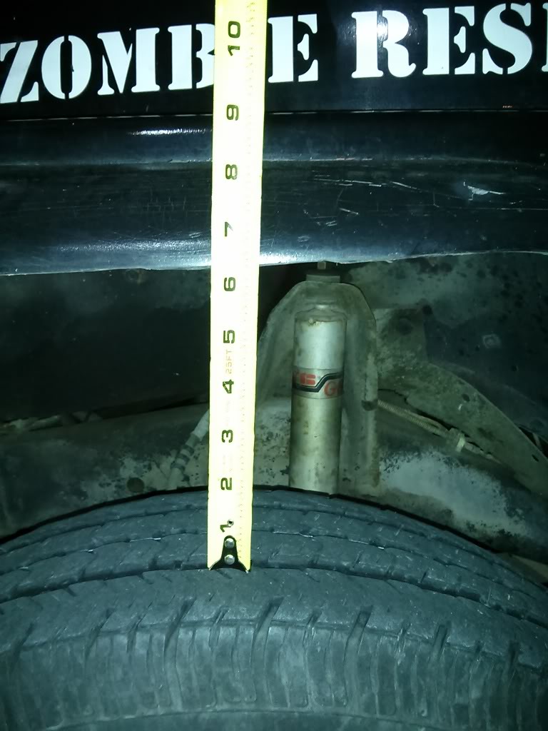

Driver's front
Driver rear

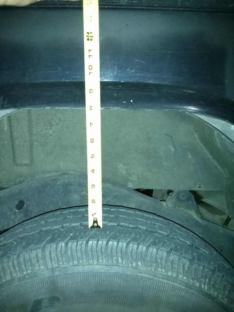

Passenger rear

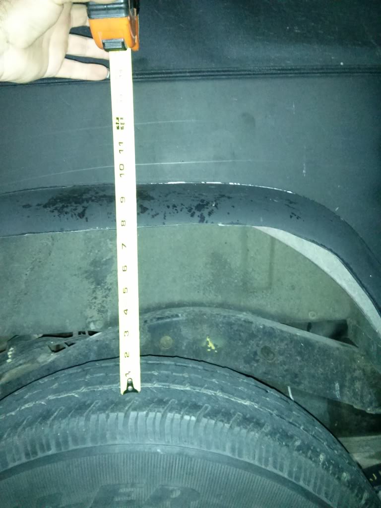

Passenger front
After this lift I have developed vibrations so I will try a transfer case drop and see what happens. I think the 5 leaf springs should have went on the front but when I googled the placement, it seems I have it right. Since my jeep had 5 leaf springs all the way around, I think having the same amount all the way around would be the best deal but I don't think I needed the heavy duty old man emu springs, which are 5 leaf. To me, the 4 leaf front are super nice feeling and the back is a little more solid right now. Maybe it will break in and ride better after a few weeks, who knows.

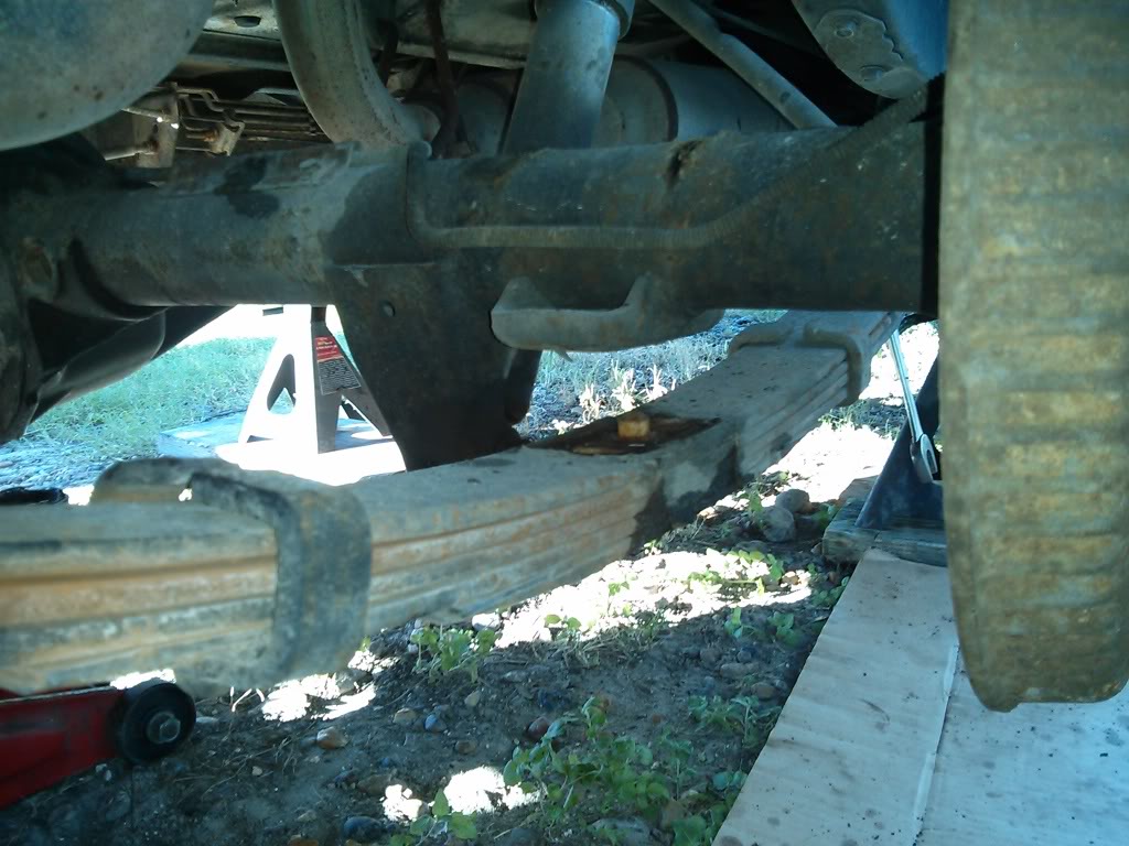

You made a good point regarding whether to use 4 or 5 leaf springs . My '92 has 4 leaf springs in the rear and have been debating whether to use replacement 4 leaf or to upgrade to 5. I personally feel a cherokee will ride far too stiff and handling will be terrible with 5 leaf unless your going for major lift with 33" tires all around for superior off road performance but in my case , my jeep sees the asphalt year round and rarely goes off road these days so I'm thinking 4 leaf medium strength for me. Gas shocks should take care of stability and comfort. I noticed in one pic , after the u-bolt was removed , it appeared the u-bolt took a deep bite into the tube , was that an issue ? Also , was there a bead of weld across the tube as well ? Nice lift all around ! Will certainly be following along with the t-case drop to beat down the bad vibes.
That spot is where dirt and grime had built up around the ubolt so under the bolt was more clean then the rest of the axle tube. That is where the tube is actually black and the other visible stuff is grey brown grimey color.

regarding the springs J. I wouldn't worry about the 4 leafs being in the back at all (normal). Springs are built with diff spring rates, you could have 10 leafs in a pack and it may ride better than say one with 4-5 because of its spring rate. I had a shop owner that was a friend at the time go into great detail about springs when I was buying a set once. I couldn't begin to go into all detail, I simply don't remember. But basicly the front has more leafs because there is more weight up front with the engine and the springs rebound needs to be a bit stiffer than the rear. A lift for a 6 cyl will have a diff spring rate than one for a 4cyl (more weight). The packs may have the same leafs but the springs rebound rate will be diff. The rear carries no load, and will settle in after a while. It will probably take longer than a few weeks though. I added a BDS lift and had the same thing going on with the rear sitting higher than the front, it settled in about a year. I parked the jeep often where the rear suspension was flexed a little hoping it would help them break in. Don't really know if it helped or not. The rear of my jeep was a bit bouncy but as the year went on it felt better and better.

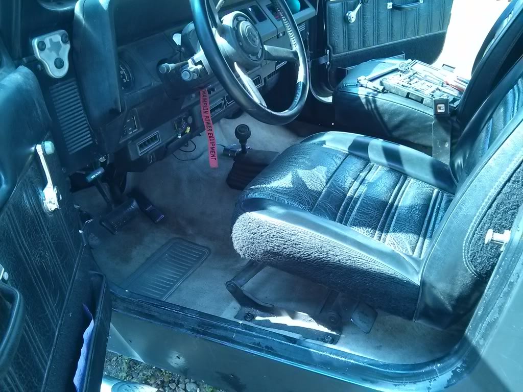

Got bored, lined the inside while waiting for tcase drop kit. Tomorrow will be drop kit install and carpet install
I totally read your post wrong, but I do believe the 5 were supposed to go in front. That's weird, maybe wranglers are diff. Sorry for the confusion. I think I need to quit getting on here at 6:00 in the morning. Ive made a few mistakes lately.
Carpet in now too. Man, so much quieter while driving. And no hot feet from exhaust radiant heat.

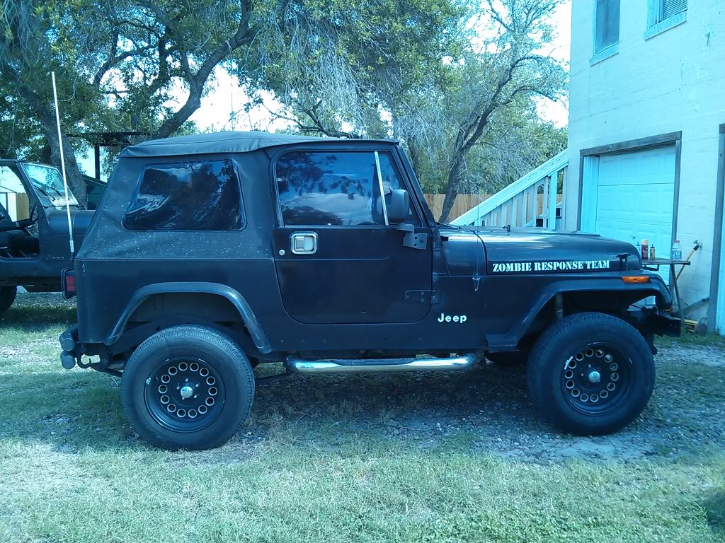

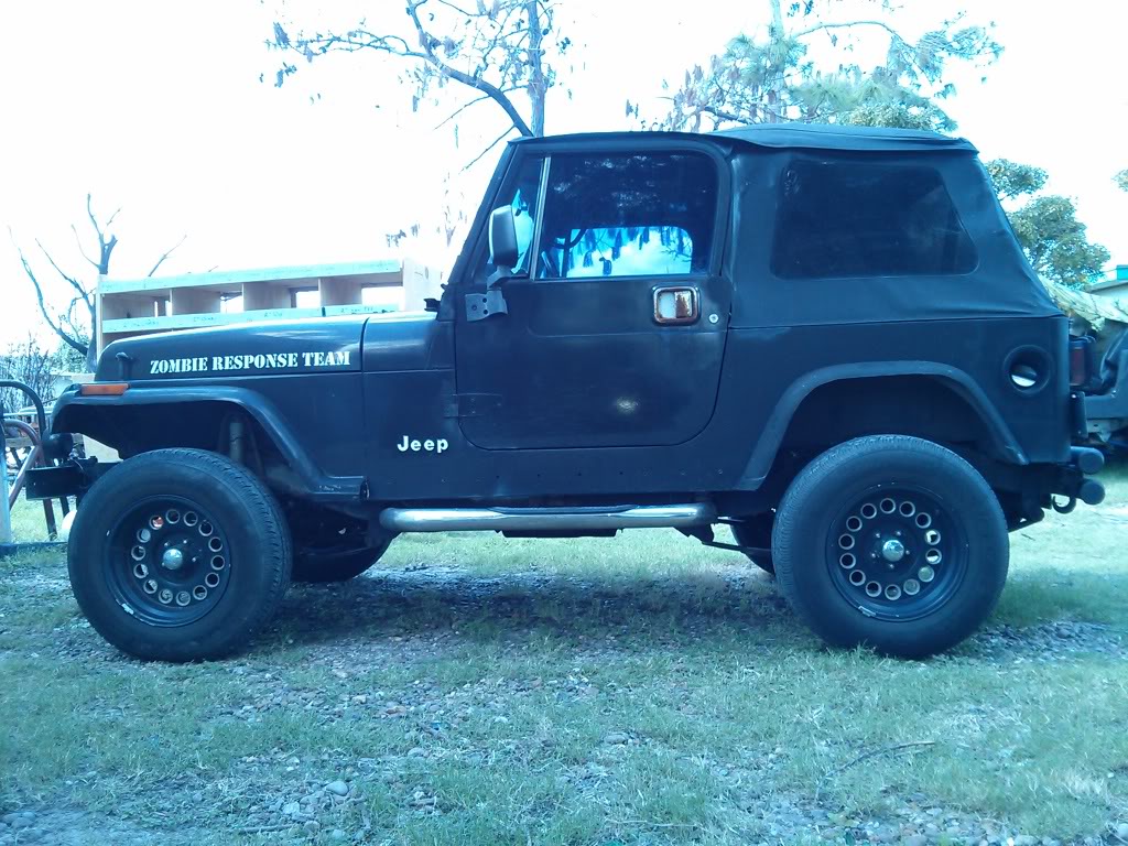

Real nice job on the liner coating . Man that is one good looking ride , and for an '87 , it looks great ! There's jeeps younger that cannot claim that. That jeep is one clean mean machine !
