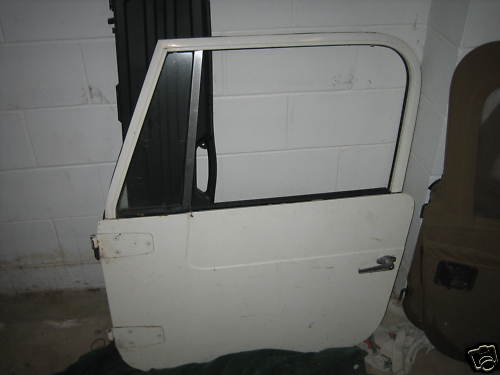

OK everyone i just got some jeep cj 7 doors that i plan to put on my yj but the door handles are the old type i was wondering if anyone has changed the andle style to the padle style
What do you mean? what type of handles does it have now?. The original handles ARE a Paddle style handles that comes on the CJ doors. The only difference is the opening is towards the front instead of towards the rear like that ones found on the TJ doors.
Well the doors i have have little handles on them and then a slinding latch type thing just like the back latch on the hardtops i am putting pics up right now

The factory handles were changed from flippers to paddles around 1980. I think changing to a paddle handle would be difficult because a larger hole woub have to be cut in the door,but I would think changing the "catch point" shouldn't be too hard. If I remember correctly(which is rare) the flipper handle catches a flat spot on the body similar to the soft door handles(CJ). I would think if you removed the Wrangler door catch & added a strike plate to the inside of the door frame it would work. Please remember I don't have an old CJ7 in front of me so I could be full of cr**.
Ya i have been doing some research and you are correct i would like to change to the paddle and theath thing if i could because the latch handlle doesnt support the doors and puts stress on the doors.
Wow, that's an oldie design. Yup i agree, there's gonna be a lot of mods to be done for the paddle style. I beleive the latch will also need to be replaced with the linkage that goes to the paddle handle.

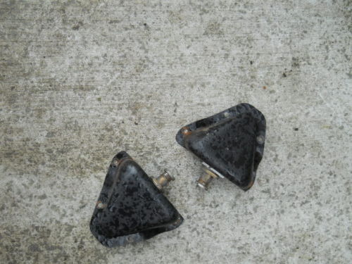

Yours don't need any hardware right? It sounds like you want to go to set of doors with striker pins like the ones below. Keep in mind that those aren't great either - I believe that I snagged alot of shirts on them over the years.
I'd either keep what you have, or buy new doors. You'll need to cut those to make some paddles fit, and it's probably easier to swap yours for new ones.

ya the kind in the pic is what i have on my half doors the reason i want to change is because on the style i have now it puts stress on the upper fram and causes cracks i already have to weld the cracks that are there up and about the new doors i dont have the cash
you need to remove the striker on the tub side and replace it with the older CJ style. Crown sells the parts to do it.
Ya i have all of the parts to use the old style. The thing is i want to change to the post striker style because it gives the door a little more saport and the style i have now is so stressed it causess cracks at the ventwindow. Now i am going to weld the cracks back up but i want to try and prevent this from ever happening again.
My 78 got those stress cracks too... Yes, the striker area is just a little flat plate on the door jamb. I never thought about it that way... The rear of the door has no support at all - I wonder if the later style lock pin actually dose give it some support?
