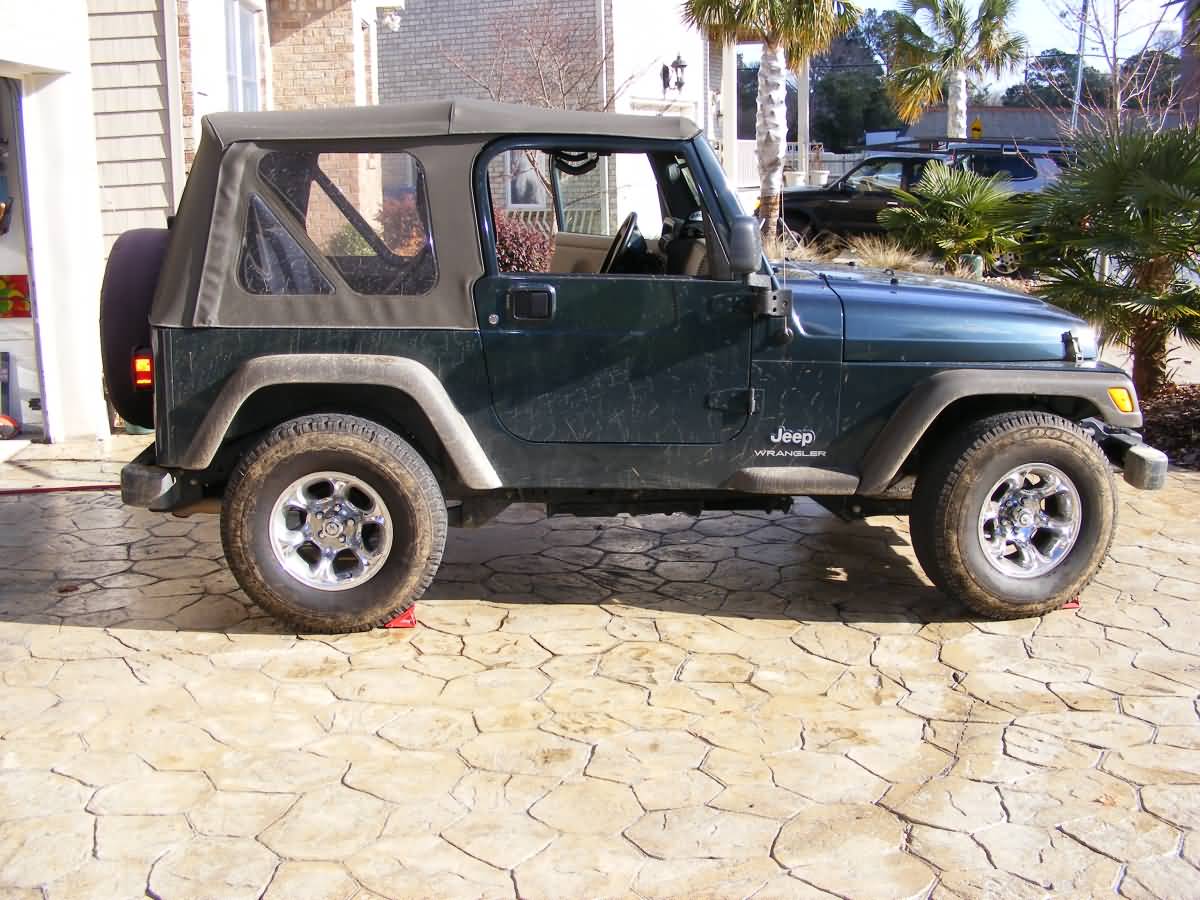

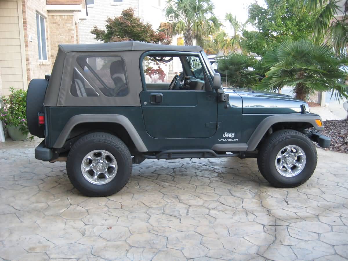

Before and after lift photos
Here are some shots from before and after the 2" lift. You have to look hard to see a difference, but there is a 2" change there.
Thanks for the instructions. They came in very handy. I installed a Teraflex 2" budget boost. Only took a day (although the crappy instructions say 1 to 3 hours). Didn't have to change the shock absorbers as I just lifted it 2". Rides great. Appreciate the time you took to do this.

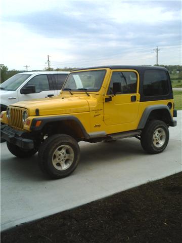

i just put a rough country 4 in lift on my TJ and it is similar steps. Just wanted to make a few points.
-use penetrating oil very generously on all bolts before you start or you will prob break at least one, espicically if you jeep is more than 6 or 7 years old.
-watch the brake lines and axle vent tubes when you drop the axle down
-have a breaker bar, bandaids and a bible near by. you'll need them!
im not trying to talk anybody out of it. you learn a lot about your jeep when you work on it your self. it took me probably about 12 hours to do by my self. i enjoyed it.
p.s. i need some tires!
