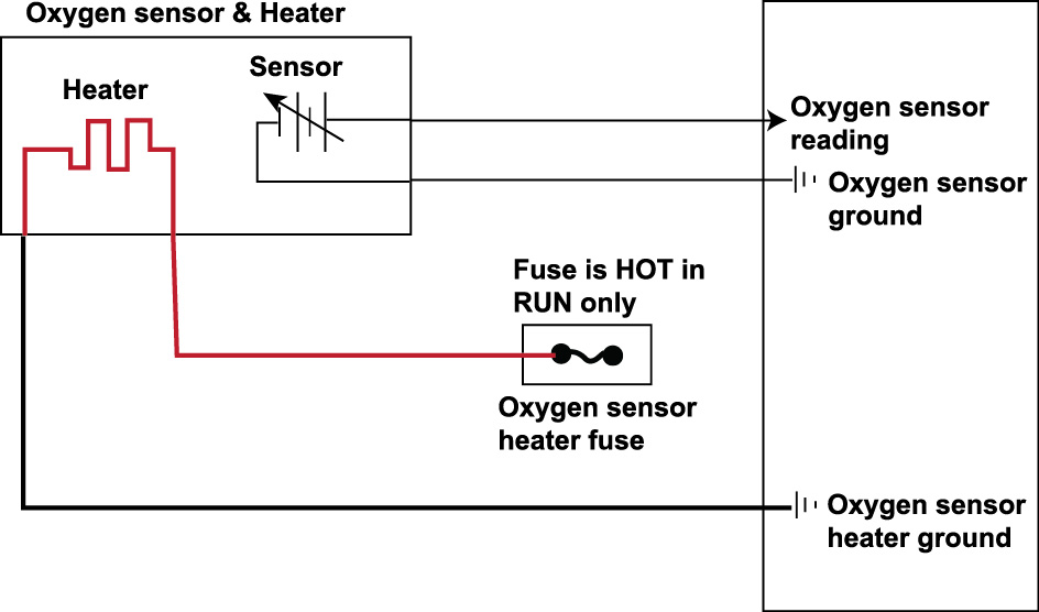

I'm really frustrated by this problem. I just can't get that check engine light off. I'm currently sitting on a P0058 (O2 SENSOR 2/2 HEATER CIRCUIT HIGH) error.
Here's what I've done
  • Repaired the cut O2 sensor harness wires several times. They are currently soldered and seem to have a really good connection.
  • Replaced the O2 sensor 3 times. The current sensor is MOPAR from the dealer
I've got a scanner, and I can monitor all my O2 sensors - the first three all fluctuate between .2 and .8, but this O2 sensor just sits pegged at 1.75 - never any fluctuation.
Anyone have any thoughts? I'm unable to find any fuse for the O2 sensor.
Have you checked the voltage going to the sensor? Disconnect the sensor and see if your getting 12v on the power lead. Anything less and it's a power problem.

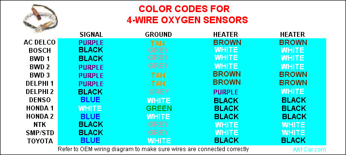

I've got four wires on the O2 sensor - two white, a gray, and a black. Do you know what voltages I should have on them?
I'll cut an old O2 sensor and read the voltages later today.
Your hot should be one of the white wires, possibly one is striped. You might also check the ground wires for a voltage drop reading. A max voltage reading of 0.250 volt indicates a bad (shorted) wire connections. Do this with key on and reading must be done when engine is hot and cold. They readings should be the same.

When I switch to continuity check on my multimeter, ground the negative probe, and connect to the second white lead (Brown harness wire), I hear a faint continuity buzz.
Should one of these four leads be a +12v?[TABLE="class: grid, width: 949, align: center"]
