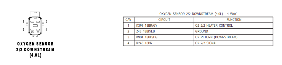

I've cut the ends off an old O2 sensor, and compared the readings from what my computer says is bad (2/2) to the 1/2 sensor, which isn't throwing a code. The readings are pretty much the same, which surprised me. I expected the heater control signal to be off.

My manual references a relay in the PDC, but I can't find any relay with any type of O2 heater control reference.
The black wire is the sensing voltage and should have a mv signal from .1 to .9mv. I noticed you were reading 4.17 V on the black wire. That is too much. The O2 sensor should output between .4-.6mv at normal operating temp. An O2 sensor doesn't begin outputting a signal until it reaches the neighbor hood of 600*. manufacturers began putting heaters on them so they start working sooner after the engine starts. Is it possible that you have the heater voltage on the black (sensor voltage)? When you made the repairs on the wiring harness they may have gotten crossed. White should be 12 V + through heater and back to ground on the other white. Gray ground and Black O2 sensor voltage back to PCM.
disconnect the sensor, turn key on and see if you can locate which white has 12v. Test the other white to ground to determine correct connections.

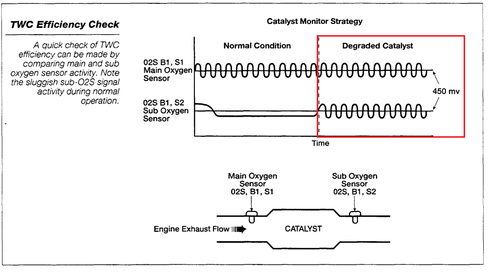

Is the sensor you're having problems with down stream of the catalyst? The pre catalyst sensor(s) are closer to the exhaust manifold/header and probably heating up and working within the programmed time in the PCM and the post Catalyst sensor is not. Usually there will be a huge temp drop across the Catalyst. I think I would search out why there is no heater voltage at any sensor if this is the case. I know this driving you crazy, it would me too.

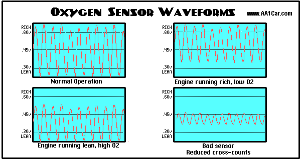

Have you hooked up to see the O2 switching?
It's been burning into my dash for 2 years now. It's not going away anytime soon. Always the same error, that the O2 heater circuit failed.
I'm not sure what you mean by O2 switching though.
Sry by switching I mean waveforms...
