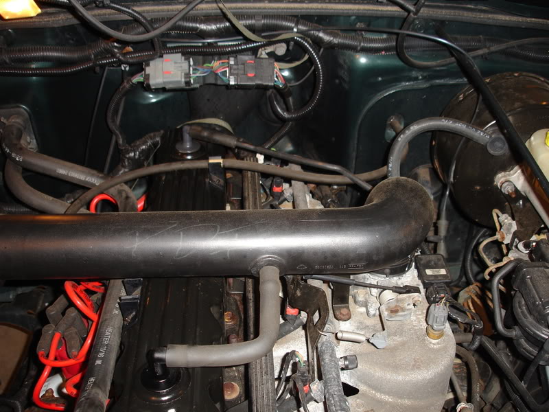

Yes exhaust/intake gasket is one piece.
Crank sensor is on bell housing see below.
Air temp on intake manifold lower right brass sensor.
