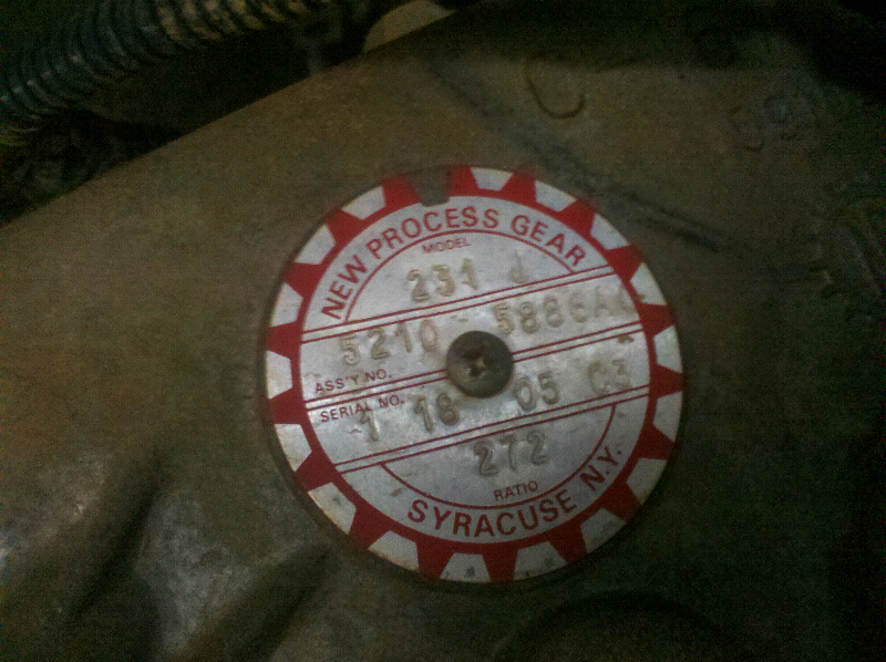

I'd replace it with the same thing. This is the badge on my 231 transfer case off of my 2005 auto.

i think all of them after 93 or 94 are 231j trans cases. but new venture and new process are the same company, they just had a name change because their parent company got bought out in the 90s so some say nv231 and some say np231.
