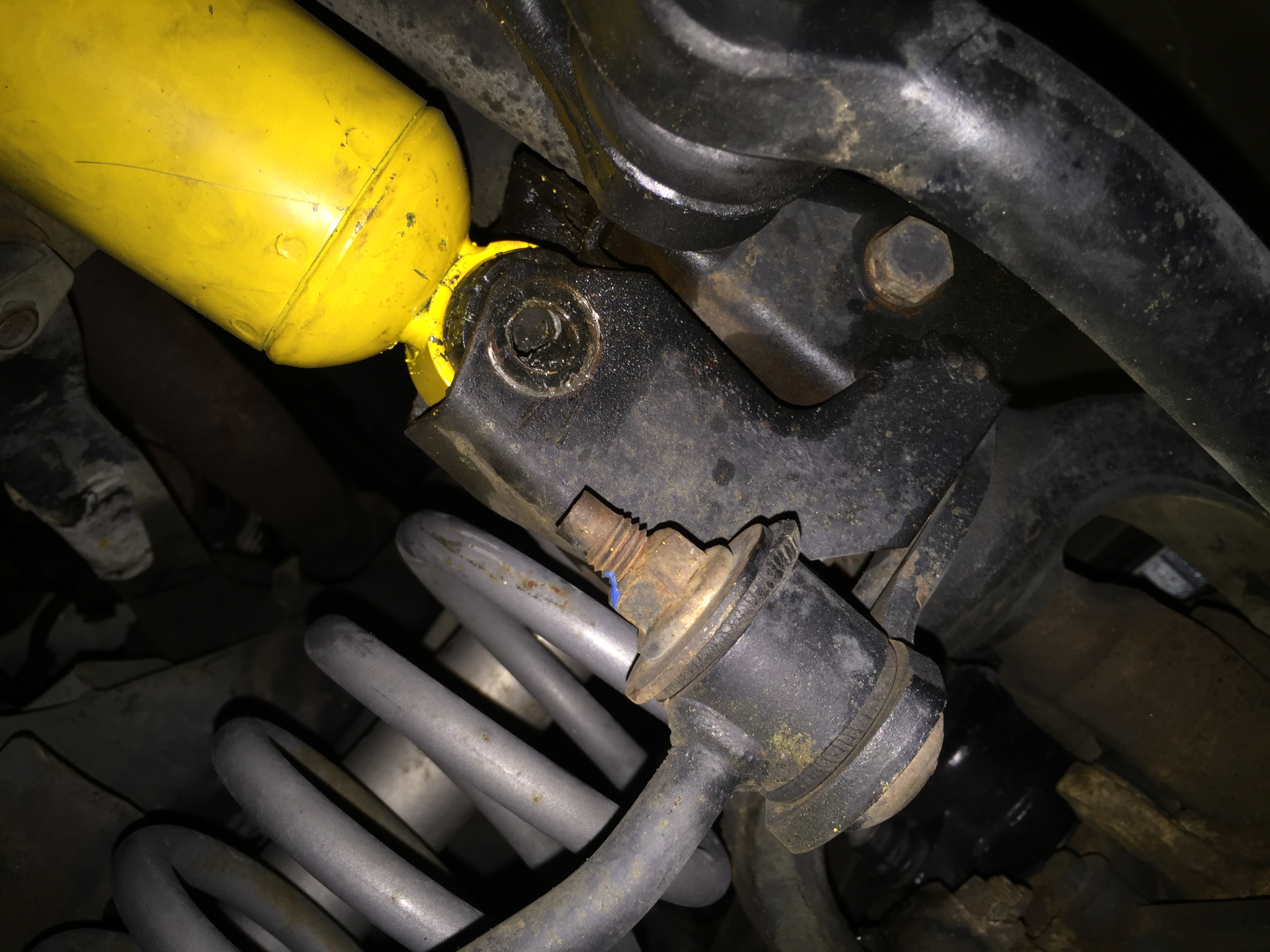

I got the stock one off, but I can't get the new end that connects to the frame to line up for the stock (reused) bolt. Any suggestion?

You could have someone turn the wheel to compress the stabilizer while you line up the bolt.
It looks like it just needs to go in further.

I just replaced mine in my TJ. Connect to the frame first. I moved the stabilizer up and down and pushed in at the same time. I used a rubber mallet for fine tuning. Once its connect to the frame, the drag link connection is easy. Hope this helps

Thanks I got it:)
