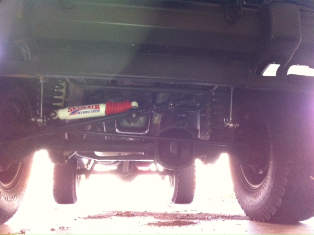

You don't need a drop pitman arm if the draglink and trackbar are close to parallel. Post a pic of the front suspension from the front.
Do you have any type of trackbar bracket on the front?

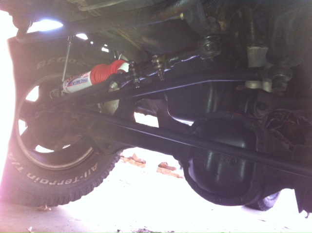

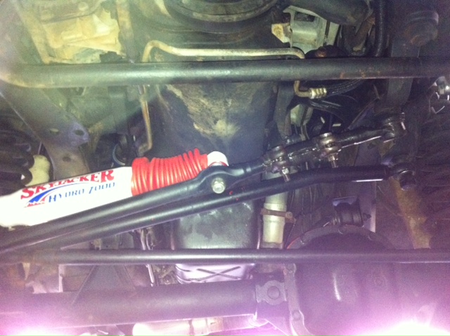

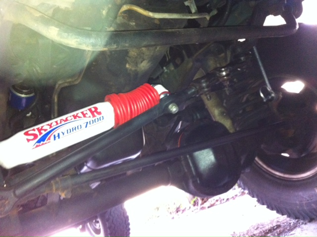

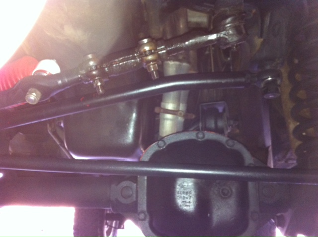

heres the pics of setup hope this helps.

A zj pitman arm should fix tgat up. It's about a 1 inch drop compared to tge Cherokee. That's what I used and I'm at 5.5 inches lift. My .02 cents.

It looks like you would benefit from a drop pitman arm, either aftermarket or a ZJ arm. The pitman arm end of the draglink needs to come down slightly in order for the draglink to be more parallel with the trackbar and reduce bumpsteer.
