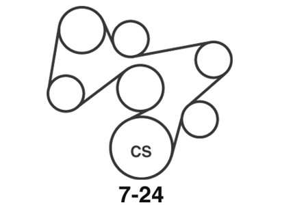

My 99 jeep doesnt have the sticker showing how my belt should be in dies anyone have a diagram?? The one in my Haynes manual doesn't match my jeep the idler pulley is on the other side

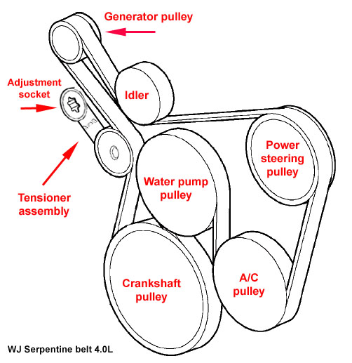

I just changed my belt on a 99 CG Laredo 4.0L i6 and it matches the diagram, we were even able to just push the idler down to get the belt on and off, the pulley was on the passenger side. My suggestion would be to try and adjust your idler and get the belt off no matter what side, just draw yourself a picture of how the belt is run before you take it off. Good luck

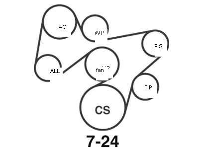

In that picture you are looking at the front of the engine, The tension pulley in the picture is on the right from the cs. Above that is the power steering pump.
