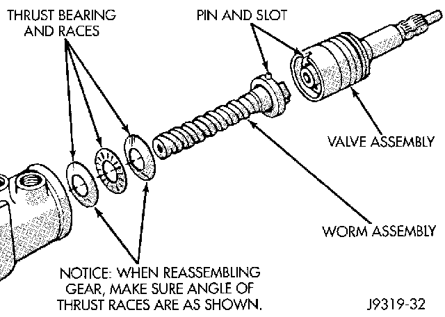

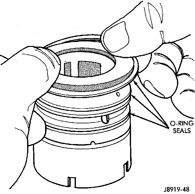

The easiest way is to remove the gear box off the Jeep and rebuild it on the bench. Napa or Carquest should be able to get the complete seal kit for your steering gear box. Make sure you mark and take note on the input shaft retainer position for re-assembly.
Thank you, Steelheadz ! After rebuilding my '39 Chevy gear-box it can't be too bad. I did hear that Lucas leak-stop was an option to try first. The diagram is great; thanks, again.
