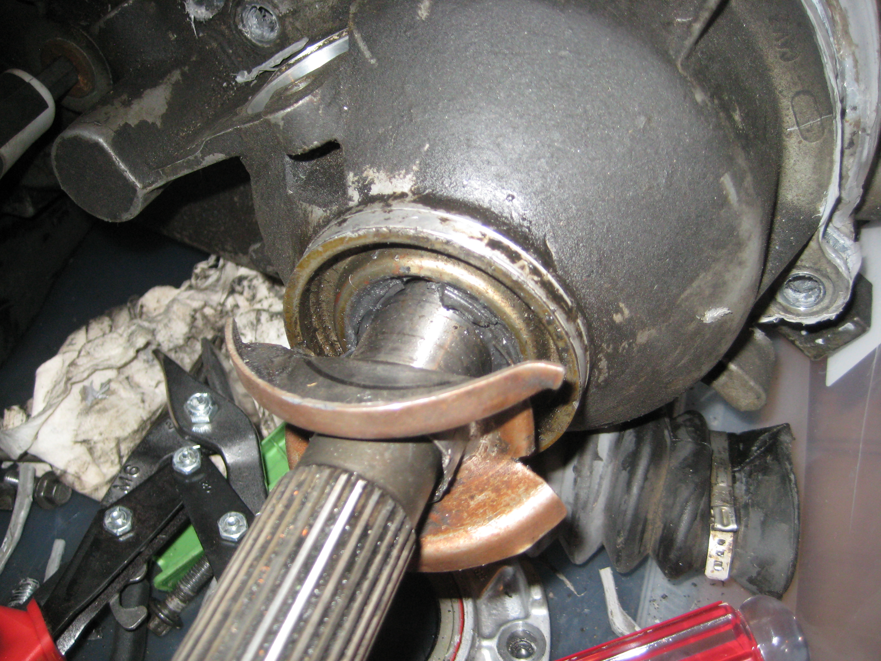

Managed to get the slip collar off and from reading online most articles say that there should be a few snap rings behind it, however, I'm faced with some other sort of press-fit looking POS :-) In the attached pic it's right behind the bent up collar.
Does anyone know how to get this off? Seems as though its fused to the case.
Or maybe a better question is. What would be the next thing you would do?

Next is the output seal, pry it off by tapping a flat-head screwdriver between the outer edge of the seal and the aluminum housing. Behind that will be a lock ring, you'll need special lock-ring pliers for those, they have knurled tips that look like a duck's bill.
Thanks everyone. Got this POS apart :-) All the articles weren't joking when they said "Buy a good set of snap ring pliers"
