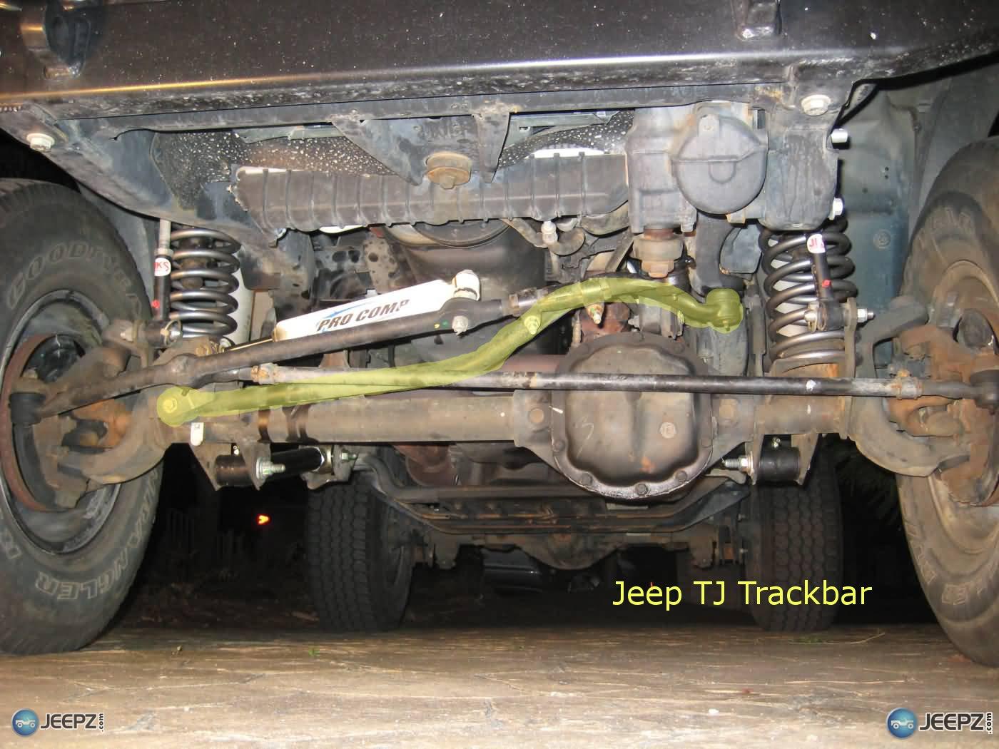

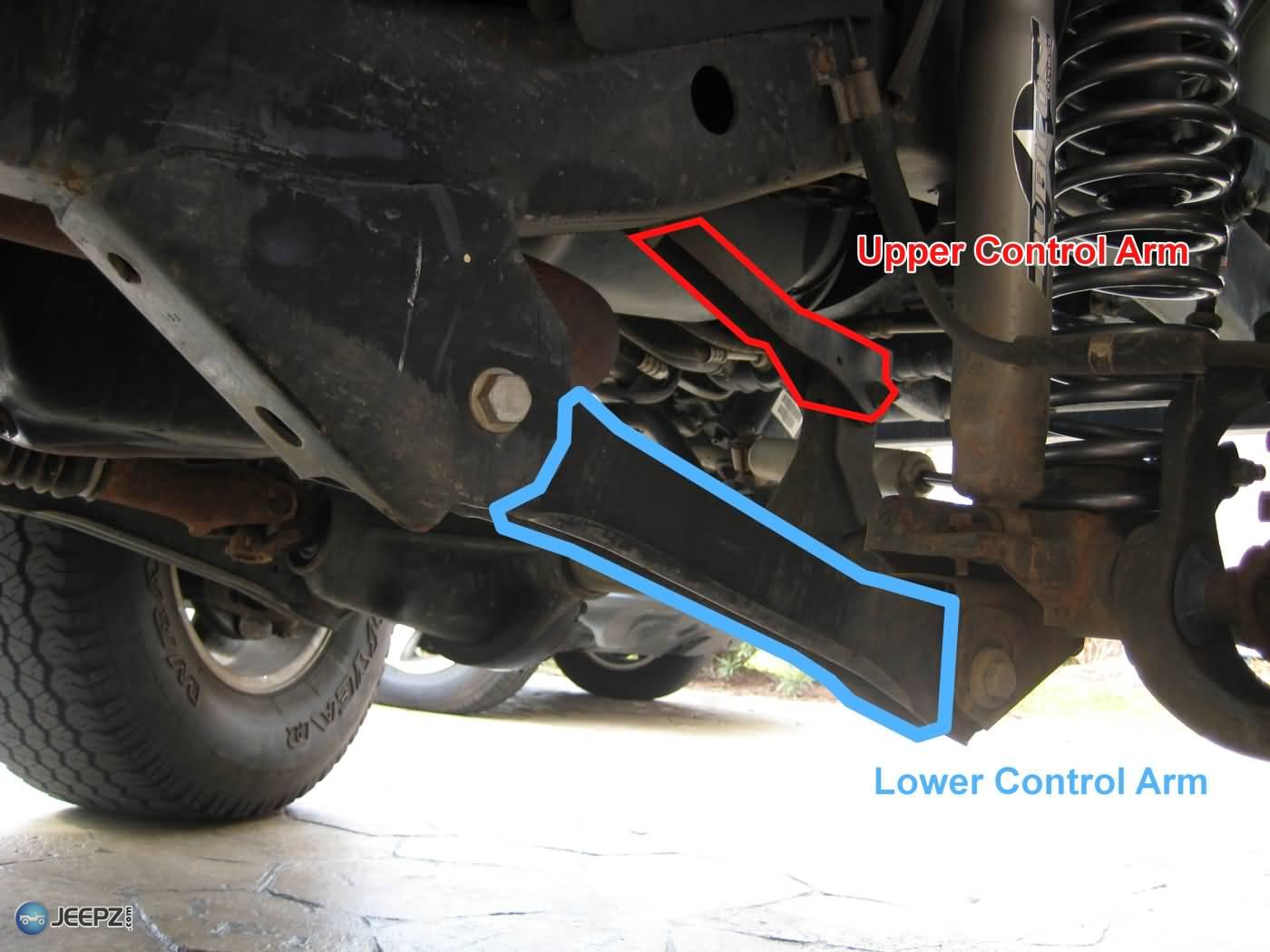

I think that Ggg is right on the money, you'll at least need trackbars, swaybar links, and lower control arms.
