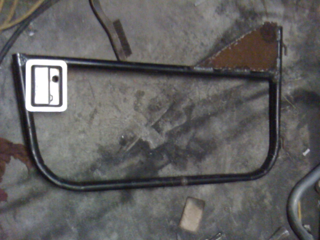

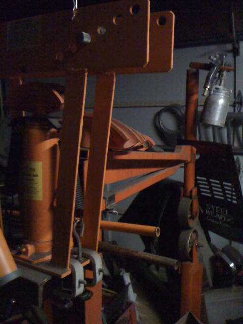

I'll take some pics this weekend in the shop. What i want the end result to be is having an open tube door that latches , has the option of having a detachable aluminum diamond plate skin and is able to accept a TJ upper door window when needed. I have layed it all in the door jamb of my CJ for fitting and it will work, i just havent finished the mount for the windows and the latch. BTW, you will need a pipe bender as well for this project. I have a 12ton pipe bender that works well with the correct size die.
That'll do the trick. That's the same setup i have in my shop. I mounted it on the main base of my english wheel since it takes 4 bubba's to move it due to it's weight.

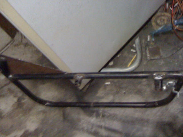

Here's the unfinished tube doors. After i finish the door latch mechanism, the center support tube will be welded in place and then finish the upper door window mount. The last thing to do is to cut out a diamond aluminum plate for the door that's removable during the summer.

Looks pretty good, are you only adding one support bar?
Thanks. I'll most likely make a cross support bar on the center and plasma cut a skull in the middle with a steel plate that will also be part of the gusset.
