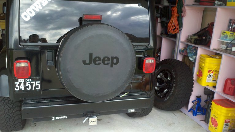

After rebalancing and rotating the tires the other day I got a vibration around 50-55.
I watched the tech balance all the tires to "0". So the tire is balanced perfect but still is out of balance.
I've came to the conclusion the tire either has a busted belt or is out of round.
I've had this tire on the jeep 3 times now and taken it back off after a few hundred miles each time. I always figured the tech got lazy on one wheel and didn't get it completely balanced, but this time I watched him closely....
I put it back on the tailgate, I'll see if I can get it replaced.

Isn't it pretty? My $250 tailgate decoration!
Took the tire that I've been having trouble balancing to get looked at.
So it appears that I've got a bent rim :( not sure how, its been a spare its whole life. Must have been bent when I got it. I'm going to see if I can get it warrantied, I think I'm outside the warranty period.

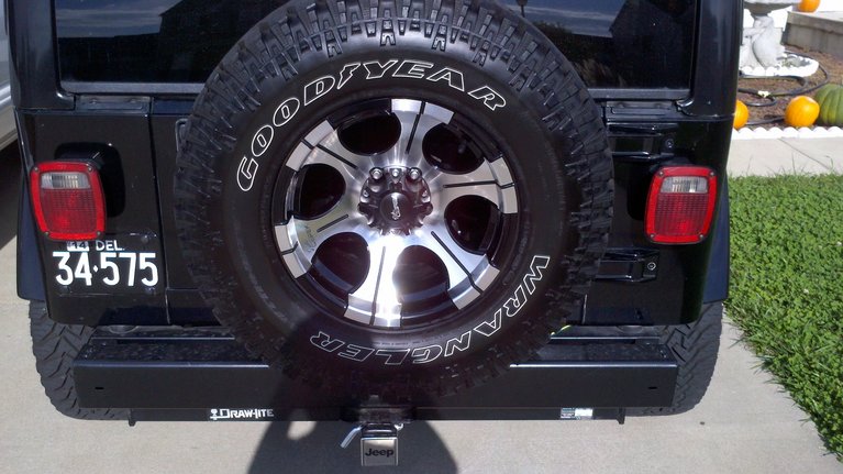

Put the stock spare back on so I can return the bent wheel... I knew I saved all the old junk for a reason

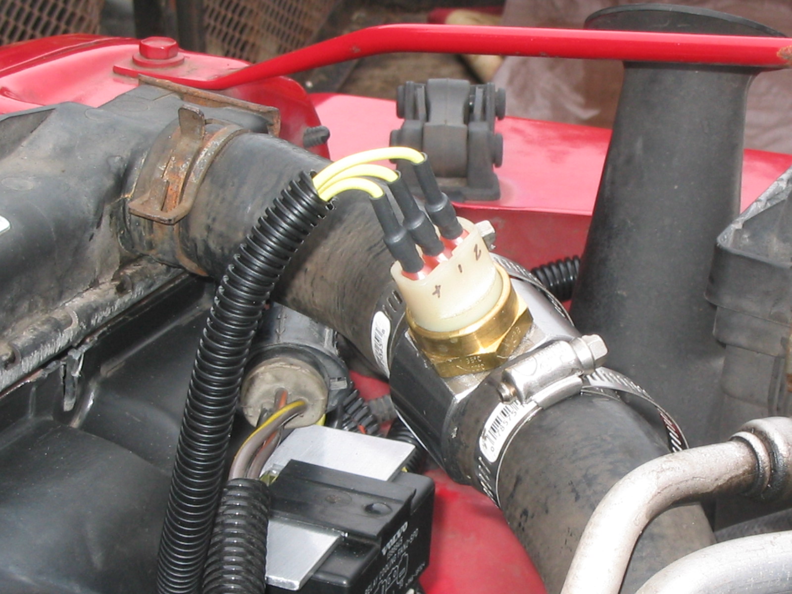

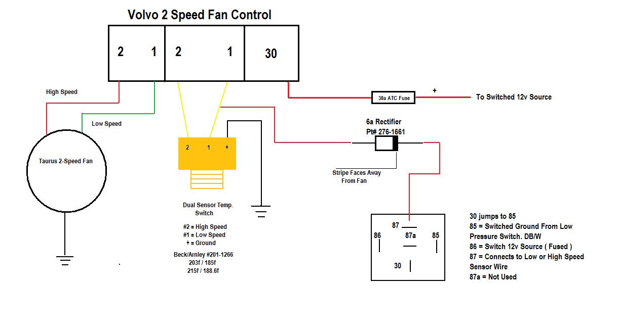

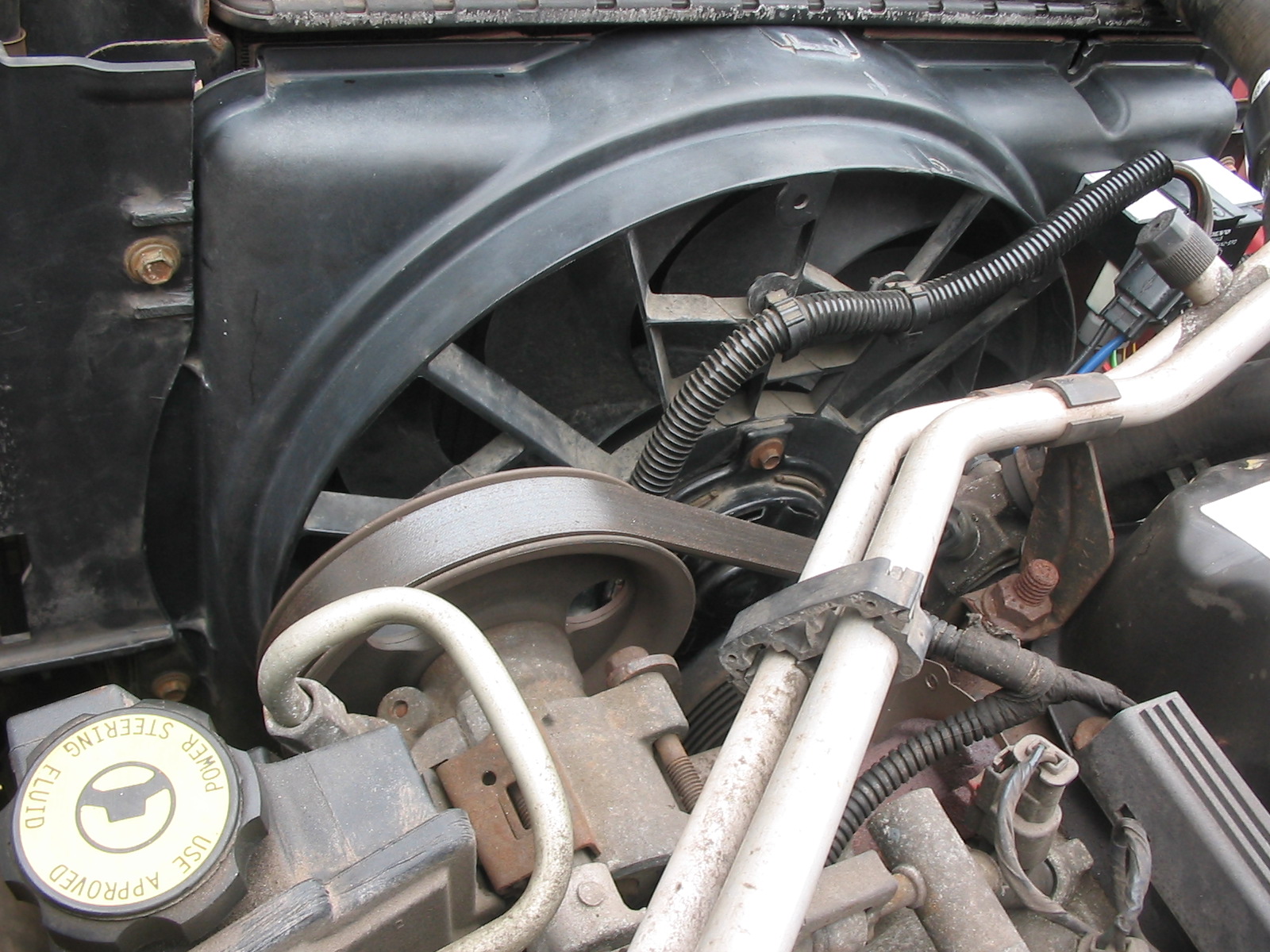

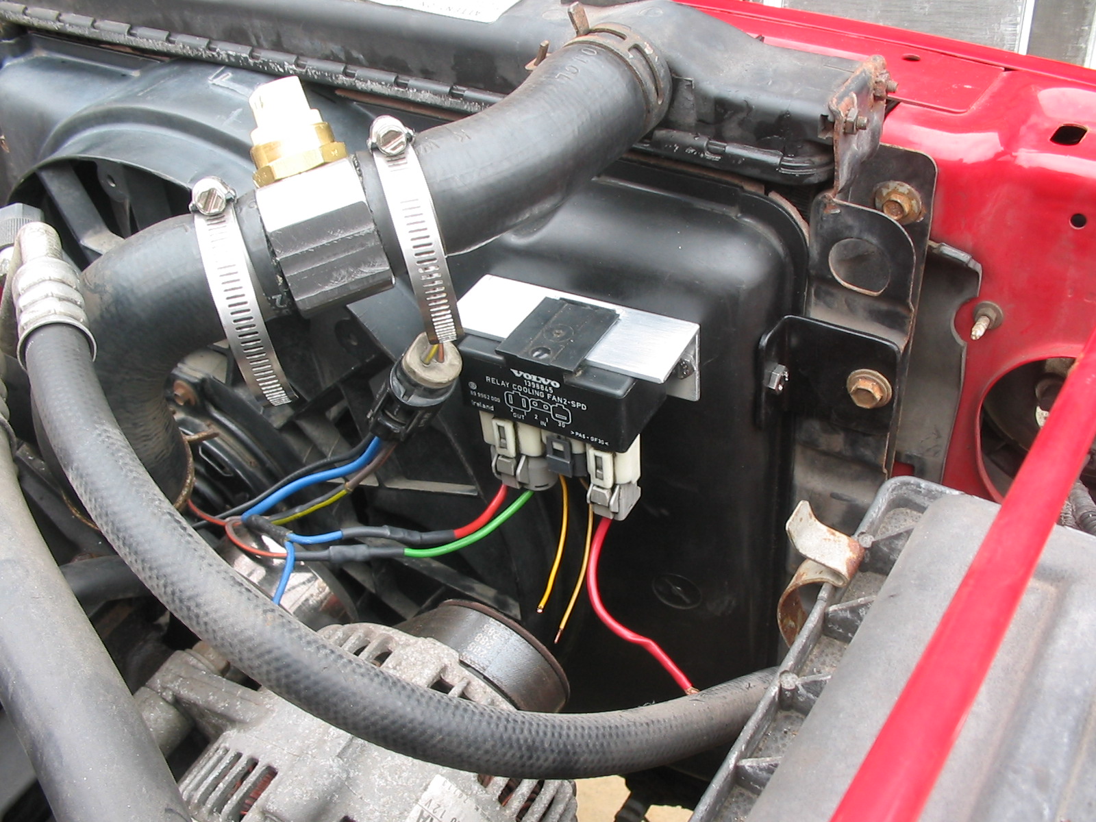

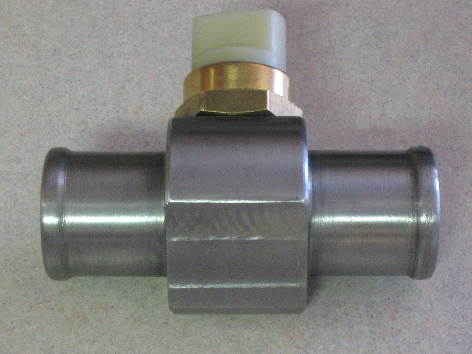

Finished installing a Ford Taurus 2-speed fan and tying it in with the factory Wrangler A/C....
I've included the wiring diagram to help those who have A/C...
