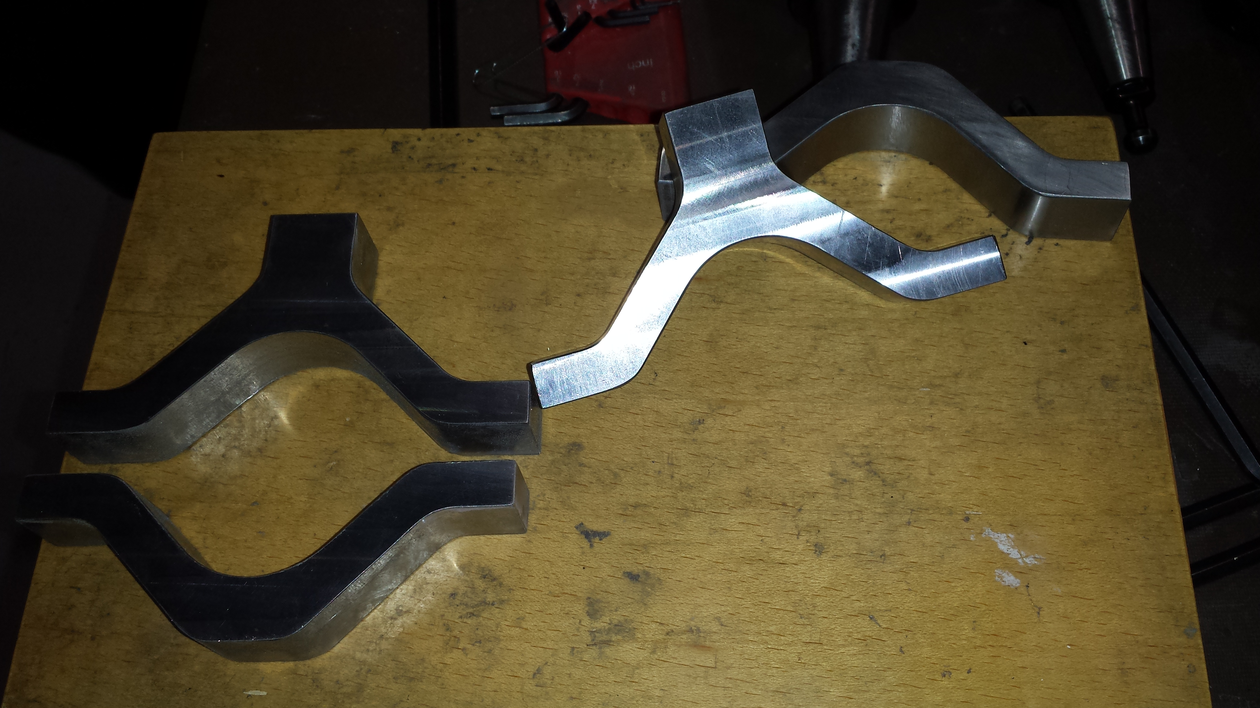

Another bored machinist project. Made some roll bar clamps for the high lift jack.

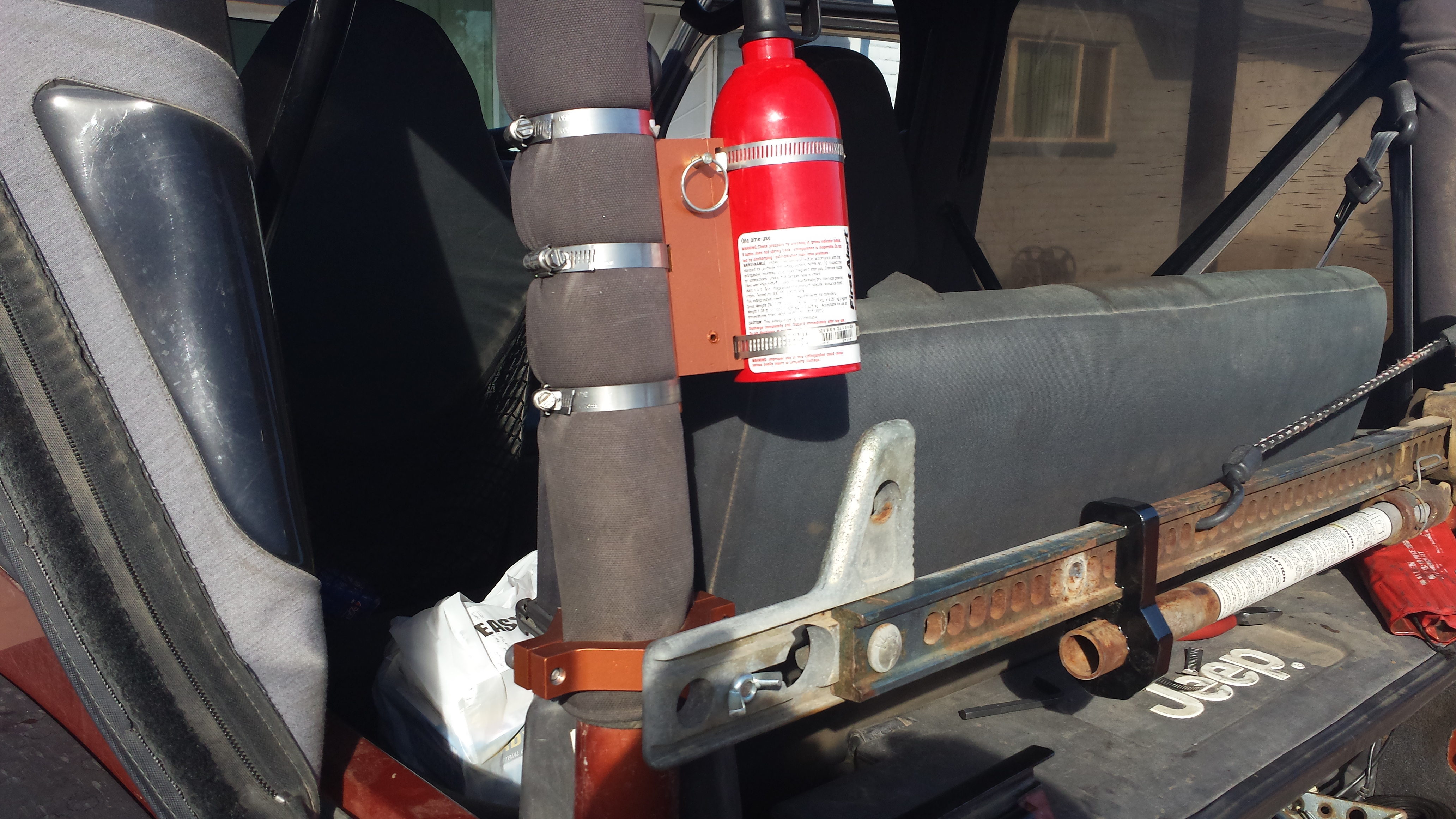

Mounted the jack and the quick pull fire extinguisher.

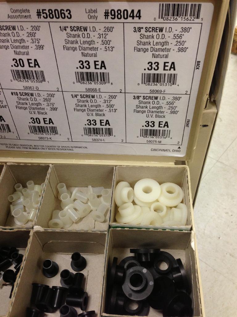

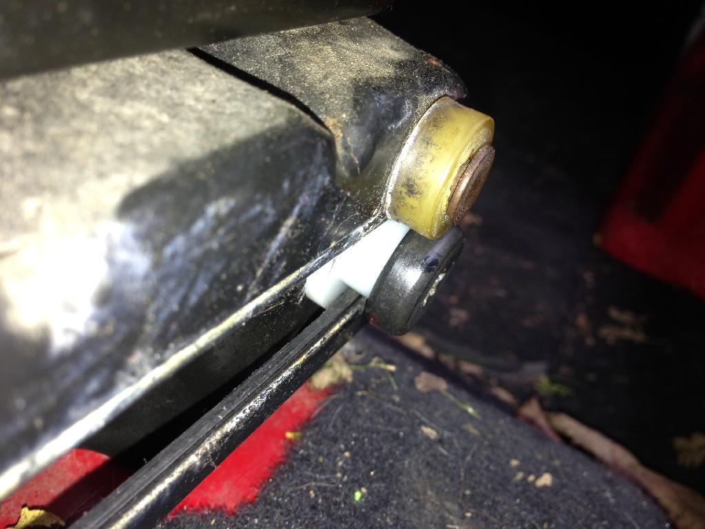

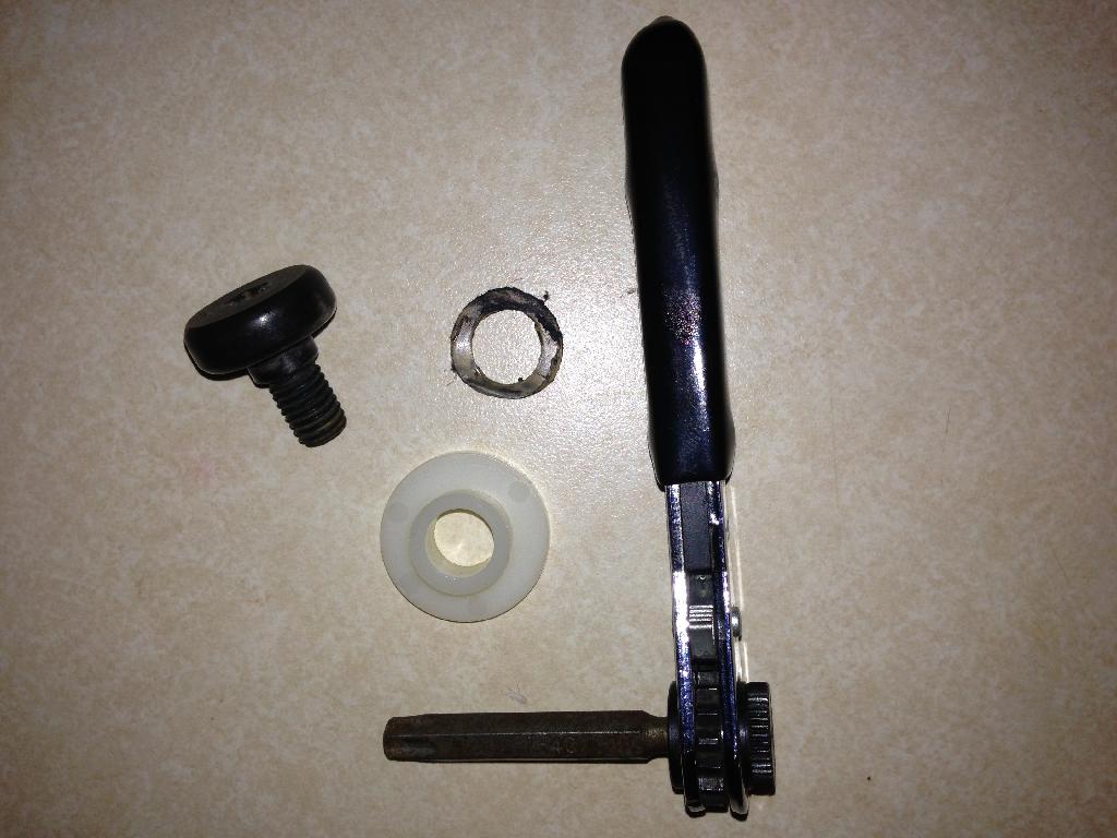

In the third pic there is a bolt under the bushing you replaced. That bolt has another bushing that allows the seat to glide forward. When it goes, the seat doesn't glide so easy and the seat will rock back and forth. I could not find a replacement so, I stacked up 4-5 Teflon washers to replace . It lasted a few years and need to be replaced.
Where did you get the bushing you used?
So this only lasted a year or two. Here is what I replaced it with now.
