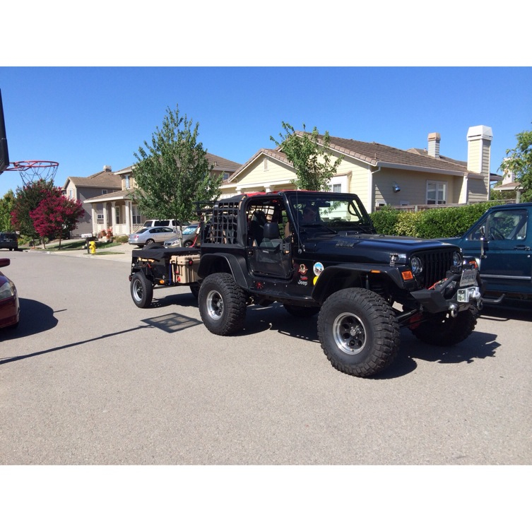

Took the hard top off, hooked up the trailer and went for a ride.

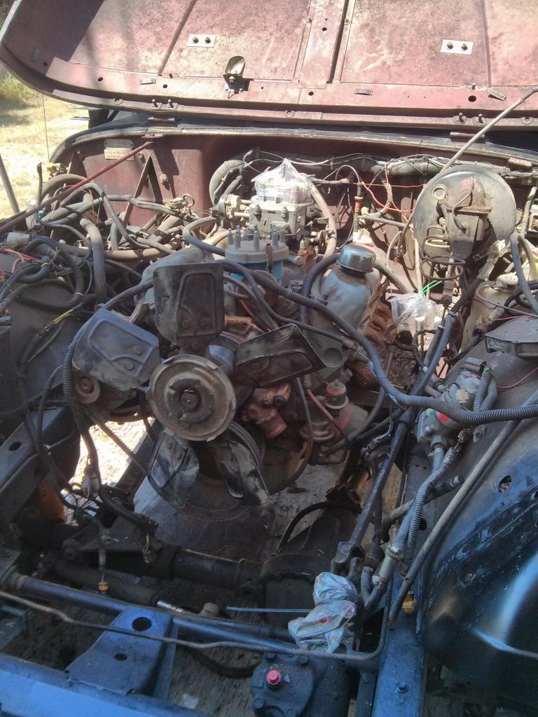

I am sure enjoying my 79 CJ7 after rebuilding the motorcraft 2150 carburator, replacing stock distributor with a HEI distributor, which also rid the old ignition module and coil. Replaced the plugs and wires, oil, oil filter and air filter...took most of the weekend and today! It runs great!

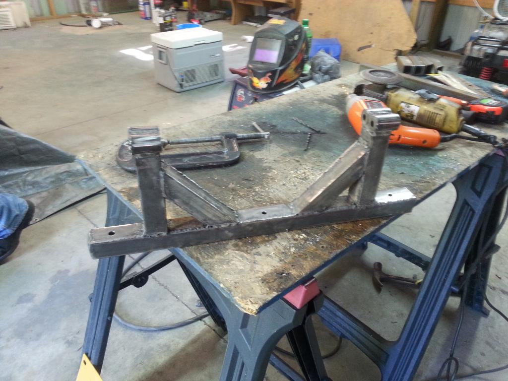

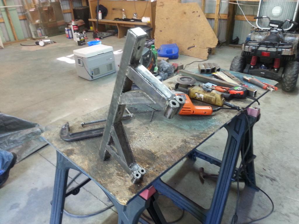

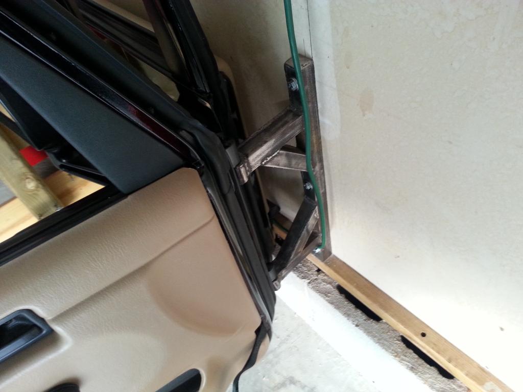

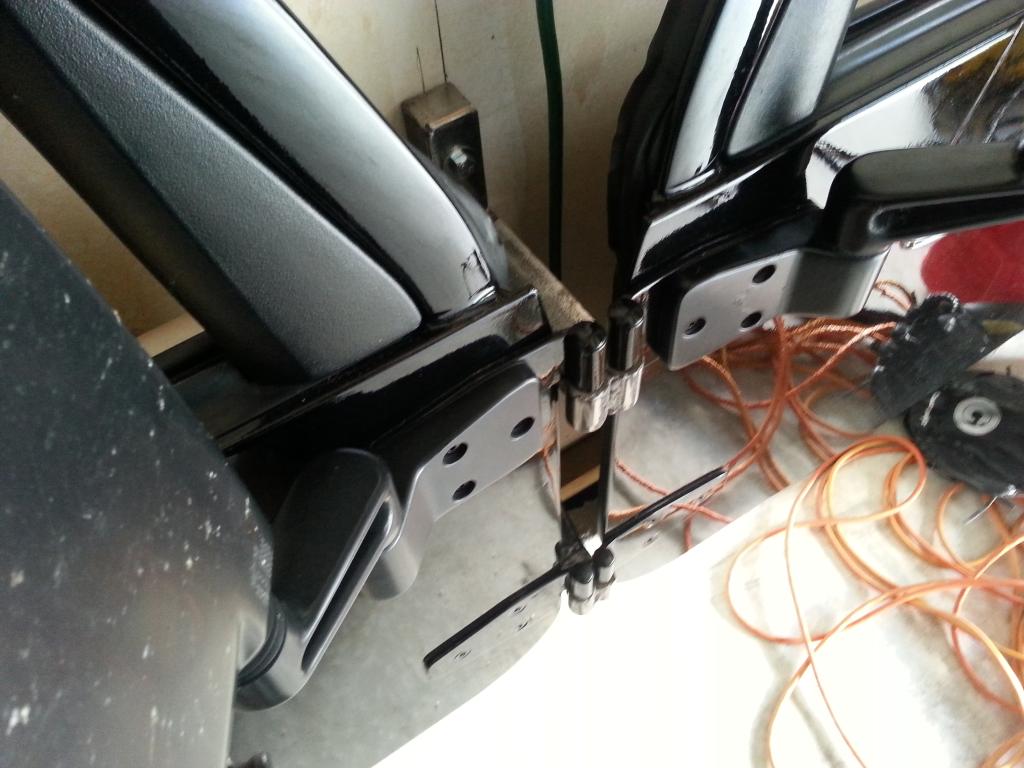

Made some door hanger brackets (total cost $2.50 for washers and lags)
I got some 1" angle iron (for free) and welded them into a box, cut everything up, my brother-in-law had some old wrist pins laying around so we welded them together, cut them in in half and welded a washer to the top for the hinge pins.
Welded everything together
and came up with this

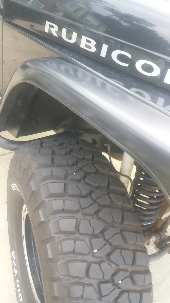

Finally got around to trimming the factory flares down, took an 1.25" off them and finished the edges with door edge molding.

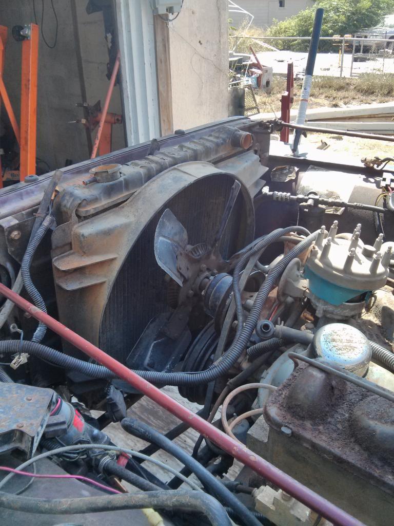

Installed a new radiator. Even with the trip to Autozone for a new hose, it took less than an hour. Parts: Rad, $200. Hose, $10.00. Time, 45 min +-. So while my CJ was in the shop getting a rebuilt carburetor, the mechanics were "nice" enough to quote me a price for a new radiator. Someone please explain to me why they thought I would pay $900 for them to replace a $200 part that takes less than an hour to install? I'm glad that most things that need to be done to an old jeep can be done with basic tools in the comfort of my own garage.
