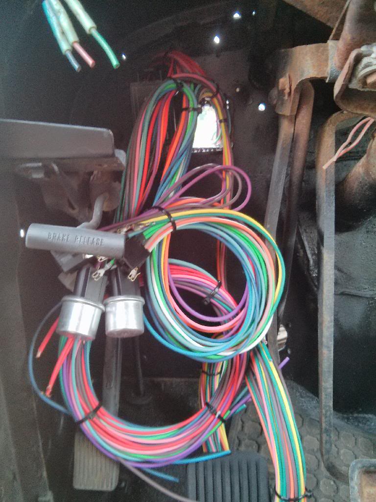

Here is the under dash shot when I first started laying wires in. The two bundles there are the dash and interior. This kit came with wires for power options so I won't be using those.
I decided to reuse the old fuse block as an insulator to keep anything from rubbing and getting cut or rubbed through. I have that black wire loom covering, I just wanted to string everything before putting it on.

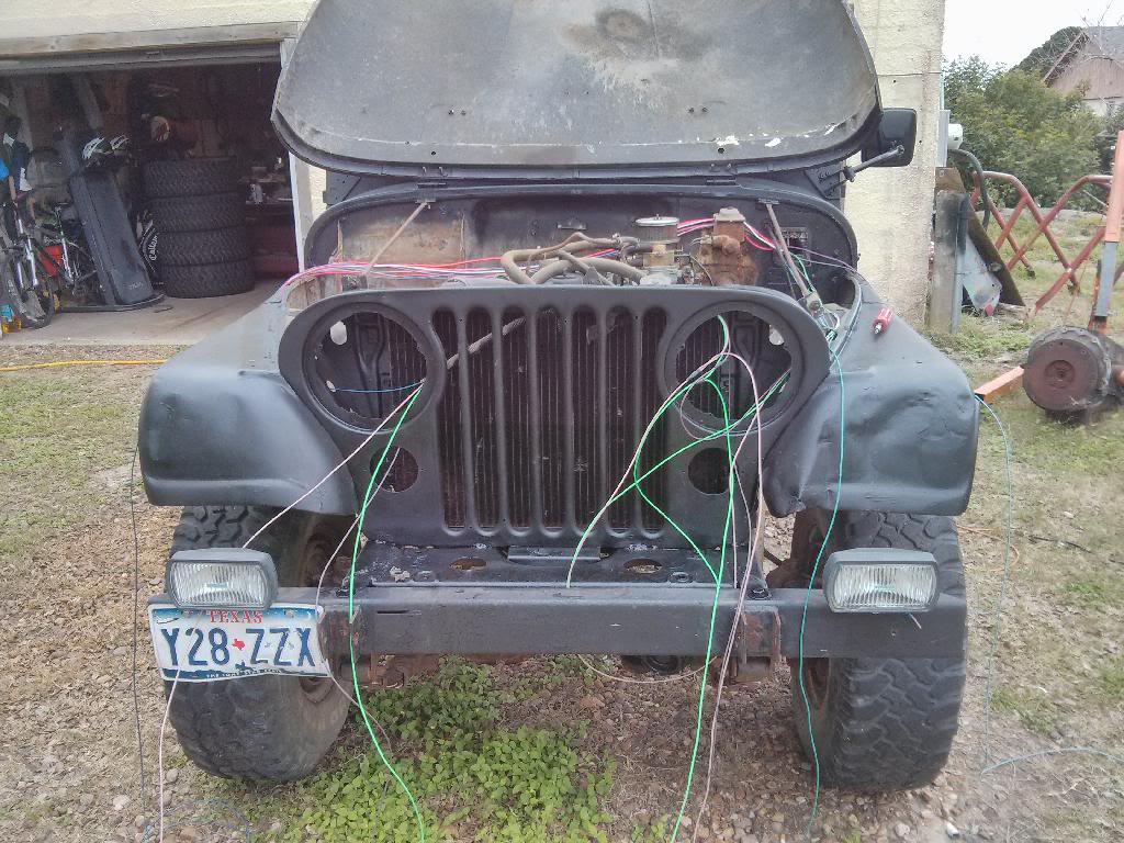

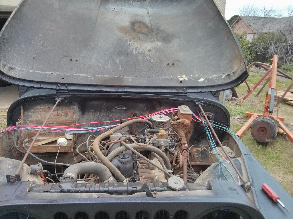

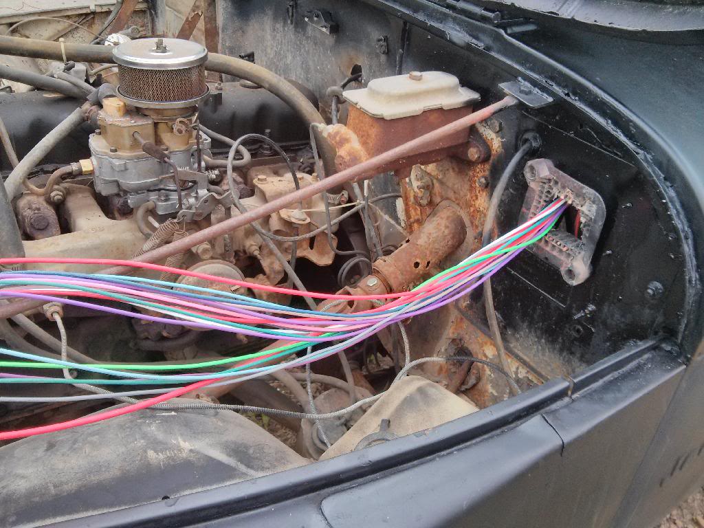

Lights and horn to the front, engine related stuff along the firewall
Another shot of where stuff goes

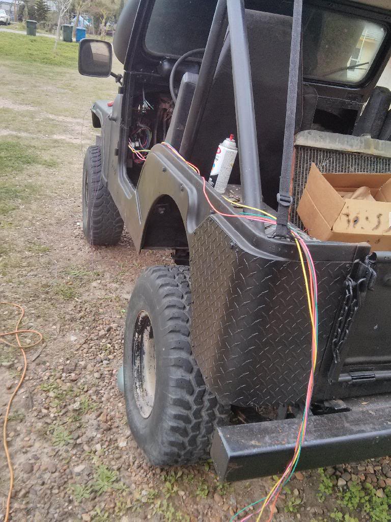

Back end stuff like lights and fuel sender
