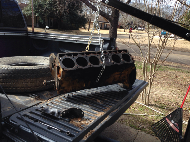

So, still working on getting this block to the machine shop this week. Got the distributed out, lifters, and cam pulled. I think I I've got as far as I can go without getting the engine out. Pistons and crank are all that's left. Quick question, can I just remove the crank before the pistons? Just so I can pull the pistons out of the bottom and won't have to hone the top of my cylinders and let the machine shop worry about it.
The machine shop I brought It to today gave me a comforting feeling. I think those guys will be able to get me on the right track. I pulled the engine and got it to a bare block in the back of my buddy's truck. Dropped it off and got prices.

So, got the call from the machine shop. The engine has been worked over before. Boring cylinders .060. Just ordered the master rebuild kit from northern auto and got the 68-201-4 comp cam. Done a quick google search before completing my order and found a promo code of "ve10off" which gave me 10% off.

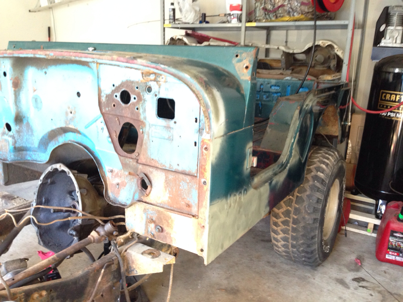

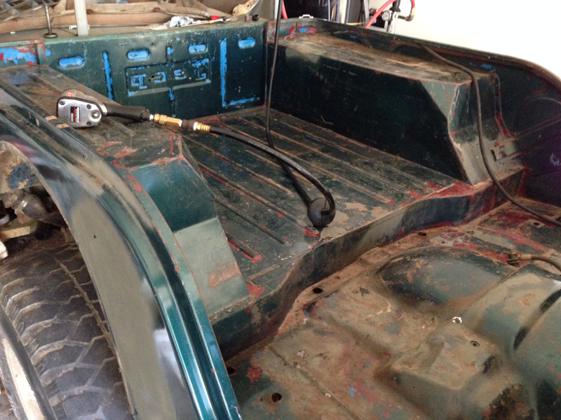

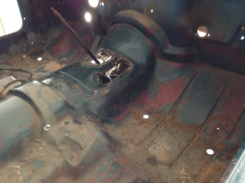

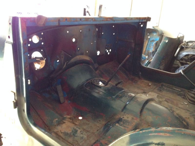

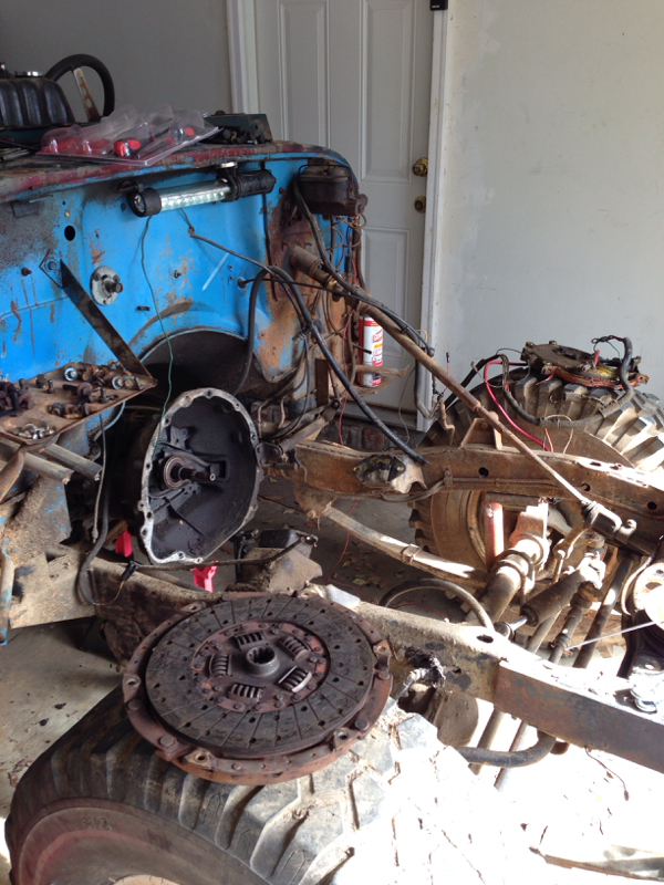

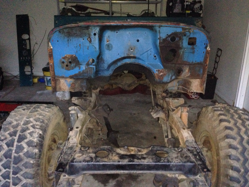

Can't wait for the rebuild kit to get here. Tuesday....Tuesday. For the mean time I have been preparing the body to get it off of the frame. The dash is off, the transmission is out, and I got all the stuff out of the back. I started taking the body bolts out but a few are spinning with the fasteners.

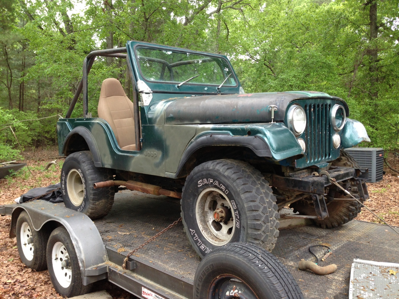

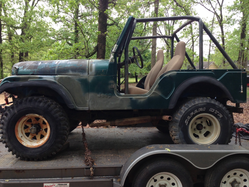

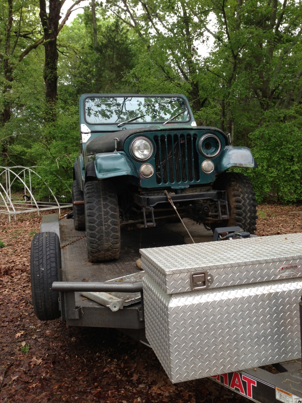

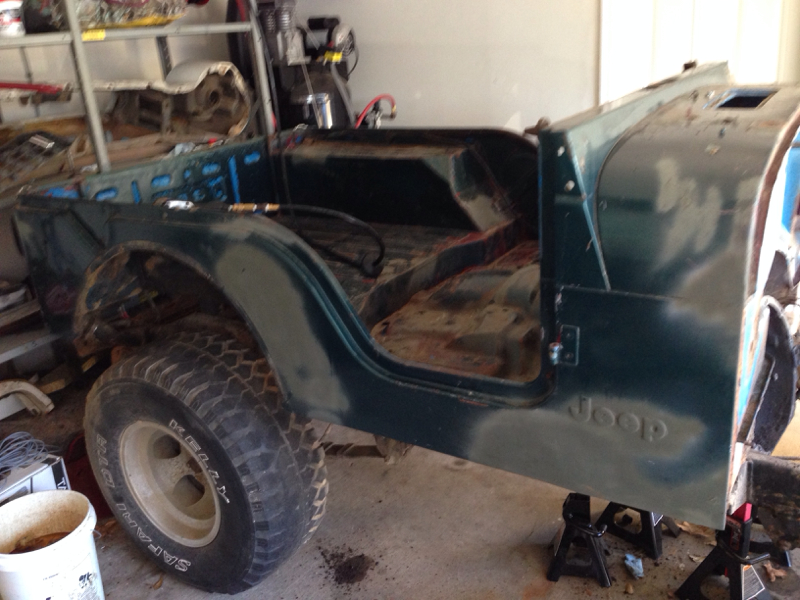

And before I forget. This was it when I bought it. Motor locked up and out in the weather for no telling how long.

I really have to say , for $600 , the jeep basically looks sound . There is a minimal amount of rust that should be easy to deal with (surface rust ). One or two attempts by the previous owner to repair rot but for that price , you could not get an entire body tub and you got an entire jeep ! Right place at the right time. Soon , we'll see the body off then time to deal with the rolling chassis . To me , this is a realistic project that is commonly found in this condition but the price was even better . It's rare you find a solid jeep in running shape that you can score for well less than a five digit figure. Thanks for the pictures , they really give us a good perspective at how your jeep will look soon when your project is complete . Doing a great job.
The original color was "brillant blue". I will be going back with that. I'm taking the body lift off and if I can't find another pair of the wheels that are on back then I'll go with a new set. I need some seat frames for those tan bestop seats. They are in decent shape so I think I'll hold on to them. And you're right about the previous owner's patchwork. I'll take the advice of my body guy about it. Not sure about the bumpers just yet. Not too excited about tube bumpers but I will just have to shop around. That should give everyone a general idea of where this project is headed.
