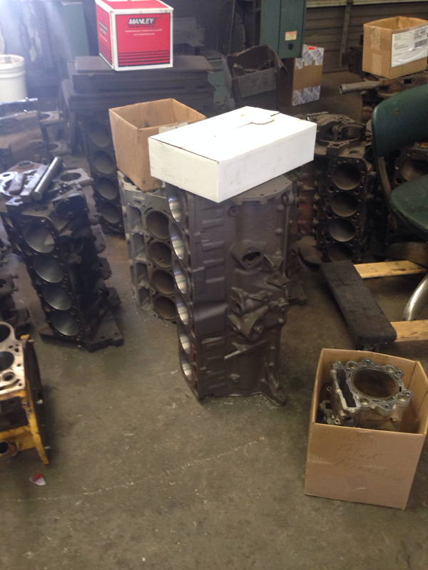

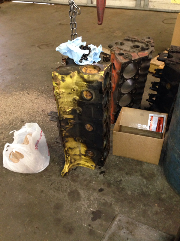

Because I am paranoid about messing up the clearances on my rods and crank, the machine shop is going to help me assemble the bottom end of my engine. Before and after pictures of the block.

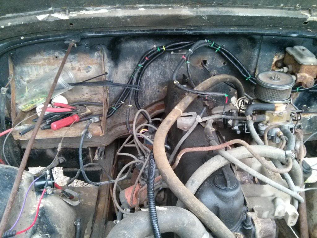

How does mine look? Front end is wired up and so is engine
Only wire left is the temp sender and everything forward of the firewall is wired in
A hard top and full metal cj5,doors just showed up for 300 bucks about 5 minutes down the road from my house. I am going to check it out tomorrow How does mine look? Front end is wired up and so is engine http://s25.photobucket.com/user/bus...oads/IMG_20140329_183959_zpso8zuwjua.jpg.html http://s25.photobucket.com/user/bus...oads/IMG_20140329_184013_zps9koq3jut.jpg.html Only wire left is the temp sender and everything forward of the firewall is wired in
Looks Good! Have you crunch it up after wiring the engine?
no, still have to do the tail lights, and dash stuff. i meant to do it sunday but just didn't get to it. i almost just dropped a battery in and jumped the start wires just to hear it run again but didn't
