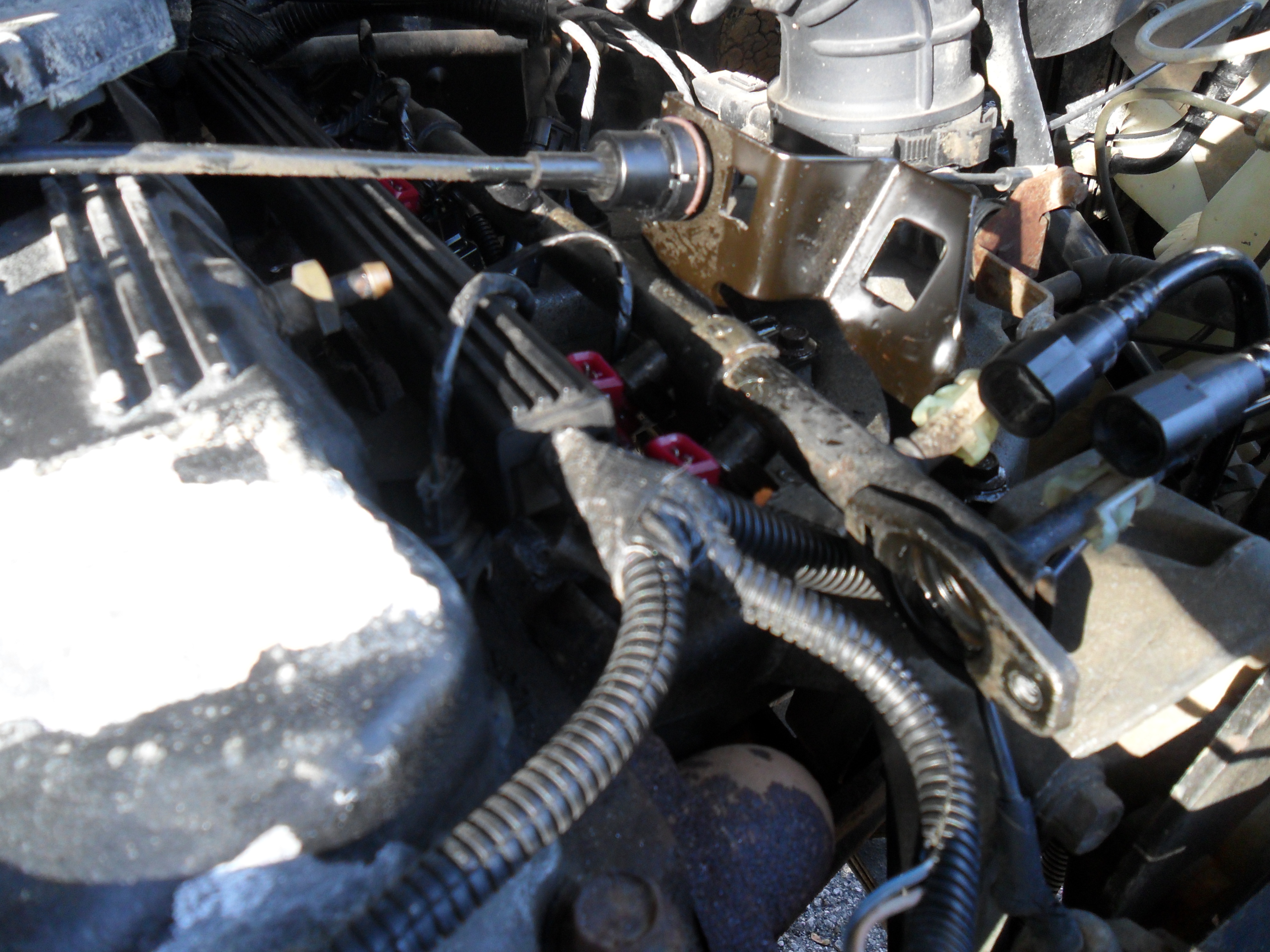

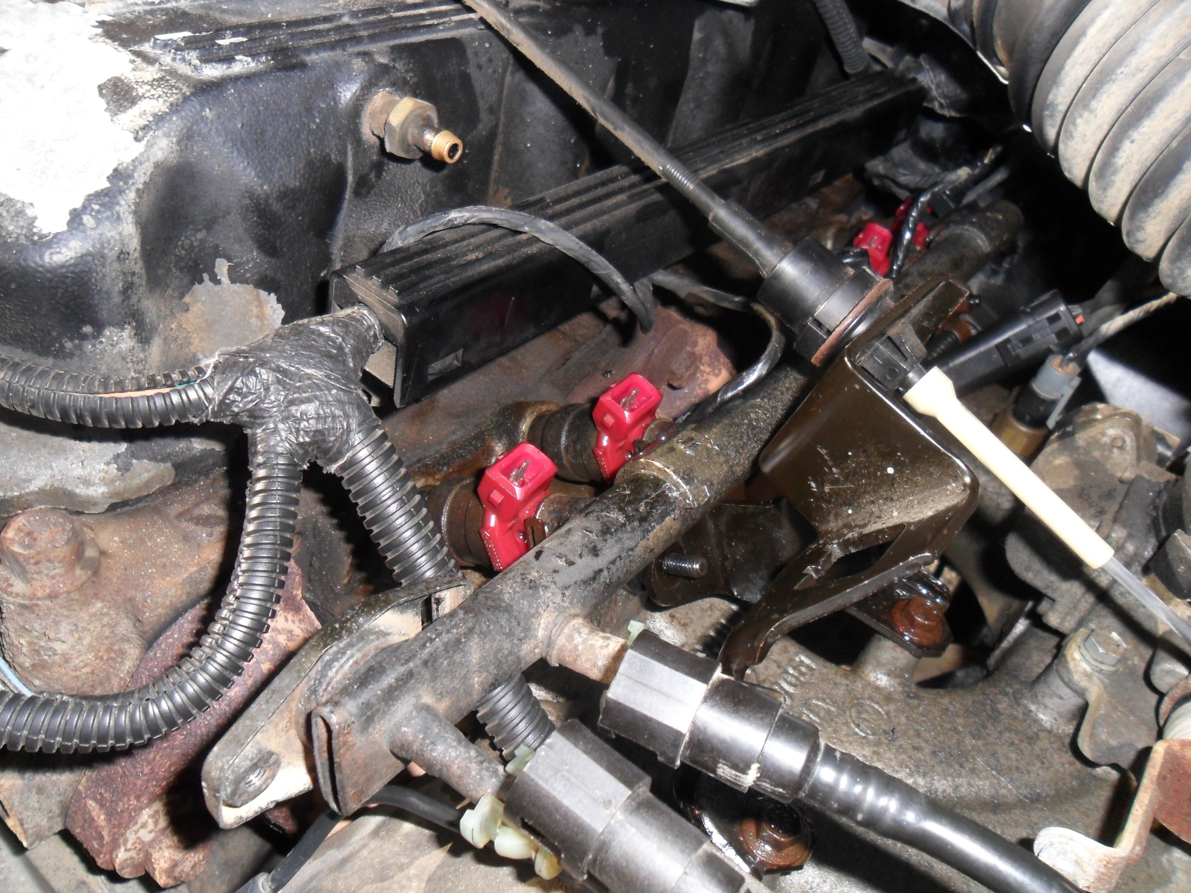

couple days go by and i still cant get the damn thing off. here are 2 pics. might not help at all but idk what im doing wrong.
Undo the throttle cable and try again.
