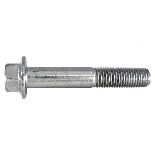

Number of new tight fitting bolts.
Shocks and track bar grade 8 metric 12m 1.75 thread. I believe.
I have to say that relocation bracket was a bear. Likely spent 3 hours fitting it on and getting the new TB in there.
Need to go back and trim some bolts cause i made sure the bushings ride mostly on the bolt shaft and not threads. Little to no slop.
